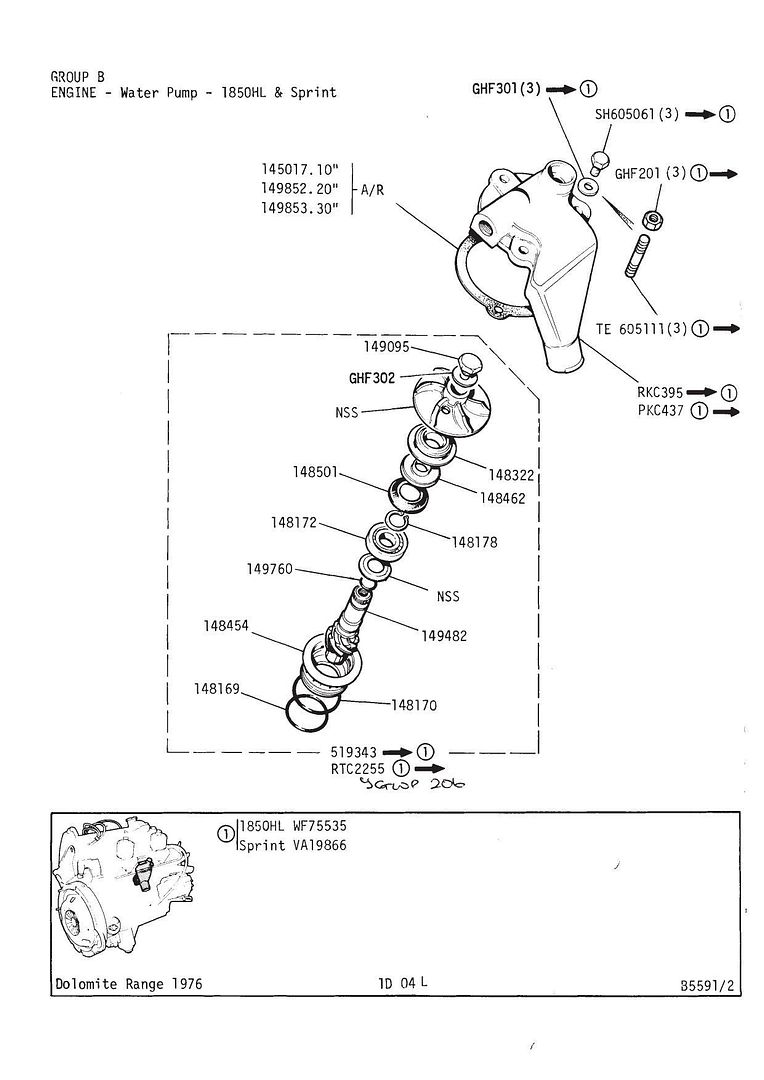

Ok Guys, Bruce came round today and has pinpointed the noise to top of water pump by listening using a screwdriver, Also spotted some oil seepage in that area so also possibly head gasket, Head seems to be torqued down ok, so it's water pump area. it's definitely quieter over the other side of engine and bottom end. Any other ideas on possible problems between cylinders 1 & 2? Have started the strip down and got as far as the water pump impeller but haven't got a spanner that fits does anyone know the size of the nut?
Cheers Rich
1981 Dolomite 1500 Auto
Re: 1850 gremlins
#37 Post by Toledo Man »
THIS might be of help to you. It was also reproduced in the "members only" section. One thing to be aware of is the bypass tube from the manifold to the water pump. This can leak once it has been disturbed. I must've got lucky with mine when I did an inlet manifold swap back in 2008. If you're careful it should be fine.

Help required chaps! When the water pump cover is off, if you grab the impellor and try to rotate I back and forth, should it feel notchy?
I appreciate some backlash should be there, but notchiness?
The pump comes out cleanly, and appears to have been put together with too thin a gasket.

Is this of any help Bruce?
I hope the jackshaft isn't the problem...
