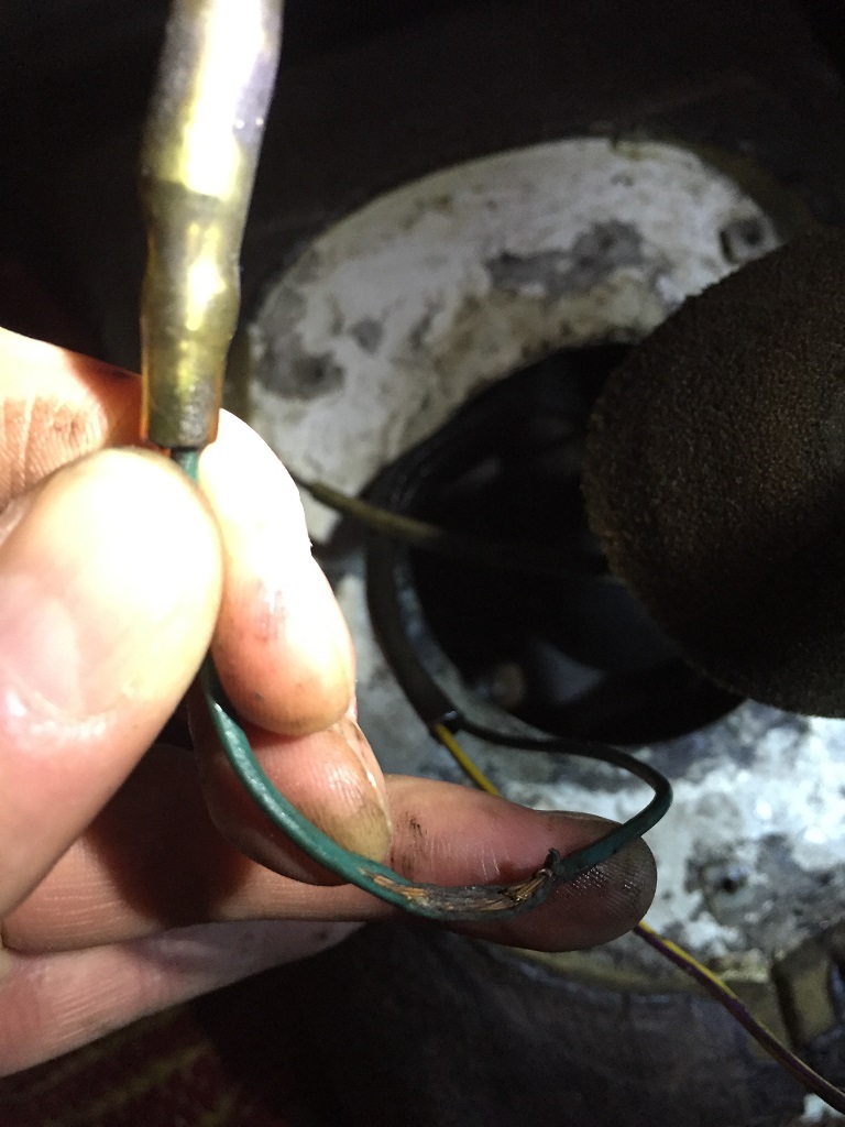

Resolution!
So, my new wires arrived and I removed the entire gear stick housing and carpet so I can follow where the cables go. Turns out the cables were completely severed and disconnected... Jonners was right, the wires were clearly ripped by being caught in the mechanics or something.
So, I replaced the new wires, reconnected them and put everything back together. Replaced a fuse with a new one and all is now working perfectly. I'm absolutely delighted!
Owning this car has taught me so much and this forums advice and enthusiasm has been a a real benefit. Thank you everyone!
Here are some pics of the wires..

Re: Fuse blows when using overdrive
Manipulating the new cable up the gear stick is an acquired skill....
Sadly there remains the possibility of it happening again so take care to route the cable though the bellows ob the right side
and make sure the belows itself is held at the base with the clamping ring and screws. Not always easy to get in place...
It all gets a bit gungy after time...
Make sure the clips that hold the gearbox loom are all in place too. Every little thing helps....
