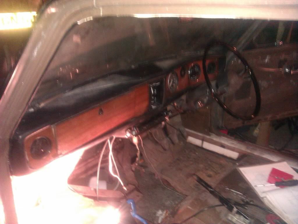

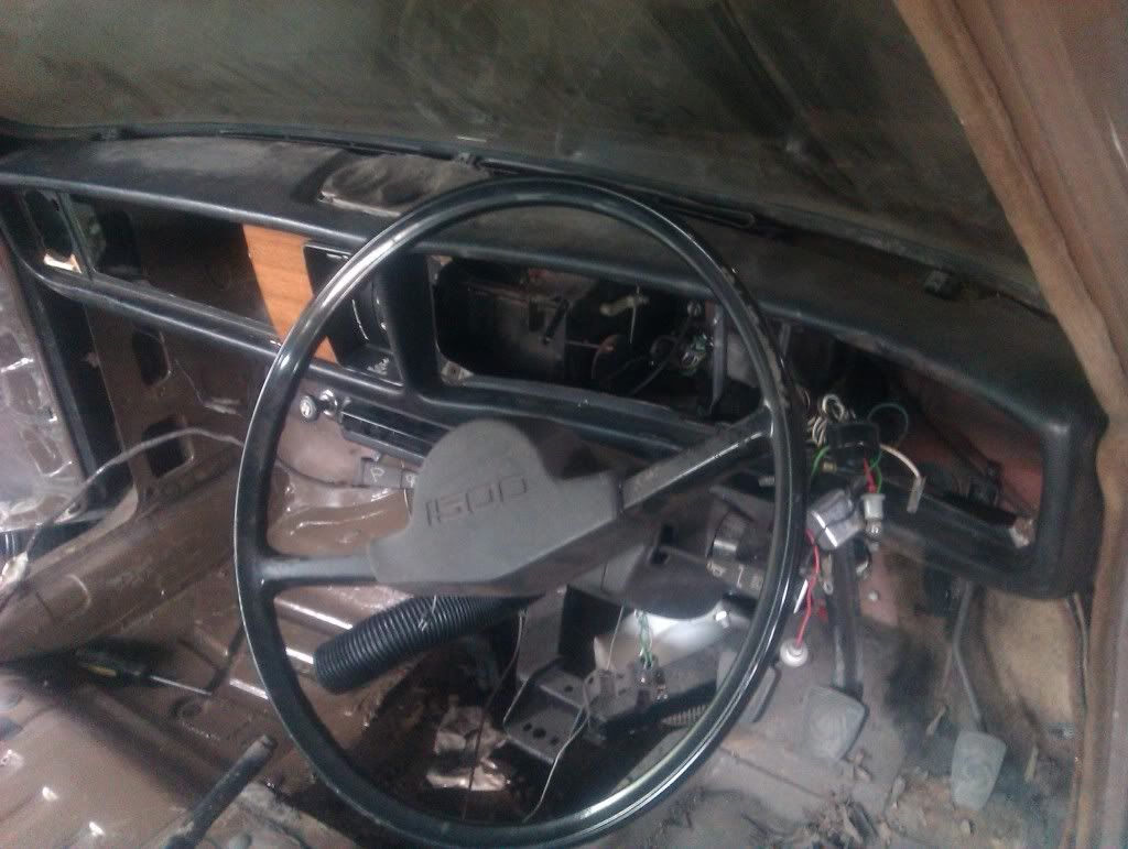

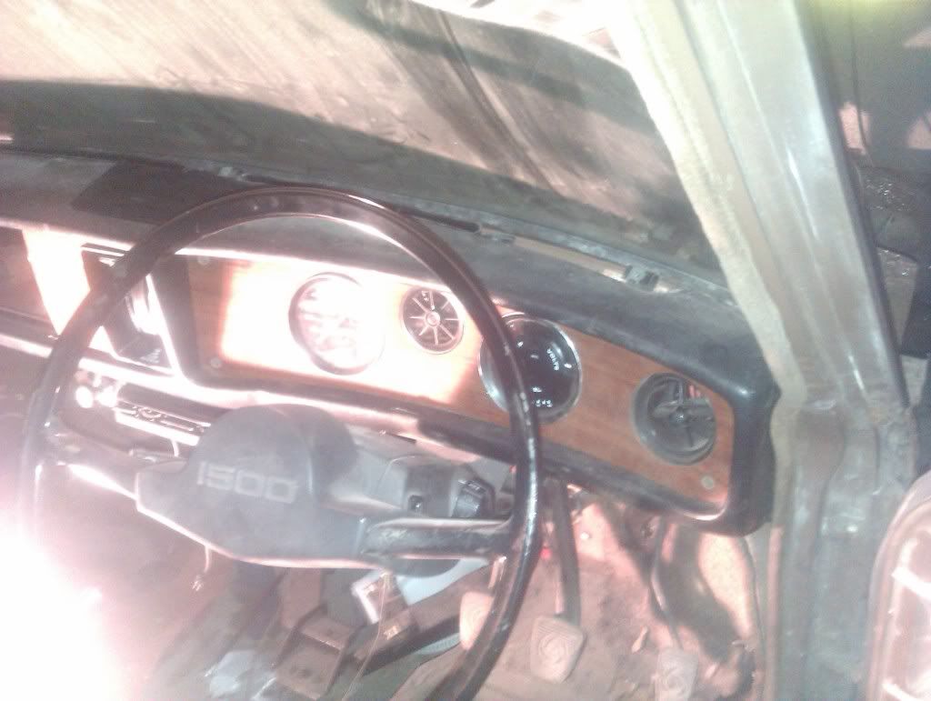

Physical Installation of the Sculptured Dolomite Dashboard
When I substituted the Dolomite adjustable steering column in 1982, I discovered that there was a space between the mounting brackets and the front bulkhead below the windscreen, owing to differences between the Toledo’s flat-panel dashboard and the Dolomite’s contoured dashboard with separate curved-profile instrument panel. Hence it was necessary to incorporate spacer shims. The mounting brackets of the adjustable steering column, that I had previously substituted in 1982, mated up perfectly with the fixing holes in the back of the Dolomite 1850 dashboard and also the threaded holes in the front bulkhead; no longer requiring the use of spacer shims.
Although the steel dashboard-mounting flange below the Toledo’s windscreen was not ideally suited to mounting the Dolomite 1850 dashboard (plus the associated moulded-plastic duct to fit on top of the heater unit and the associated satin-black-painted steel demister grille), I was able to drill additional holes in the dashboard mounting flange below the windscreen and adequately secure everything in place using machine screws, nuts & washers.
I might improve this mounting (possibly using clinch-nuts or riv-nuts) when I eventually substitute a late-model Triumph Dolomite 1500HL dashboard (salvaged at the local fire station), that is in better condition than the Dolomite 1850 dashboard, which has a small split in the black-vinyl covering; covered by black PVC insulating tape.
The L-shaped steel brackets on either side, at the bottom of the Dolomite 1850 dashboard, which fasten to the vertical side panels of the car, aligned perfectly with the pre-threaded holes in the Toledo. No fettling was needed!
However, what was needed that I hadn’t anticipated, was the heating & ventilation control-lever assembly with three longer control-levers, from the Dolomite 1850’s heater unit or similar heater unit; the Toledo’s original three control-levers being too short by a significant margin. Fortunately, I was soon able to acquire some of these for £1•50 from a local car breaker’s yard on Canvey Island, on Friday, 30th March 1984.
At the time, I didn’t think to incorporate any night-time illuminations for these controls, but in the future I shall be retro-fitting a clip-in, rectangular, green-prismatic-lensed lamp (of which I have a few spare), salvaged from an Austin Montego, which requires a 28 mm x 11~11¼ mm rectangular hole to be cut in the top of the heating & ventilation control-levers’ black-plastic trim panel. The green lens and its housing will be proud of the surrounding surface by only 2 mm, so it should be a very neat and unobtrusive installation, which could almost be mistaken as having been factory-fitted.
When I removed the Toledo’s original “flat-plank” style dashboard, I noticed that over the preceding 9½ years, the heating & ventilation control levers had scraped off material from the edge of one of the three slots, in the surrounding black-plastic trim panel; indicating that the position of the heating & ventilation control-lever assembly on the heater box, had not been properly adjusted before final fitment of the dashboard at the factory. I had long wondered about the origin of small particles of black-plastic material which I periodically found in the front foot wells! Fortunately, the Dolomite 1850 dashboard came complete with its own undamaged black-plastic trim surround for the three heating & ventilation control levers.
Instruments & Switches
In common with my 1974 Triumph Toledo’s original dashboard, the early-model Triumph Dolomite 1850’s dashboard, had brackets fastened to the underside, for the speedometer’s trip-counter, remote-control zeroing cable & knob, and the heated rear-window’s dashboard switch with integral tell-tale light. Neither of these are a feature of late-model Dolomite dashboards, which have a plain square-knobbed on/off switch (no integral tell-tale light) in the instrument panel for the heated rear-window and the speedometer trip-counter’s zeroing knob, protrudes through the speedometer lens.
With the exception of retaining my Toledo’s original 100 mph & 160 km/h speedometer with three integral warning lights, in place of the 120 mph & 190 km/h speedometer with no warning lights, I chose to use all of the other early-model Dolomite 1850’s instruments and clock, which were a close match to the style of the Toledo’s instrumentation, apart from the Dolomite speedometer’s and tachometer’s centre-hub & pointer. In contrast to the large-instrument disposition originally used in the Dolomite 1850 instrument panel, which located the speedometer & tachometer in the left-hand & right-hand apertures respectively, I transposed them, locating my substituted Toledo speedometer in the right-hand aperture, in a similar position to what it had been in the original Toledo dashboard, which better suited the original flexible-drive cable.
After substituting a spare centre-hub & pointer, from a defunct Toledo speedometer, into the Dolomite 1850’s tachometer, I discovered that the tachometer was non-functional, for reasons I have yet to discover. If I had discarded the non-functional tachometer, I could have retained my Toledo’s original 105 mm instrument housing, incorporating the fuel gauge, water-temperature gauge and two direction-indicator warning lights.
This would have made two of the 52 mm instrument-panel apertures available for two supplementary gauges, for functions such as oil-pressure, oil-temperature, inlet-manifold vacuum or electrical current (i.e. ammeter); four additional functions I intend to have in my new custom-made, curved-profile instrument panel, as well as having a 105 mm tachometer.
Until recently, I didn’t have the facility to utilise the 60 mm Lucas 8-segment warning-light cluster, for (a) carburettor choke engaged, (b) handbrake on, and (c) low fuel level. I also had three integral warning lights in my Toledo’s original speedometer, for headlamp main beam, low oil-pressure and ignition (i.e. alternator-voltage). Hence I only needed to use two of the eight warning-light segments in the cluster for the direction-indicator tell-tale lights; leaving six available for reallocation for various other applications.
Rather than use the complete early-model Dolomite 1850’s 8-segment warning-light cluster, I chose to use an 8-segment warning-light cluster with matching multi-pin, electrical connector block, originating from the early-model Dolomite 1850 in combination with the lens from a late-model Dolomite 1500HL, 1850HL or Sprint. This combination provided the bulb-holder circuit configuration that was better suited to my customisation purposes and the lens facilitated the symmetrical disposition of three direction-indicator tell-tale lights (two for the car and an obligatory one for a trailer). To better match the style of the early-model Toledo speedometer’s centre-hub & pointer, I later substituted the centre trim-button, from a FWD Triumph 1300’s 8-segment warning-light cluster-lens.
The warning-light & tell-tale-light functions for which I wanted to make provision, included: (i) front fog lights, (ii) rear fog lights, (iii) front auxiliary driving lights, (iv) high-intensity auxiliary reversing light, (v) left-hand direction indicators, (vi) right-hand direction indicators, and (vii) trailer direction-indicators; leaving one segment for use with a substituted square-knobbed heated rear window switch if and when I managed to source one and revise the associated wiring loom.
Wiring diagram for Toledo's retro-fitted Lucas 6WL, 8-segment warning-light cluster in 1984
As it stands, the various instruments, warning-light cluster, hazard warning light rocker-switch & two associated relays (both mounted on the back of the instrument panel | one for the direction indicators and one for the hazard warning lights), are connected to the main wiring loom by means of two 9-way connector blocks; one colourless and one black, to avoid incorrect connection.
Before I substituted the early-model Triumph Dolomite 1850 dashboard, the Toledo speedometer’s trip-counter rotary reset-knob (with flexible drive cable), heated rear-window switch with integral tell-tale light and Kenlowe engine-cooling fan over-ride switch with tell-tale lamp, had been housed in a single home-made aluminium bracket, fastened by self-tapping screws to the underside of the original Toledo dashboard. This bracket was refitted to the Dolomite 1850 dashboard.
Retaining the Toledo’s Original Heater Unit
Because I retained the Toledo’s original heater unit, I didn’t need the Dolomite 1850’s moulded-plastic, horizontal-airflow outlet cum carburettor choke control & cigarette lighter mounting, that fits under the centre of the dashboard. Hence, I needed an alternative location for the Toledo’s original carburettor choke control, which I chose to mount in the left-hand side of the curved-profile instrument panel, between the two 52 mm gauges and the 105 mm instrument. This location proved to be quite satisfactory in service, but if I needed to remove the instrument panel for maintenance, the requirement to also remove the choke control would have been an additional inconvenience.
One advantage of retaining the Toledo’s original heater unit and omitting the Dolomite 1850’s moulded-plastic, horizontal-airflow outlet, is that one has more space available for a central console below the dashboard, to mount an audio entertainment unit, supplementary instruments and/or switches.
Substituting the Triumph Dolomite 1850 dashboard, meant discarding the original Toledo radio installation, with which the dashboard was incompatible. Although I might have been able to relocate the single speaker into the top, centre of the dashboard, I didn’t have a suitable mounting for the Radiomobile 1070 radio, so this been in long-term storage.
According to entries in my February 1995 & September 1998 issues of the Rimmer Brothers’ Triumph Dolomite parts catalogue, the heater-blower unit for the Triumph Dolomite 1300 & 1500 (part No. 819270R) has a different part number from that of the Triumph Dolomite 1500HL, 1850, 1850HL & Sprint (part No. 821464R). In what ways they differ and why, I have yet to learn, but they seem to share the same heater-blower motor (part No. RTC239)! The heater-blower units should not be confused with the different heater-box assemblies for the Triumph Dolomite 1300 & 1500 (two air-flow outlets | part No.913534) the Triumph Dolomite 1500HL, 1850, 1850HL & Sprint (three air-flow outlets | part No. 913530).
With this in mind, I shall at some time in the future, compare the heater-blower unit that I salvaged at the local fire station, from the late-model Triumph Dolomite 1500HL, and compare it with that on my 1974 Triumph Toledo 1300.
