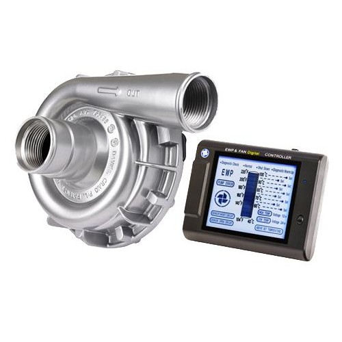

Just for clarification, I have the latest LCD controller (8000) on my setup, coupled with the alloy 115 lpm pump (picture below). So the operation of the pump I described in my earlier post is applicable to this controller and I don't know if the earlier model is exactly the same. Mine is fitted to the race car and I only really have experience in that situation. It certainly is a significant improvement on a standard waterpump set up when racing so it logically follows that in normal (gentle) road driving it could be somewhat of an overkill. Heater always works fine. It is also worthy of note that my coolant flow has been modified, to that a number of others on the forum have done, with a replacement header tank high up with a 1/2 in hose connected from that to the bottom hose (before the pump), plus bleed feeds from the radiator top and the standard one from the thermostat housing.
One thing I have learned from the race car setup is the value of having the pump and fan continuing to run after the engine is stopped until the set temperature is reached. As a consequence I have rewired the radiator fan and relays on both my road cars so they are fed from the always live fuse source rather than live only when ignition is on. They can also run on until cut off by the thermoswitch, rather than off when the ignition is turned off. That does also seem to make significant difference as quite often when I get home the temperature gauge is reading 90 rather than the 82 it cruises at (only because the last part of the road to where I live rises 200m over a 3 km stretch of lovely fast twisting roads and I just can't resist putting my foot down).
I'm interested to see how you both get on with the mod DC suggest and how this then performs both in your current colder temps and again how it copes with heavy traffic on hot summer days. Even if you have to take the thermostat out every spring and put it back in the autunm, that is such a simple task that it is well worth it if it provides peace of mind of a cooling system that works in all conditions. It is certainly a modification I am seriously considering when I next have a mechanical pump failure.
