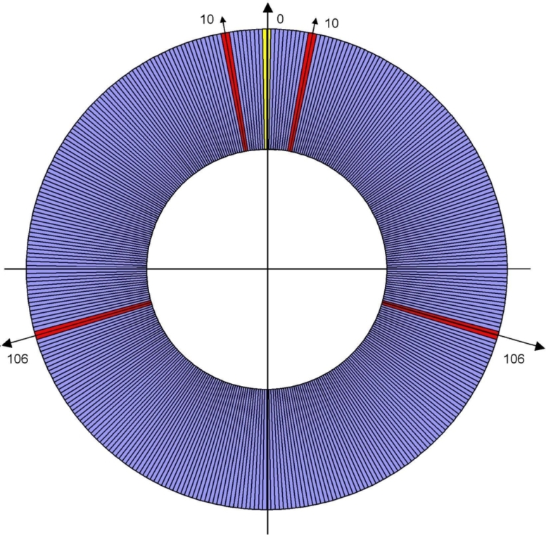

Just in case you, or anyone else, should need it....
- Degree Wheel.JPG (384.09 KiB) Viewed 2069 times
