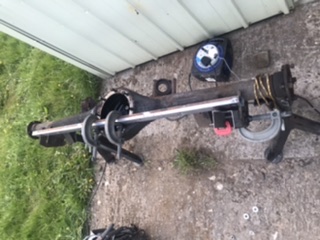

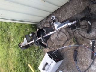

Had a good Bank Holiday weekend, and finally did what I should have done years ago, and made an axle mount jig.
Been putting it off cos of the cost of buying box section and trying to work out how to recreate the inner mounts. But I was digging through my wood pile in my garage and pulled out some metal box section that I’d entirely forgotten I owned!!
Turns out it’s a cheap metal bed frame, made of 50x50 and 40x20 box, and perfect for a jig!
So cut it to length, just over the length of the outer outer mounts and rested it on the front of the outer mounts. To ensure squareness and so it didn’t move, i clamped it to the diff housing nuts, making sure that the nuts were in the same orientation.
I cut some of the off cuts up to fit into the outer mount, drilled some 12mm holes, and used the proper 7/16 bolt to align the holes, putting some G clamps to make sure it was the right angle.
Threw a handful of tack welds on just to keep it in place, while I moved onto the upper mounts.
My main issue with these is the design of the upper arms, well my main issue with the rear suspension in general, is the choice use of bushes in some odd ways. The inner axle-side mounts are a sandwich bush, which essentially creates a rubber spring. so when the axle is in bump, it creates a force trying to rotate the axle nose down AND nose up. Nose down from the articulation of the axle upwards and nose up as from the articulation of the inner arms. Also making new copies of them is an absolute pain, so I’m changing to a “solid” bush in the form of a rose joint. This will also allow me to make the pinion angle adjustable, as well as down the line the axle alignment/rear toe.
So, cut some box and use an M8 bolt with a 13mm head, and with the 1mm wall thickness of the box gave the right thickness.
Made some circles that fitted perfectly in the axle mount and centrally mounted the bolt and welded it all together. My idea is to make one side mount first, then use the ball joint to locate the other side correctly.
With this all made up, then welded this to the main box with some stand offs. Went to lift it off and realised how flimsy it was so added some bracing which was spare from another project.
Then, had to cut my nice, perfectly round, perfectly sized circles so I could get the damn thing in and out of the axle!
But now, it slides in and out and fits perfectly!
Now to copy it over to my English casings, one to go on the car and one to build up to survive abuse.

- My nice circle plate to sit in the inner mounts
- B9E95106-E5E7-4954-9B89-F6E79B1D821C.jpeg (29.55 KiB) Viewed 128315 times
- All mounts added, just before final welding
- 1DB64FFD-2168-4A2F-A128-F745CE323CC1.jpeg (34.61 KiB) Viewed 128315 times
- Outer mounts and main bar clamped to the axle pre-weld
- 9208BCDF-BD5F-47AC-8099-9BDBA7C63681.jpeg (34.49 KiB) Viewed 128315 times

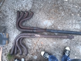

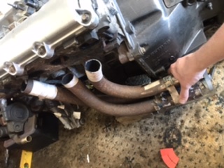

Then finally got around to the exhaust manifolds, which I knew would be a pain. I chopped up a pair of BRISCA manifolds for a Pinto to about the right length and arrangement so that it would sit just above the steering rack and be as tight to the block as possible. I chose the Pinto as it has a very large bore spacing and it’s only about 6mm off the Jag engine, and the BRISCA manifolds are designed to come straight off the engine block so it could be used on both engine banks with some considerable massaging. I got two, and made the mistake of assuming they’re all the same as one came with a 1 5/8 inch primaries and the second came with 1 3/4 inch
. Oh well, I knew they wouldn’t be perfectly symmetrical.
The drivers side one looks a whole lot worse because of the snaking between the steering rack and the block bing very very tight.

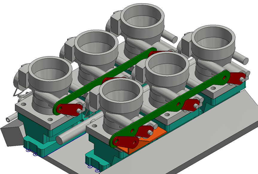

For the intake set up, I’m going with MG MHB000080 throttle bodies that will be modified slightly to reduce the profile of the throttle cable retainer. These are a 48mm throttle body, which is plenty big enough, if they end up too big, I can adjust the linkages to reduce the opening angle, which is what MG/Rover did on lower power versions of the K series. I modelled up the top of the engine and some of the significant features of the TB and threw an assembly together then modelled the profile of the runner I wanted and had a friend 3D print it. I’ve since coated the inside and sealing faces in epoxy resin to help with sealing and fuel protection. Just need to buy all 6 now, I’ve just got 2 for now.

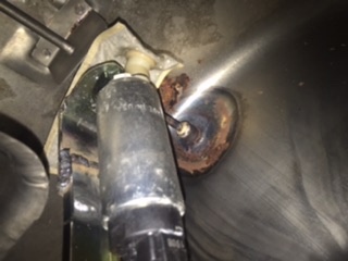

I also got the fuel tank and fuel pump set up. It uses a Walbro 255 pump on a Subaru Liberty pump hanger that I cut down to length. It now fits into the fuel tank so the pick up point is as close to the old output pipe as I could get it. I couldn’t get it in the centre as there is a bowl for the fuel sender unit to sit in. I’ll have to add a baffle or something in the future to prevent fuel surge.

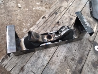

- Gearbox mount welded and assembled
- D5C5C987-8D62-466A-8474-151D1256E884.jpeg (36.8 KiB) Viewed 128268 times

- BRISCA manifolds
- 5F365027-83B2-411E-BE71-52BE7DF091C5.jpeg (37.46 KiB) Viewed 128268 times
- Hacked up BRISCA manifold
- E6675488-A69C-4302-BD37-45D5B035918C.jpeg (34.06 KiB) Viewed 128268 times
- Throttle Body model
- E67F67C3-B9DE-4DF8-825D-5175B955C55E.png (339.4 KiB) Viewed 128268 times

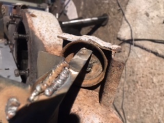

Just an update to include some pictures of the fuel tank modifications
- 5825E061-7D1F-4723-8DBC-B7BEF1340C1C.jpeg (26.37 KiB) Viewed 128172 times
- 5D4CD85B-E7EE-44B7-A1A3-DB1528E46247.jpeg (24.71 KiB) Viewed 128172 times

Hi youve modified your fuel tank similar to mine,how are you running the fuel lines,and what size pipe are you using for the return fuel
