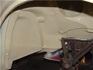

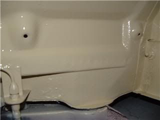

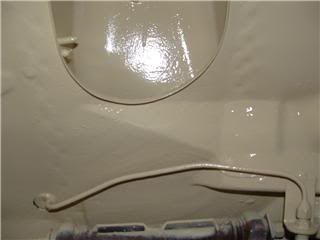

Thanks for the +ve comments. Hopefully Nath wil post a couple more picture taken this evening. Just painted over the red oxide and have done one coat of anti stone chip. Will do a couple more coats over the next day or so. Then body colour paint after that. Fit shock at the weekend.
Came to look at the car this am, the antichip coat had 'slid' in a couple of small spots. Nothing major. Now painted in the body colour. Will try and refit the shock tomorrow perhaps. More piccies to follow.
I will be purchasing some black Smoothrite tomorrow to do the little bits and pieces, the splash guard included. Shock nearly sorted, will be done first thing. Will also paint the wheel, then move the car over to do t'other side
After that it'll be the front valance, then the sill. Brake master cylinder and MOT, maybe.
Concours might be stretching it a lot but I want to try and do the best I can. Just think this is such a nice car to start with, it'd be a shame to do a slap dash job on her.

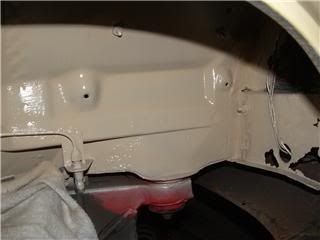

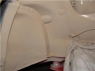

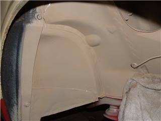

Ok, more of a serious update. No Nandos jokes or comments
o/s all back together now, replacement shock doing the job beautifully. Mucho improved compared to the n/s. Moved LD over to one side of the garage to make more space to work on the other wheelarch. Fully charged battery saw her start second time, not bad for a car that last ran..... at some point last year.
The n/s shock came out quite easily and will be discarded 'cos it's knackered. I followed Naths advice and removed the front and rear splash guards. On the whole the condition of the bodywork is pretty sound. Similar to the other side, just surface rust. However, the splash guard was hiding a 10p sized rust hole. This wil be cleaned, treated and patched. Nothing major at all. In fact around the headlight area was slightly better on this side. Mostly due to there being the splash guard to be honest. The next job will be to wire brush everything off and rust treat. Sounds familiar
Had a quick go with the wire brush for an hour or so. Thankfully, all is well under there. As I initially suspected, the majority of stuff is surface rust. Along the back of the wheelarch, above the footwell panel is a little heavier corrosion-wise but again NOT holed in any way. I will cut out the rusty metal and put a proper patch in. I'll take a piccie over the weekend as my description is pants. It will only take a couple of minutes. I know I keep saying it, but under the surface rust, dust and dirt this car is amazingly solid. I will get round to replacing the n/s sill at some point, just to be on the safe side. Not yet though
