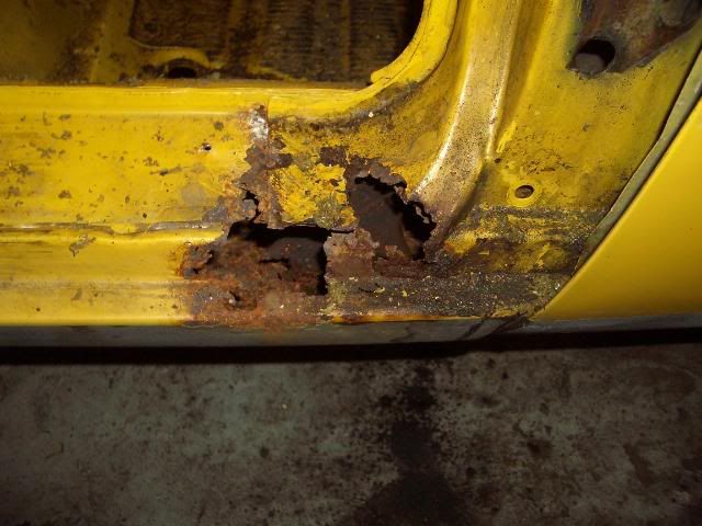

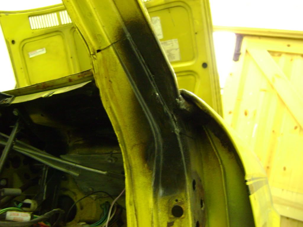

Drivers A post repair..
Before..mmm..nice!
Sill repaired, the old one was non existent! A post rot cut away.
New A Post cut to measure, then placed on top..
Finished..
A fantastic repair on a tricky part of the car.
Big thanks to David for the A post :thumbsup:

It just never ceases to amaze me the level people will go to to bodge something or cut corners. The amount of filler used to reprofile the sill was amazing. The time and effort absorbed must have been extensive. If only they had put that amount of effort into doing the job properly, they wouldn't have needed to use 10kg of filler.
The pic of the rear jacking point is priceless. They had stopped the repair metal short of the rear end and hadn't even bothered to rebuild the jacking point. No wonder it had collapsed. The best bit is the angle tack welded to what was left of the reinforcer plate. Utter madness.
Oh well, off my soap box and back to the welding.
