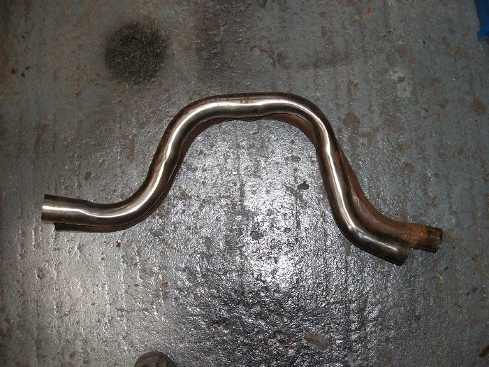

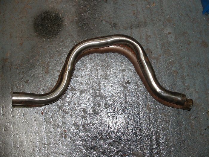

So I thought I would compare them...
...as you can see, a vast difference in the bends. I'm sure I will still need to fettle with it once XJX is on the road.
So Rich (RJF_70) you may have to heat it up and bend it to get it to fit properly.

Mmmm I tried mine both ways round and neither way came close to anywhere near the inter pipe! Hard to tell from pictures whether my over axle pipe is the same as either, but bought complete system 2nd hand off a sprint car so fitted fine on the sprint according to seller! Mine is an 1850 but bought the adapter for front pipe so should be at the right angle coming off the downpipe at the beginning of the system. Walked away in the end as was running out of patience fast.

The diameter of the pipe looks reduced inside the radiuses (or is it radiai?)
Does that affect performance?

I know some of the system had to be modified anyway, to fit a Vauxhall powered Toledo but my Rimmers sport system over axle pipe had the same angle defect as bought which initially caused the tailpipe to drag on the ground. A bit of heat and some BFMI soon sorted it but it shouldn't have really been necessary to mess with that bit. Maybe the pattern has got a bit corrupted over time!

Yes, it does.James467 wrote:The diameter of the pipe looks reduced inside the radiuses (or is it radiai?)

Looking at the photos Mark has put up there is a noticeable narrowing of the pipe on one of the bends, which to my mind would strangle the flow of the exhaust and therefore negate the benefit of having a large bore pipe?

I did in the end get this sports system fitted to my 1850, but wasn't easy. After a lot of hours over a few days and a chat with Bruce I got it on and sounds really nice. My over axle pipe isn't kinked at all like the one Mart put up on picture, only downside is the adaptor for the 1850 down pipe is too long imo so will probably have to disassemble it to shorten it by an inch or so because as it sits the clamp isn't quite on the slotted flange of the adaptor and there is a bit of a blow as a result of this. Apart from that well happy with it

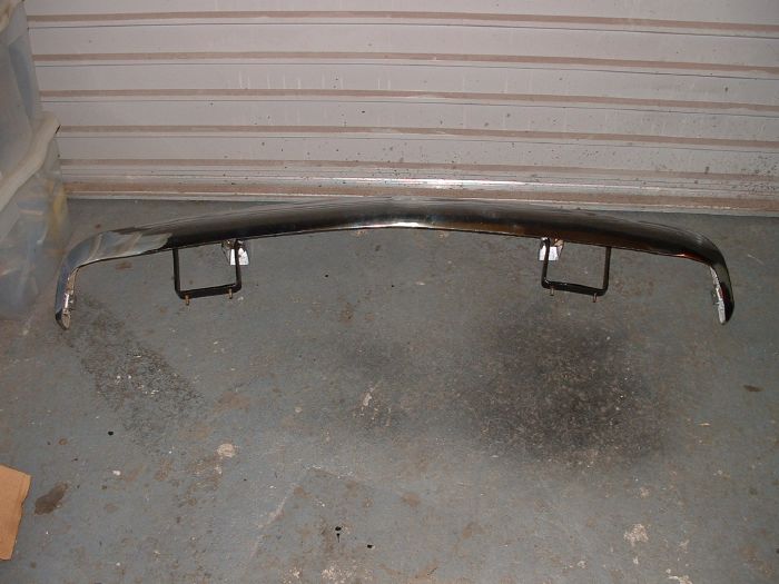

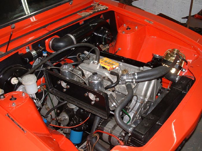

I forgot I took a couple of pics last weekend.
Front bumper ready to go on...
Nearly done in the engine bay. I now have a battery earth lead (from Ian) so I'm hoping to get it started at the weekend...
I had a slight set-back when I went to bleed the brakes. The pipe to the rear brakes has a hole in it so I will need to make up a new pipe tomorrow. But it's getting there.

Such a clean tidy and shiny engine bay. (envy)
