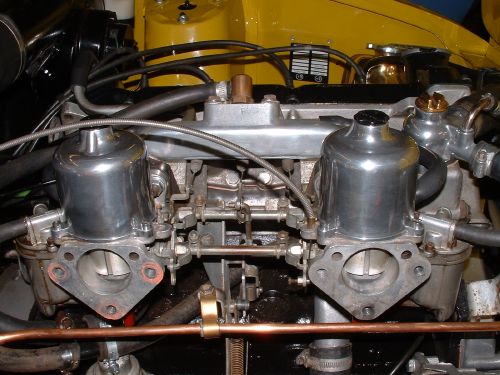

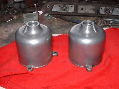

Tuned the carbs today, picks up much better at lower revs. Lovely gubbly.
Also got round to polishing the dashpots:-
Before:
After:
Before:
After:
Re: Project BFR (1973 Mimosa Sprint)
what did you use to polish the dash pots up mart? same as wheels?
- Posts: 8529
Yep. Use a polishing mop attached to a power drill, then use the green compound, then the pink, then finish off with a soft mop & Autosol.
