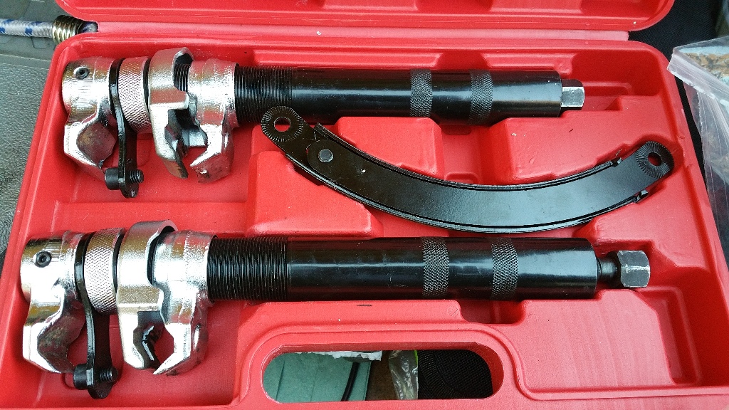

Spring compressors, not the best of brands, but reassuring in use.
Still have to do the fronts, but that will have to wait a couple of months,
should anyone be in need, more than welcome to collect and borrow,

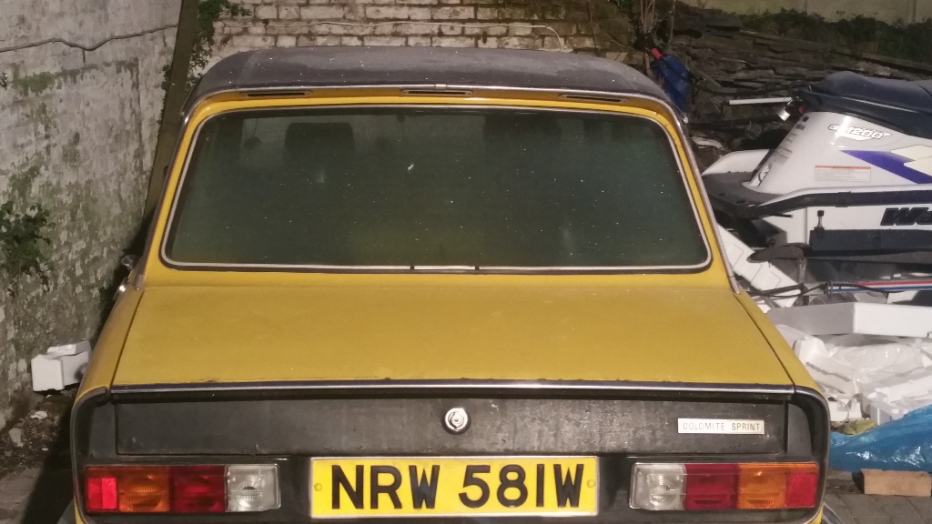

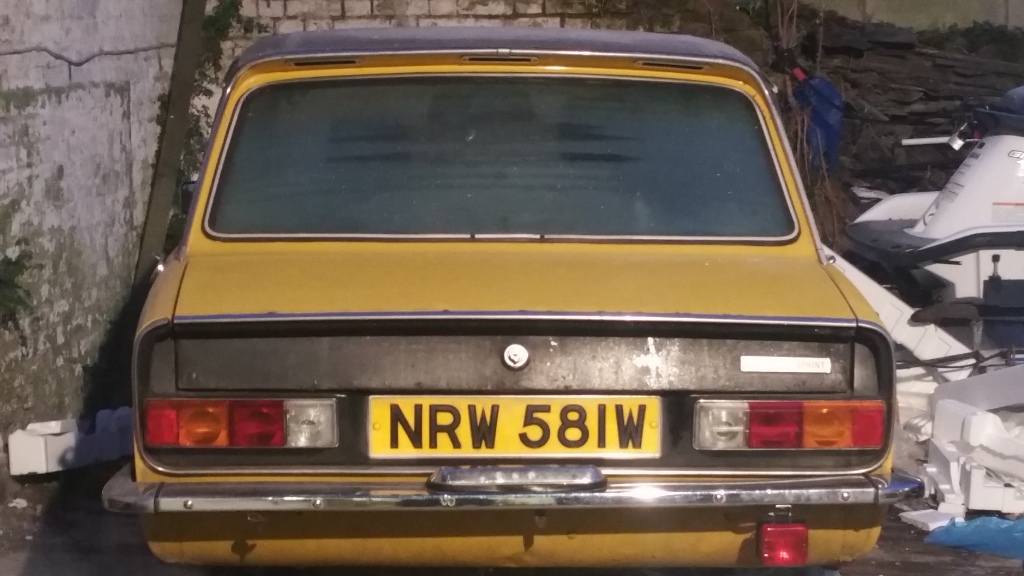

Took these pics a few days ago when the car was frosted over,
The rear demist works, albeit a bit slow,
Damn, the pie cluster demist bulb has just gone

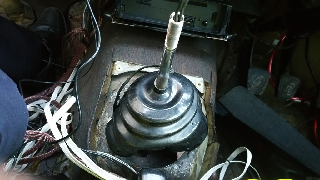

All these years and I didn't know there was a rubber gaitor available to reduce the noise level.
Gaiter should be held to the tunnel with a "unique to Sprint" clamping wring with 4 self taping screws that
should but almost never do line up with the plastic spire nut thingies in the tunnel, which may also be missing
having fallen out.
Does make a HUGE difference to gearbox noise and refinement - gets rid of all the whining and hissing.
having fallen out.
I've used No.8 1/2" screws with a washer to fix the gaitor for now, will look for the ring.
Luckily the plastic captive nuts are all in place, covered with glue, but present.
Test will be on Sunday to see if the noise levels are down, but first still have to
Screw down tunnell,

Stag or 2000 manual clamping ring works Ok, and these are still available from the usual suspectsJon Tilson wrote:Gaiter should be held to the tunnel with a "unique to Sprint" clamping wring

I found that now allowing my wife in the car does the same thing.......Does make a HUGE difference to gearbox noise and refinement - gets rid of all the whining and hissing.
Forgetting the mobile phone at home removes all unnecessary noises from a vehicle
