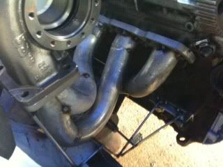

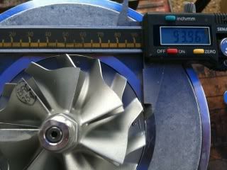

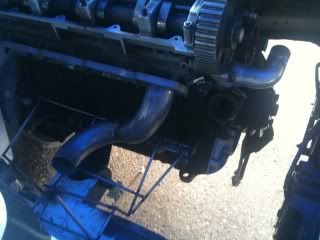

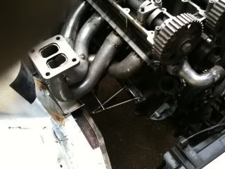

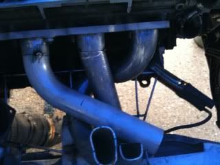

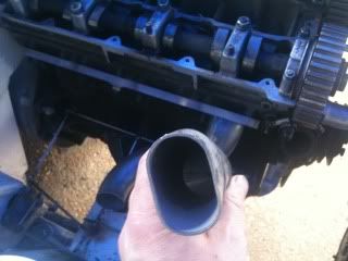

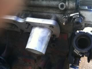

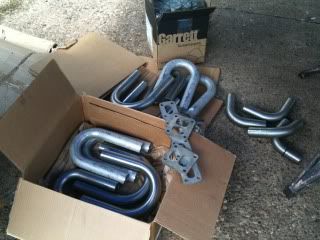

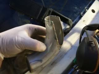

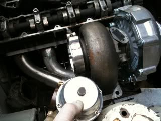

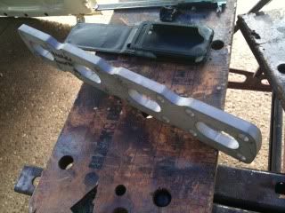

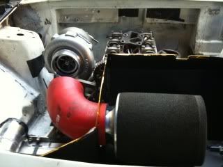

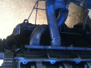

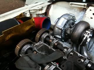

One little update
I had some inconel bends turn up from america the other day
as i had a new turbo earlier in the year, the old alg1ks design of exhaust manifold is not compatable with the new turbo .
so i had to fabricate a new manifold which i have only ever done one
which was a straight forward design unlike this one as its a split pulse turbo i now have
as the turbo is so big you need all the help you can get making it spool up early
I was a bit hessitant to cut this steel up as it is SO dam expensive
I measured 3 times then cut LOL
This turbo should be on song at around 5000 rpm
here are some pickys in no partic order
The nearly finished article
I have to tig weld it up and fabricate the waste gate pipe
Just shuts Lol

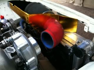

I have also made a new air filter box which seals againt the bonnet when shut
it houses a 8 inch dia by 14 inch long filter which should flow enough air
I have also fabricated a new intercooler this is again an american core from garratt
I fabricated the end tanks and 3" pipes and it fits quite well
These are just a few photos of the 100s i have taken
I will put some more up when i get five min
I want to get all the fabrication out of the way before i start on the body work.
