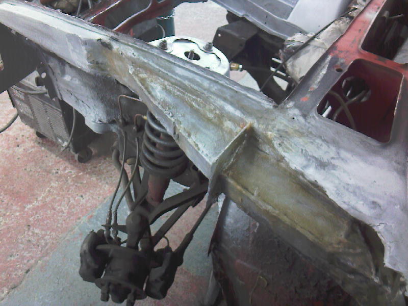

A pic of the passenger side post i made and repaired on friday. I zinc primered it inside and out and then fibreglassed over it to waterproof it even more before i prime it again (I know im excessive but i want it done right) Then before wings go on i will underseal all underneath wing and surrounding area...

This was under wing post before, when i took the wing off.

that's a handy repair alright, I've never seen a reinforcer quite that bad, though VLKs did need plating. Did the car have the under wing plastic shields when you took it apart, I suspect the upper horizontal one may have been missing to cause what you found. Might be a worthwhile purchase if so to protect your handiwork...
