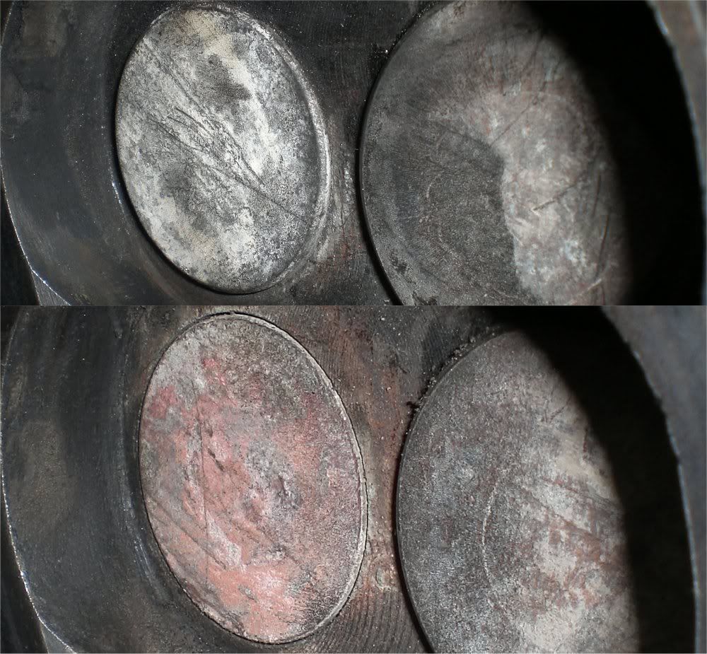

Regarding the hardened valve seats; I've ran my Vitesse with no additive for as long as I've owned it and there's never been a problem with valve seat recession. Also, as far as im aware the owner of the Toledo before me never used a lead substitute either and again there's no sign of recession on this car either.
I've been told by many old time mechanics that Triumph Dont really suffer valve seat recession and that they've known of many triumph OHV cars do thousands and thousands of miles without any problems. However, the mechanics said that recession really does suffer the BMC and Ford units, as there valves are made of weaker stuff apparently. :wink:

Maybe it's a case of "lead memory" that I've read about, some think it's folklore but the theory is that if the seats haven't been interfered with since the withdrawal of lead from fuel then it is still retained and still does it's job.

I can assure you it does happen on our engines. I adjust the tappits on mine roughly monthly and ex 1&4 are always tight, if I don't do them often enough the gap closes up entirely. I've a photo somewhere of when I did a valve change on the old engine which did much the same.

Here you go. Different head to the one on the car now but just like the current engine it was always E1 & E4 that were tight at the tappits. No2 above pretty much matched the height of the inlet, no 4 below was almost flush with the chamber crown.

Hhmmm thanks for the pics pal, i think have to do an unleaded conversion then. :oops:
