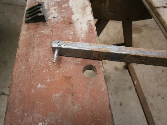

the device for blocking the outlet tube. This is essential, the sealant appears capable of blocking substantial holes and could easily get into and block the pipes.

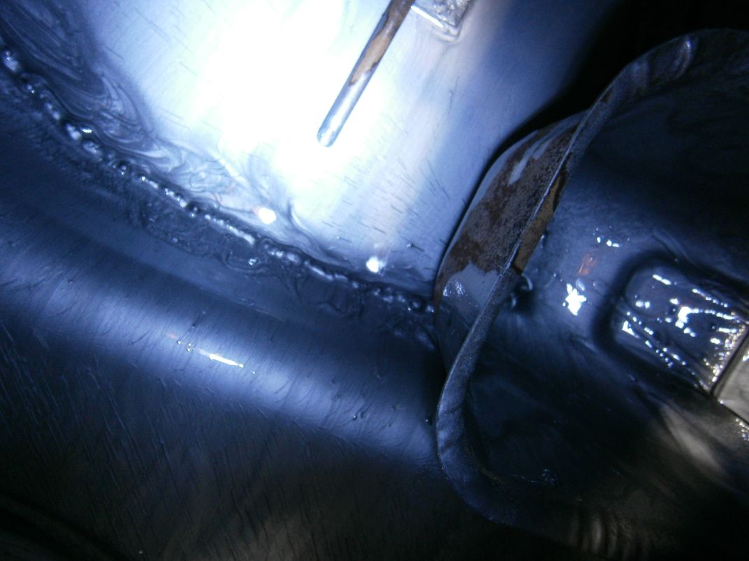

Looking inside the tank after treatment. Thick silver coating, almost plastic and claimed to be impervious to every known solvent. A bit ended up on the shed floor and I reckon it is indestructible !

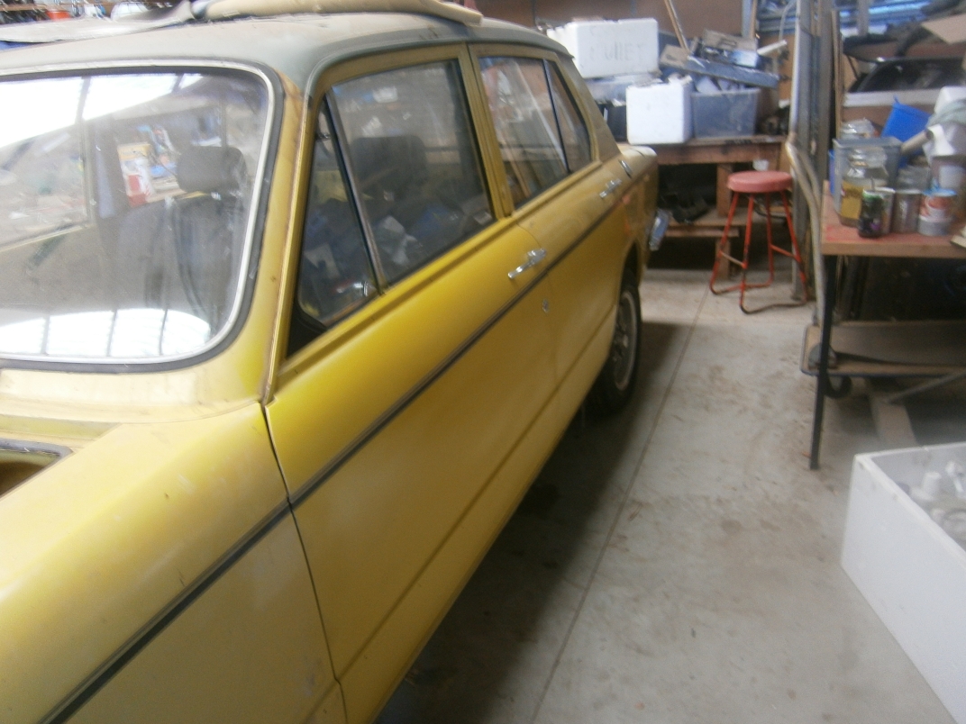

George finished the two left side doors, which had rotted out sills and rust around the wing mirror holes. I collected them and rubbed back the primer he had applied a bit too generously to get the black side stripes back, then sprayed yellow to at least make them fit in with the rest of the car. This was dead dodgy as well, I brought out the air gun and attempted to spray from the leftovers George gave me from the original sprint. Having watched George and used plenty of thinner, not being too worried about the final finish, I was pretty confident it was a no brainer, but it appears brains were needed. I used enamel thinners and the paint was a 604 poly. It went on okay, but will need fixing in the future, when the car gets a full reco. Still, at least the car is generally the correct colour !
I refitted all of the door glass, rubbers, fitted new inner and outer weatherstrips. Still got a problem with the right hand rear door striker as the door sits about 3mm proud and wobbles, no more play left to get it to sit closer. I did realise, after fitting the doors, that the hinges were a bit rubbish, too much vertical play due to wear, so that is also on the list of things to do. Doors took forever, but at least the windows go up and down !

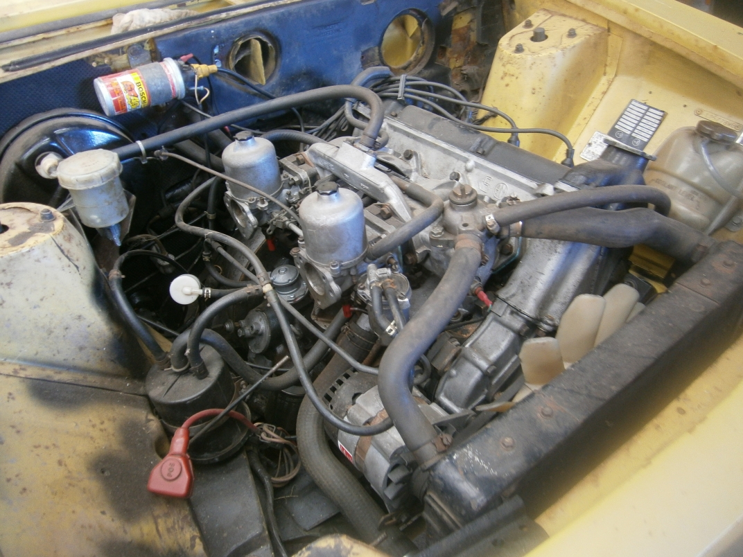

engine has at least been running

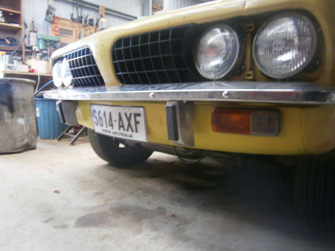

brand spanking new number plate
rear plate, the exhaust is merely for show, nothing else is under the car.

got the engine started today, nice healthy roar. Lack of exhaust helps :)
