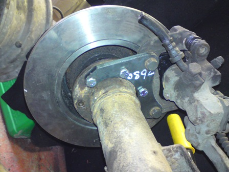

Got my caliper brackets today. I am, if I may say so, very very chuffed with the result. They fit straight on and all the holes actually line up. I sound surprised as I only measured the positions with a steel rue and a plywood template! No filing, nowt.
I'm hunting around the tins and tins of old bolts to find some long enough to bolt the whole lot up. Will also dill and countersink the screw holes in the discs as per the drums tonight. Once it's all together, I'll subject you to some pictures.

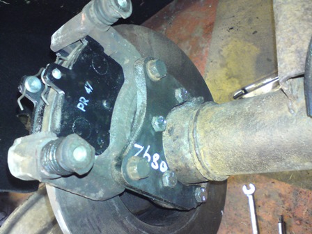

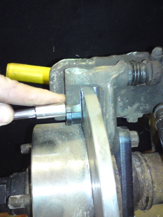

I found some longer bolts and fitted the plate brackets. The discs and caliper carriers were all nipped up but alas the outer surface of the disc touches. I relieved the carrier with a file and sweat to give the clearance you see in the picture (next to the screwdriver tip).
The caliper pistons have been wound right in to accomodate new pads. Once on, I'm delighted to see the pads are just the right size to cover the full friction area as though they were meant to be there! This is of course where the delight ends as when trial fitting a knackered old Sprint alloy, the fouling starts. I always knew I'd have to do a little fettling to get it in there so I'm taking a break from filing the outer caliper surface. I'd say it needs about 2mm removing from the corners to achieve a clearance for a piece of card. I had to do something similar to get Trackerjacks Sierra calipers on the front. I guess these alloys just won't give up easily! I'm not losing too much sleep as the calipers are very well engineered for a car originally weighing twice as much. Or at least that's what I keep telling me'self!
- Filing to clear.

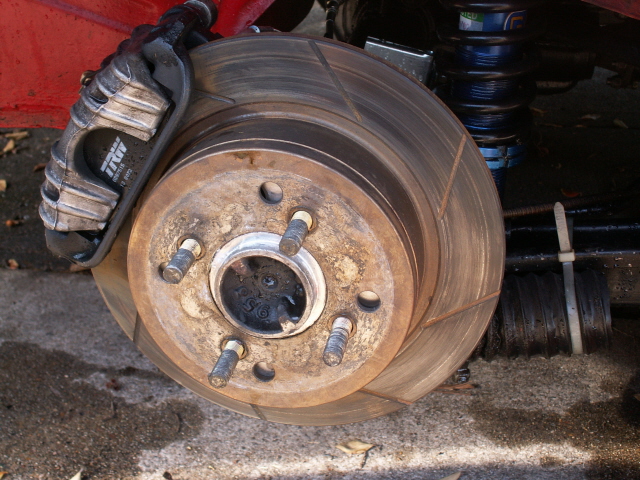

I am yet to be convinced that there is any difference in performance of the brake calipers, be they leading or trailing. I believe that position (leading/trailing) is based on suspension/steering design, ie clearance of steering arms etc. Leading calipers might be easier to feed air to for cooling.
On the rear who knows why they are where they are. The photo below is of the rear brakes/axle set up in my race car. It is straight from a Nissan Skyline/Pinatra, trailing calipers and all works fine. They are somewhere around 260mm diameter, slightly larger than the front rotors which are 255mm.
[img] [/img]
[img] [/img]
