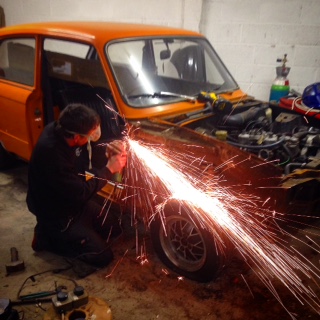

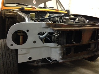

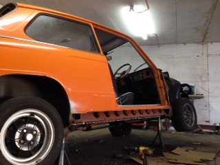

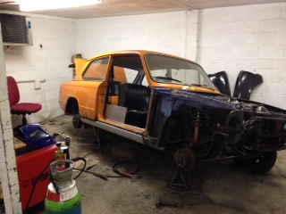

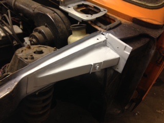

hi good people, here's a little photo update. Seems about every 6 month or so that i manage to get some work done. I'm currently working on the drivers side. I finally got round to ordering the headlamp panels from Alun this week so when i have tidied up the rest of the welding i shall try and get these fitted

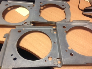

No sooner said, then delivered! i just had to put a picture up of these as the quality is pure perfection. Very pleased and thanks to Alun for sending these to me.

Would anyone know the dimension of the angled mounting tab that fits between the headlamp panels and the inner front panel?
1971 2 door Toledo aka Chuckie (porsche orange)
- Posts: 13568
Re: Wing removal and front end overhaul
It protrudes 54 mm from the inner valance and is 76 mm high. The top of it is 80 mm from the top of the front panel and it is located 28 mm inboard of the circular headlamp hole. The front facing flanges are 19 mm wide.

A little more progression this morning! The box section under the wings looked a little ropey so while I've got the wings off I thought I would chop out the old and put in some new

Welding has been finished, and Chuckie has been moved back home ready for the next part.
After crudely fitting the fibreglass front end with self tappers i can see i need to do a bit of fettling here and there to make it all fit.
