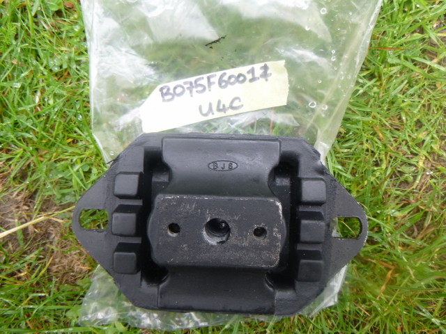

Now the Lotus part has arrived ( B075F6001Z ) and just with an empirical fingernail test on the castellated rubber bit , yes it is much softer.

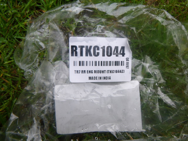

The Rimmers part came in a bag labelled " RTKC1044 TR7 RR Eng mount TKC1044Z & Made in India " but with a 2nd label "TKC1044 Gearbox mount , rear "
The Lotus part was embossed in the rubber with "BJS" in an oval logo.
I Googled it and found this company based in Wales.
http://www.bjsparts.com/
It looks like they are a major manufacturer to the automotive sector and are U.K. based !

In all honesty, I wouldn't use an Indian made TKC 1044 hard rubber mount except as a "better than nothing" There may be times when it will work as Tony has so far proven. But i'm not about to do the work on a possibility of success, when I can be assured of it for less money with the Volvo mount!
