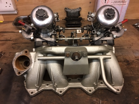

#48 Post by AlanH »
Just seen your carbs. They look terrific but it may be a good idea to ditch the waxstats (stick a couple of 1ps in).

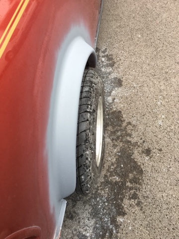

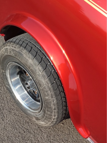

Having to mould new arches onto the wife 73 mini as I had promised for months!!
Be back on the dolly by the weekend. So looking forward to driving her again but still seems a mile away yet. My birthday next week and everyone thinks I'm sad wanting car parts for presents, offered to get the misses a new iron for hers, she didn't see the funny side lol.
Hopefully she'll be happy when the arches are done.
Arches
Arches

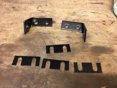

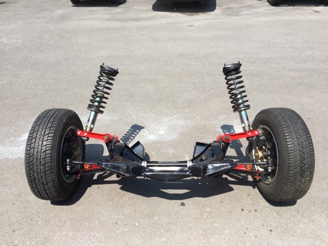

Got the brackets I needed (thanks to Steve) so was able to start putting the front suspension back together
Bits I've been waiting for cleaned up
Ooh shinny
Ooh shinny

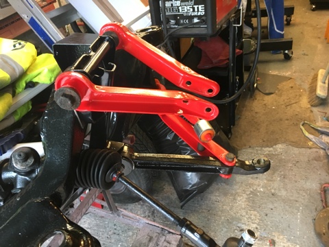

Finally finished the arches on the mini and had enough time to finish assembling the the front suspension, will probably make a start on the body work while the weather is good and do bits on the engine when it's raining. So will probably have the engine done first !!.
Mini finished back to the important jobs!!
Subframe and suspension ready to go !!

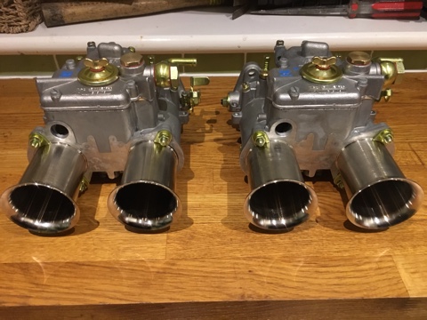

I have now rebuilt the refurbished carbs and manifold, but am now going to fit a pair of Weber 45's as the rebuilt engine has a fast road cam fitted and want to get the best out of it. I will be selling the fully refurbished ones with the manifold and air box at some point soon so please get in touch if you have a good home for them to go to.

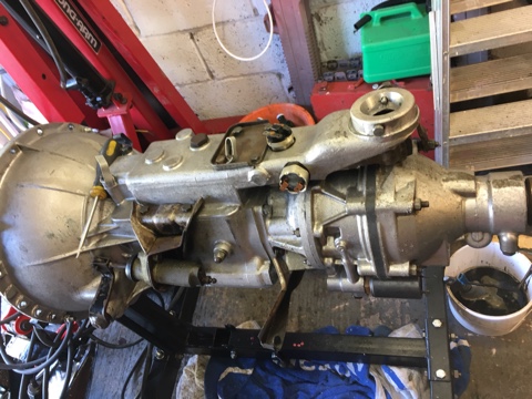

Also been cleaning up the last few crud covered bits I.e. Gear box and mounts, adaptor plate, sump cover etc.

Got my engine back today after a total rebuild (thanks Mart) and my new twin 45's came today.
Now got to get the rest of the car to look as good as the engine.

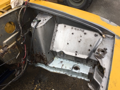

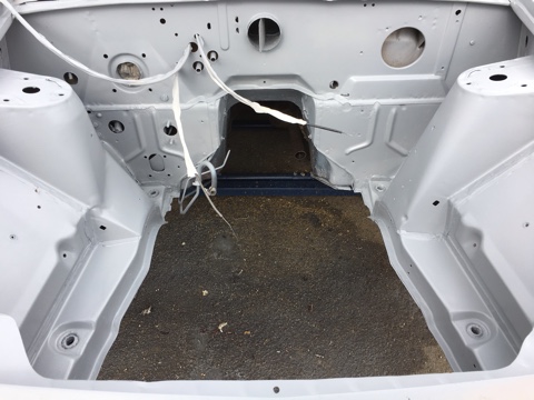

Been a busy on the car lately again lots of little bits and a few big jobs completed, striped the engine bay clean and removed all the paint, which was a pleasant suprise as no welding required but spent a lifetime getting the old subframe bolts out, one had to drilled, heated and finally knocked it out with an air chisel. Wish I tried the air the air chisel first, live and learn!!

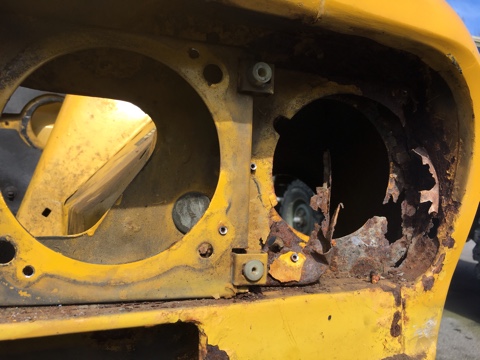

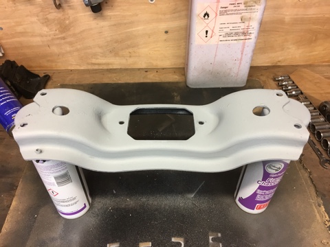

Refurbished the servo and master cylinder, engine support bracket, steering column plate. On the down side lots of fabrication needed around the headlight pods inner and outer plates plus inner eyebrows rusted out.
Rusty bits.
Rusty bits.
Rusty bits
Rusty bits
Rust treated and etch primed ready for paint.
Starchem works well
Starchem works well

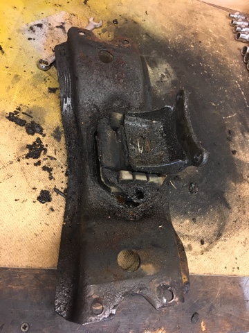

Servo done ready to go back

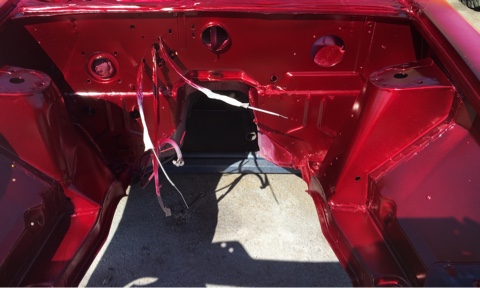

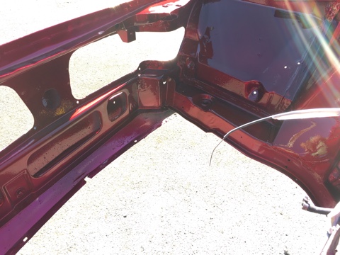

Had a good day with the weather so concentrated on getting the engine bay ready so the suspension can go back in and make it mobile again.
Deep red candy, not original but I like it !!!

Re: VGK Sprint Restoration
#60 Post by Mad Mart »
Love that colour John. :thumbsup:
