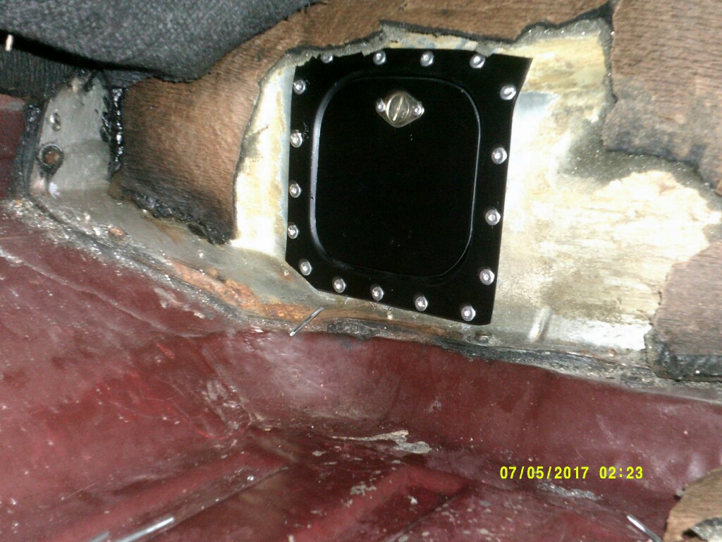

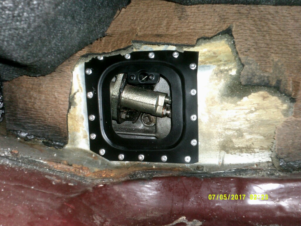

I've also had a access hatch added in the transmission tunnel so I can top up the gearbox more easily. Underlay still needs tidying.

Neat porthole :thumbsup:

#49 Post by SprintMWU773V »
That is indeed a very cool and very well constructed porthole.

#50 Post by GTS290N »
I reckon you make these up and sell them for good cash! One here please.

#51 Post by Aleco »
Cheers for the appreciative comments :D
I had the porthole fabricated by a the same company that have sorted out the metal work on the body.
I can always ask if they would be keen to make a few more. I would guess that they would need a fair amount of fettling to fit the car though as he made mine to measure.
