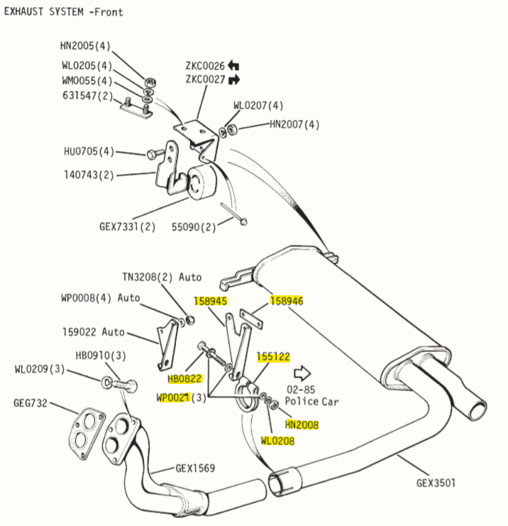

Re: RMR - 1974 Dolomite Sprint
I'm sure you've seen this full post all ready but if someone else is reading this and wondering what this thing about Volvo mounts is all about then click here.
The good news is that if you're moving to the Volvo mount you don't need the bell washer, it's built into the Volvo mount design. I measured the difference in height at 9mm, but I didn't have a brand new original mount to compare and in actual fit I ended up using 6mm of shims instead.
As an aside, and I don't want to with my best adenoidal voice keep pointing out bits that might be missing but(!
) you seem to be missing the front exhaust mounting bracket?
Sorry for my slack response time, stupidly busy at the moment!

Which, I believe, you can get from club stock.
This appears to be true! The exhaust system doesn't have the side silencers either - I guess because it has an aftermarket sports system on.
I'm a bit concerned that there is almost zero movement on the engine or exhaust. Trying to wiggle the engine with the downpipe gives zero movement. Likewise grabbing and shoving the engine about only moves the car.
I have a suspicion that the exhaust down pipe is at the wrong angle and not pointing low enough. So someone left out the bell washer to cause the back end of the gearbox to drop down and giving enough clearance for the exhaust. Then left off the front exhaust mount as it didn't fit.
When I a chance next to work on the car, I'll stick a jack under the back end of the box and see how much it lifts up by. I need to get it up soon and weld that front sill + jacking point up.
