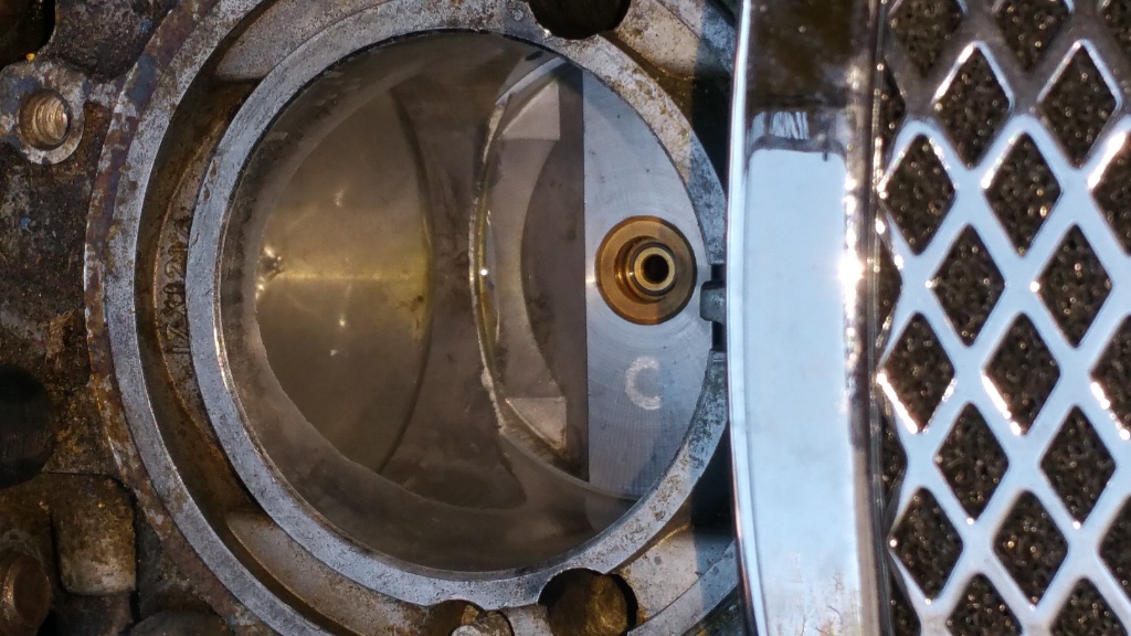

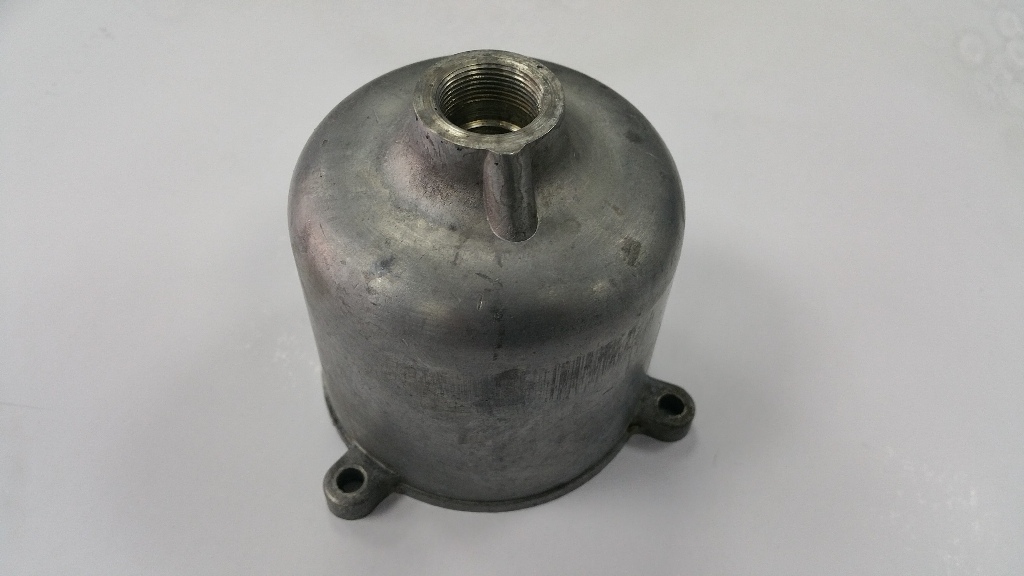

Still not happy with the carbs on my car, but its too cold to do any real work, more a case
of grab a piece and take indoors.
Dashpot cover and suction chamber out, for a clean.
There is some damper oil in the bottom ?
Dashpot paint came off in the Ultrasonic cleaner, mind you it was set to 70c temp.
The jet in the carb pic looks a long way down (rich)?
Tony, that could be about right once you've done the 12 flats/2 complete turns down for the best starting point for the mixture.

Running rich, weridly colortune says no, but my nose says yes,
Hopefully the clean out and jet/needle replacement will help.
Mahesh, were the jets set to the same height before tuning started?
Yep, I colortuned both carbs, but they did not need adjusting at all, still have to
do the front carb, however one at a time, with testing in between.
Mind you, I still got to do this rear one.
I know in the back of my mind, as a teenager I bungled up somewhere, and the
main reason to strip them down, (one at a time) and do the job properly, (with lots
of pictures), having a scrap type set does help to learn and refer to.
Already noticed there is no washer on the damper cap, and the jet to float chamber is
slightly loose.

I wouldn't use a colortune, I have had nothing but trouble with them.
On a standard engine I have always used a gunsons gastester in the past and that has always got good results.
You can borrow mine if you like
