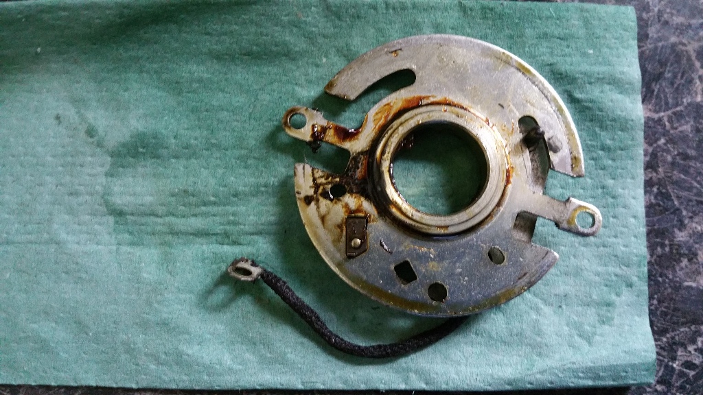

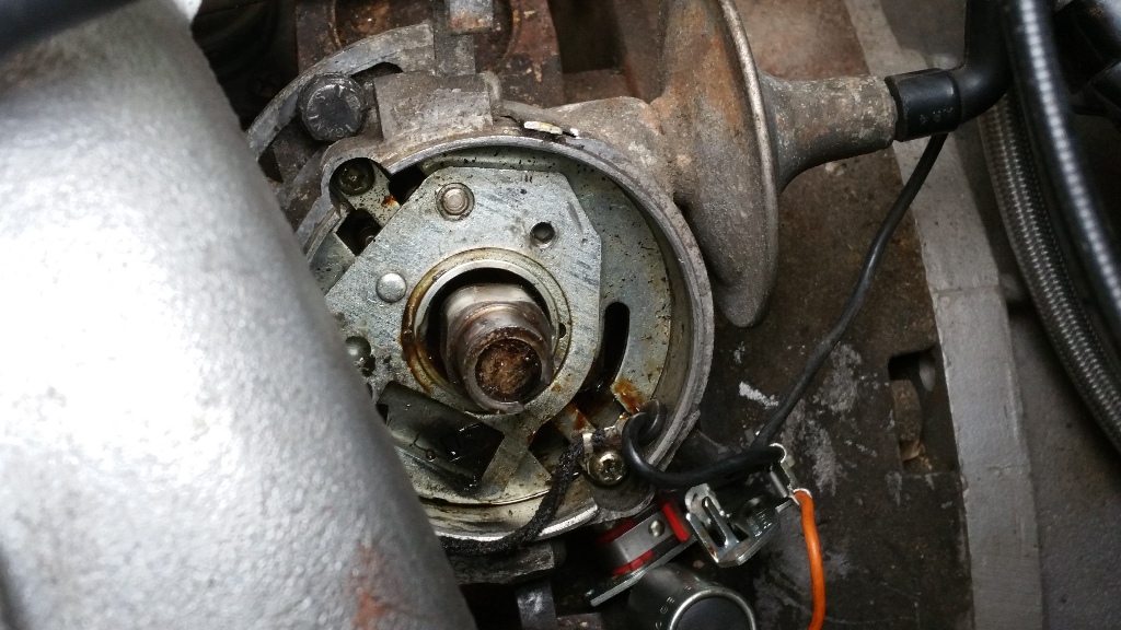

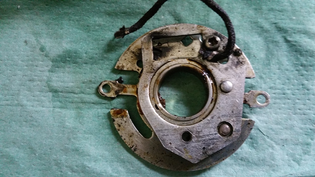

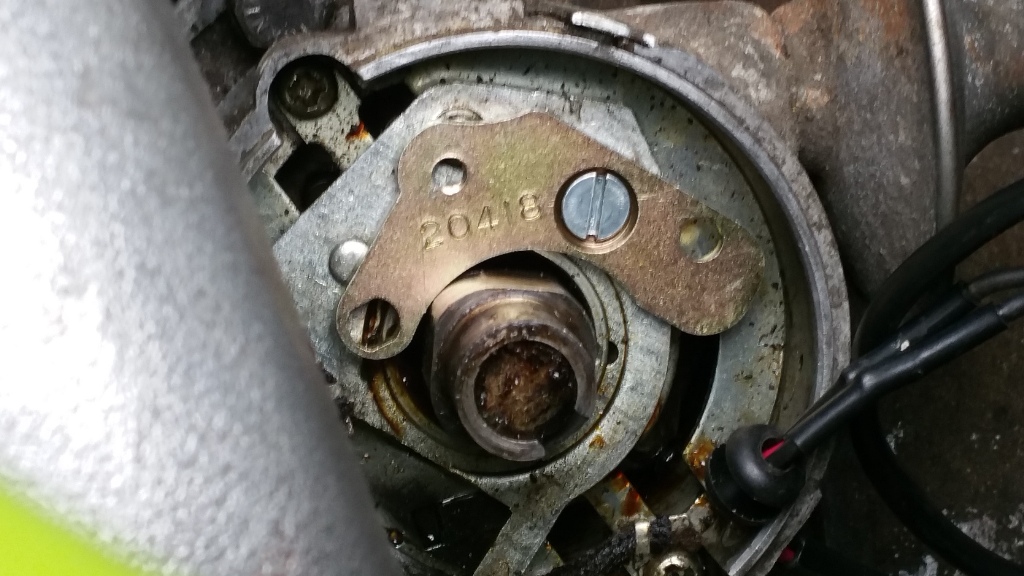

Made a start this morning, mainly all negative
Warmed up the car to temp, so I know it's working (ish).
Undone the distributor cap, removed the rotor and splash guard, and then realised the
condensor screw and contact set screw were both loose, and would not tighten up as it seems the
threads are worn.
Just to be sure, removed the contact set and condensor, which resulted in the contact set washer dropping
under the base plate, which then took another 30 minutes with a magnet and small screwdriver to retrieve.
Then put the magnetronic plate in, success, however as soon as the magnetronic unit is screwed in,
the plate comes loose but holds on the first couple of threads, just like the contact set.
Well at least it's one of the problems found.
Need new base plate, Rimmers are doing a clearance on them, unless anyone suggests a better quality source.
And this pic shows how the magnetronic plate comes loose but will not come off until unscrewed.
threads are worn.

Many thanks, but I cant find the number you need, I took the base plate out, do I have to separate the two halves ?
Also whilst the plate is out, I gave the shaft a waggle, and it moves around 1.5 to 2mm left to right, is this correct ?
Think there has been a problem here in the past, as the two screws holding the base plate seem to have worn heads,
either someone has been over tightening (seems unlikely, these were loose too) or they had problems removing.
