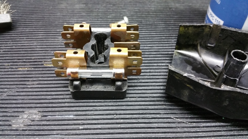

If it wasn't so cold in the morning I would have started on the spark plug tubes, instead had to be
content with removing the fusebox and cleaning it up.

Sweet...diet coke does a great job on those...
#530 Post by Toledo Man »
...and the cheaper, the better. Get some white grease on the terminals to keep the corrosion at bay. Alternatively, you could fit an MGB fusebox like I did. You'll still need to get some white grease on the terminals.

Thanks, I'll make sure to spray some grease on there, but first have to cleanup the connectors on the leads (or change).

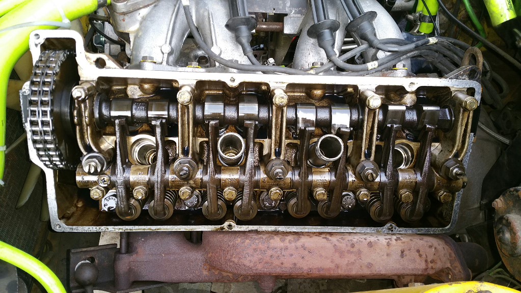

So made a start on the spark plug tube replacement,

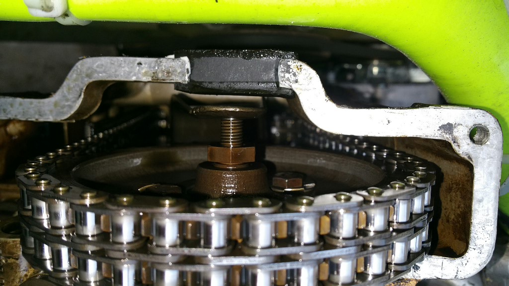

That is not attached, is that right ?

Posts: 7246
#535 Post by Carledo »
Mahesh wrote:Had a few minutes after work,
Perfectly correct like that, the bolt is only attached to the plate when removing the cylinder head.

Thanks Steve,
I was more worried in case a nut had fallen down or
been left out, never taken the cover off a Sprint before.

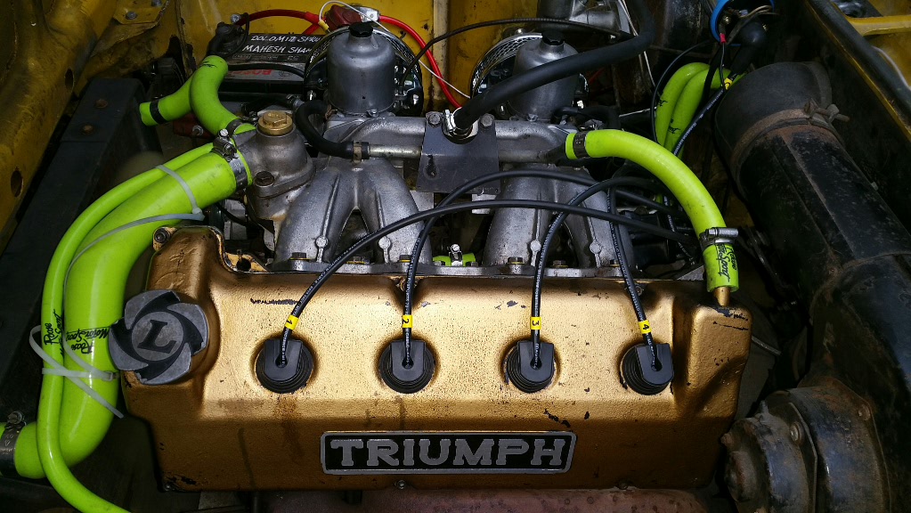

Fitted the spark plug tubes this morning, and tightened up for now, also reconnected
the fuse box.
I may have made a mistake, but can rectify if need be,

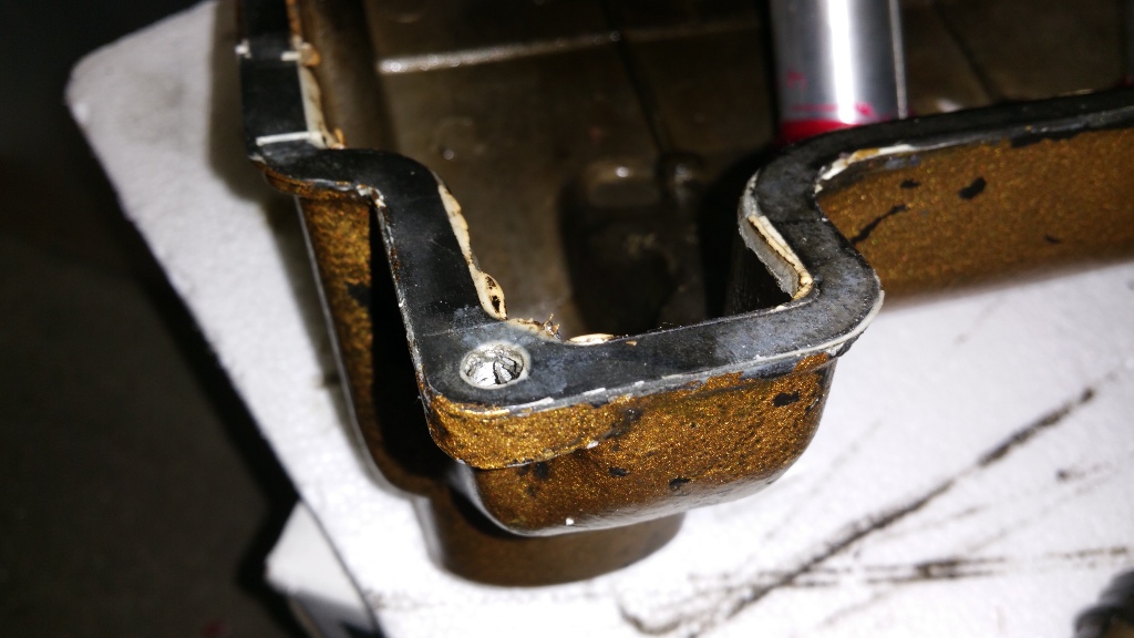

The original gasket under the cover seemed to be a thick plastic variety, and the
replacement I had was a thin paper job. So I applied some hylomar and did not
disturb the original.
Hopefully will not leak, but only a few test drives will tell.
