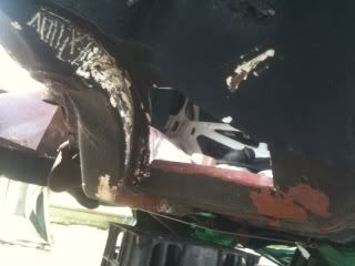

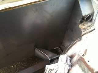

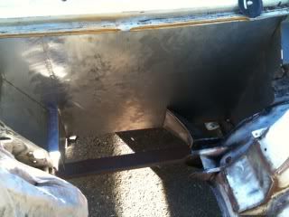

I have taken the fire wall back out and moved the engine back a little more !!
This is where the exhaust will exit now over the gbox and down
I have also put a exhaust tunnel into the floor to the back seat area to keep the exhaust higher for more clearance as its a 3.5 " one like you see on saxos :lol:

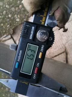

I have used quite thick gauge steel standard dolomite is around a mill thick well what i have measured taken out of the fire wall
Its a bit harder to work with but for the extra strength worth it ,

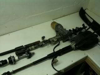

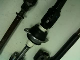

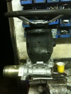

I have also managed to graft the dolomite steering and switch pack onto a corsa epas system
No run out either which was nice
I just have to work out how to get it to the rack LOL
I will be using this sliding bearing in the bulkhead
just want to do it in a way so i have some collapse crash protection

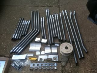

Picked the new cage up today ,
T45 supposed to be 4 times stronger then cds
I hope this stiffens the shell.. this one may handle !
Looks like i'm going to be doing a tad of welding,
Had a long chat with the lads that fit the cages there and they have given me a few tips !!
They also told me that the plates that need welding to the shell or any part of the cage that is welded to the
Body needs to be done with normal mig wire and not the cage wire

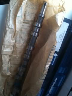

Some new bits arrived

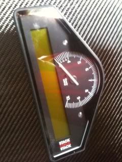

Stack dash readout with lots of addons 10.000 rpm limit i will use 9300 on this new engine..
Stack 4 bar boost gauge which i hope to strain to its limits :D

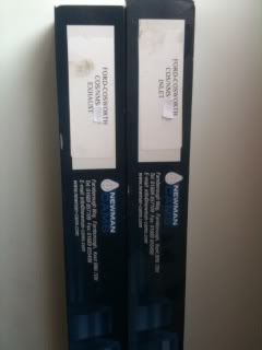

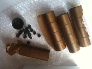

Some engine parts
Solid cam followers and cams

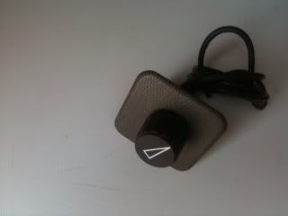

This little devise that when wired into the ecu will enable
a minimum boost setting to high in 10 incriments,
The minimum that the engine will be able to run will be 500 hp :lol: :lol: 8)

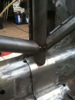

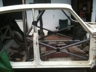

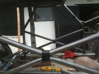

Did a little bit to day

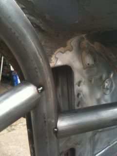

put some of the cage in to set up the front triangulation bars so i can weld the bulkhead in,
Its all got to come out again for paint prep on the shell but it hasn't been as bad as i thought it was going to be
Have had to fettle most of the joints as they were well out :evil:
There is also some poor repairs by the previous owner which need sorting before final weld
I'm also putting some extra bars in which i have seen on the wrc cars which think will help with the stiffness and safety of the shell as the dolomite cage hasn't basically changed or been updated by any company's that make them,
I will then show Custom cages to see if they want to update there design,
