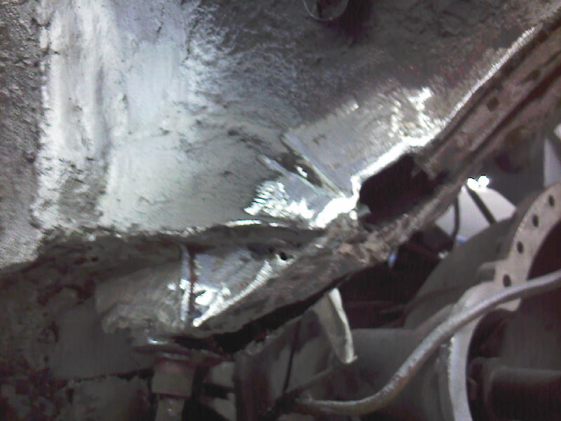

Nearside under wing welding/rust treatment finished and undersealed with added waxoil
- Photo-0177gajg.jpg (109.56 KiB) Viewed 3371 times

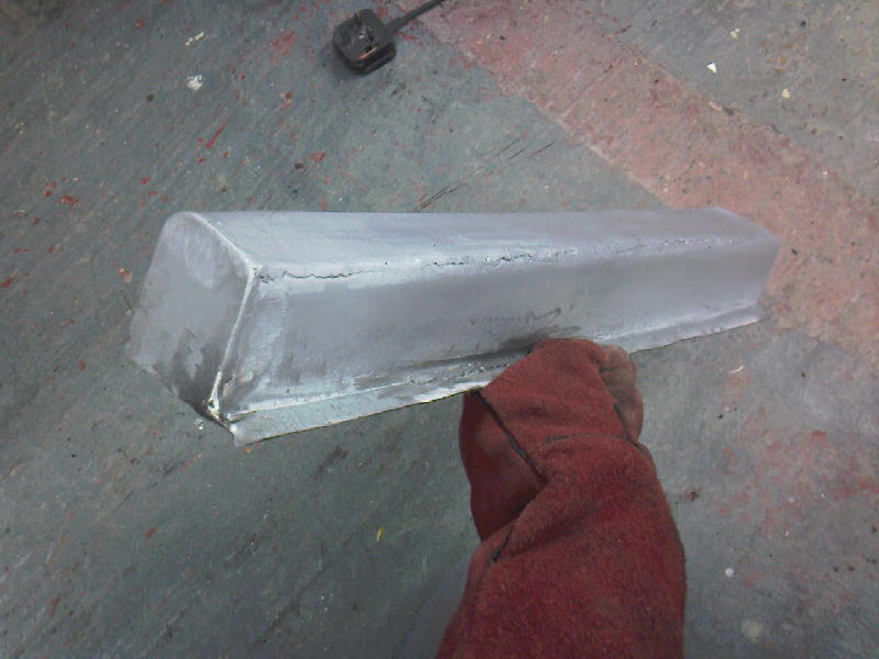

Part of a chasis rail i made up for offside
- Photo-0227tj.jpg (73.89 KiB) Viewed 3364 times

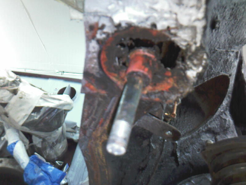

nearside front subframe mount rusted. Since welded and fully repaired.
- Photo-0263t.jpg (77.12 KiB) Viewed 3348 times

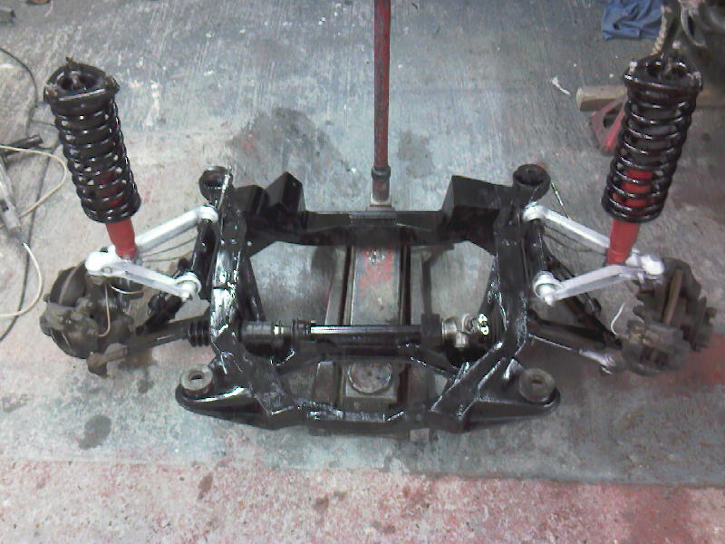

Subframe and associated parts checked/jetwashed and given a little bit of paint here and there
- Photo-0300aj.jpg (110.04 KiB) Viewed 3346 times

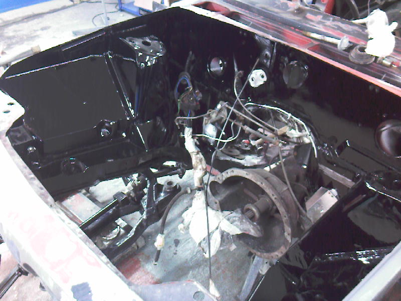

Engine bay area primed and getting ready for paint
- Photo-0291ktj.jpg (83.21 KiB) Viewed 3345 times
I sprayed engine area in high gloss 2k non metallic jet black, put the heaters on it for a number of hours then when it was fully dry and hardened I refitted subframe the next day (late xmas eve).

A small point,
is that a (Sprintspares?) solid rack mount visible in the photograph of the subframe assembly?
Alun (xvivalve) has steering racks reconditioned and reports that some cannot be used for this because they are bent. This is believed to be as a result of a solid rack mount being employed on the offside. Advice now is to use a solid mount on the nearside only.
Re: is that a (Sprintspares?) solid rack mount
Hi, thanks sprint95m for the info on the stanpart. As for the solid rack mount, to be honest i'm not sure. i havent added anything to this area since i bought it. I will take some better pics tomorrow and have a quick inspection.
