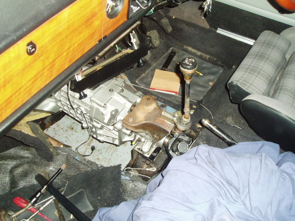

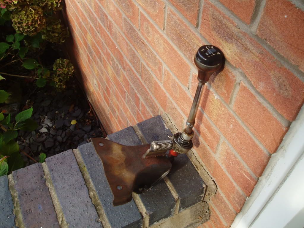

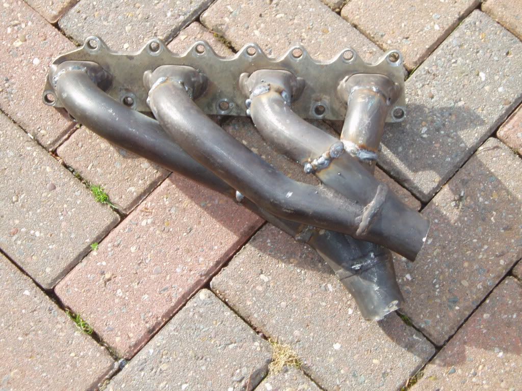

Welded the original sprint gear stick with overdrive button on to the manta gear linkage. Neat eh. It also has a short shift arrangement that I got free with the box when purchased.

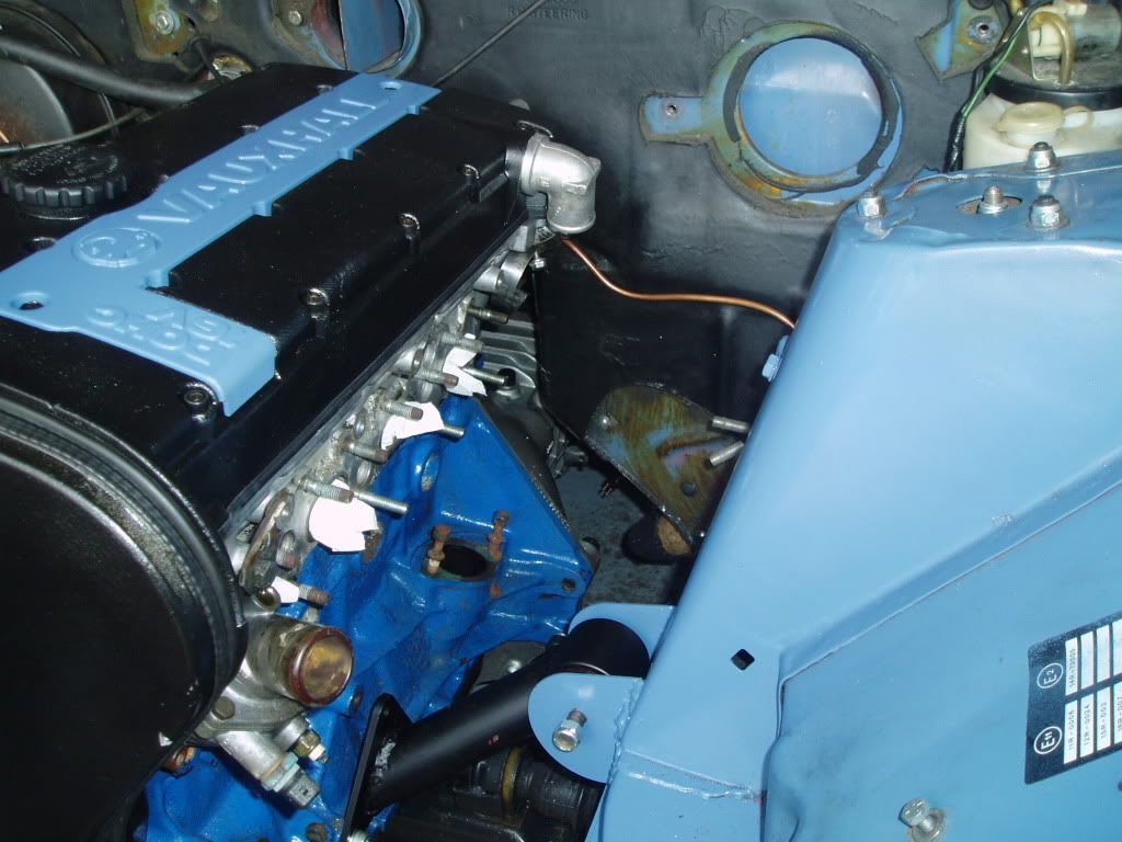

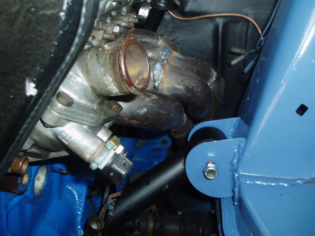

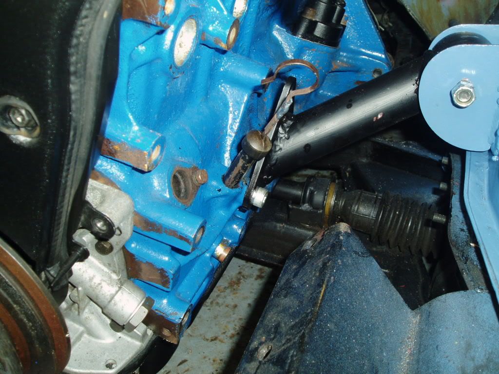

One problem is definetely going to be the exhaust manifold. Cutting and shutting the original is a no go, the manifold needs to sweep away backwards to the gearbox almost immediately or else it will foul the engine mount :( There isn't much room in there and the engine is only canted over 7 degrees.
I plan to knock one up myslef and then fit to cut down original spring downpipe. A bespoke item can then be made once the car is up and running.

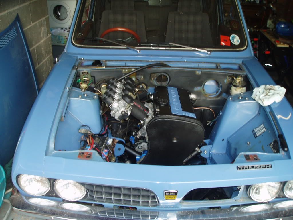

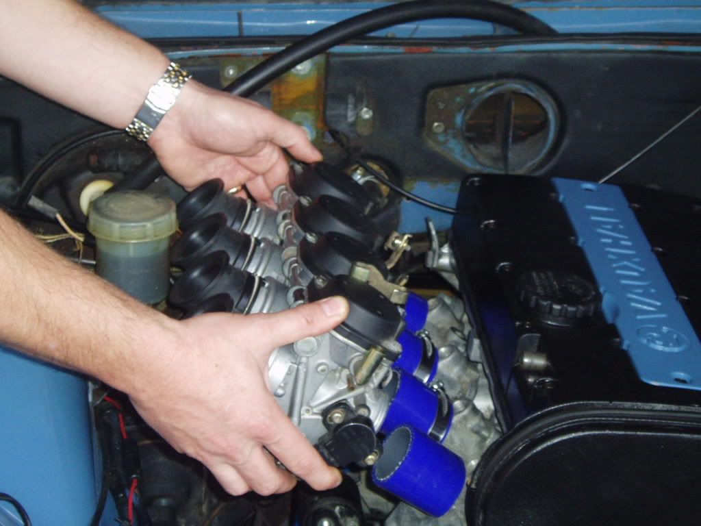

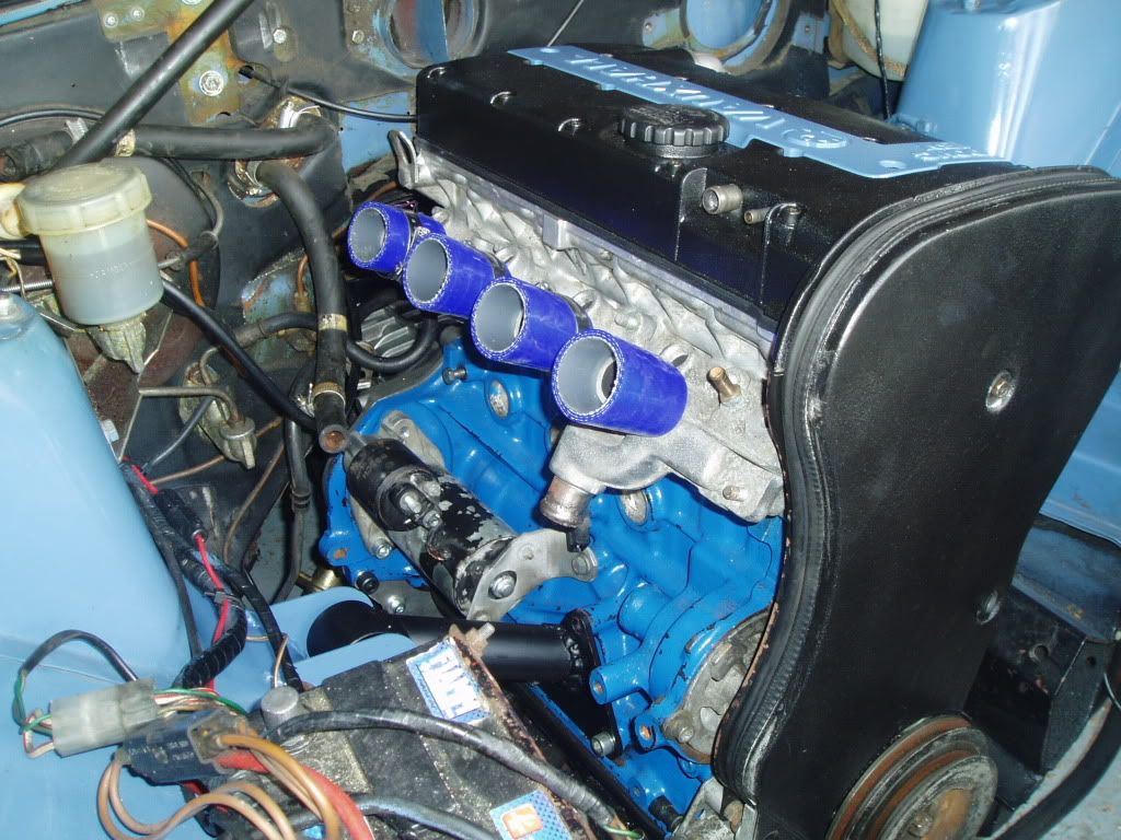

Also trial fitting the inlet manifold and R1 carbs. Ideally I could do with a proper manifold from someone like bogg brothers but they are a bit expensive at £180. The manifold will need longer flexible tubes to help match the carb centres.
Again fairly tight when you offer up the carbs but I do get benefit from the 7 degree canter. Air filters may be interesting!

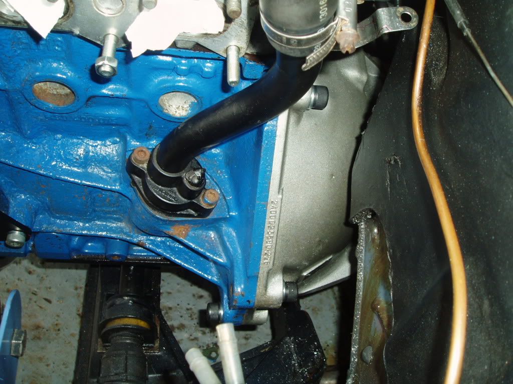

Fitted a modified and shortened oil dip stick. Vauxhall kindly provided a blank to a dip stick hole for front bowl sump applications. SImply a case of knocking the blank out fitting the tube and dipstick then welding up the original hole where the dip stick used to live.

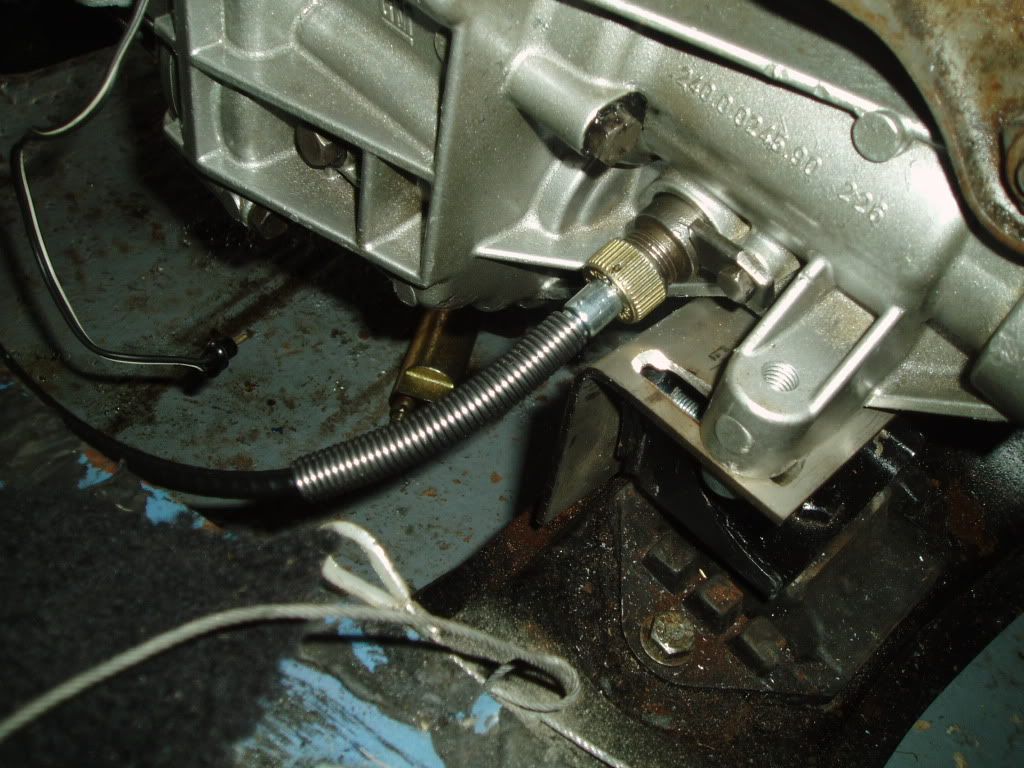

Also fitted a speedo drive. Took a new manta cable off ebay for £20 chopped the speedometer end of, carefully removed the original sprint speedometer end from the sprint speedo cable and fitted this to the manta one.

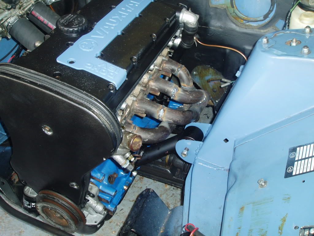

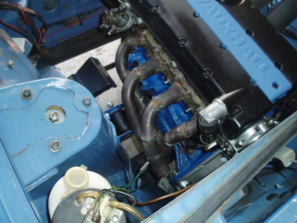

Tried fitting the r1 carbs to a chopped down manifold. Not happy with it all so I will fork out for a bogg brothers alloy manifold instead.

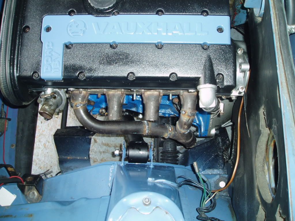

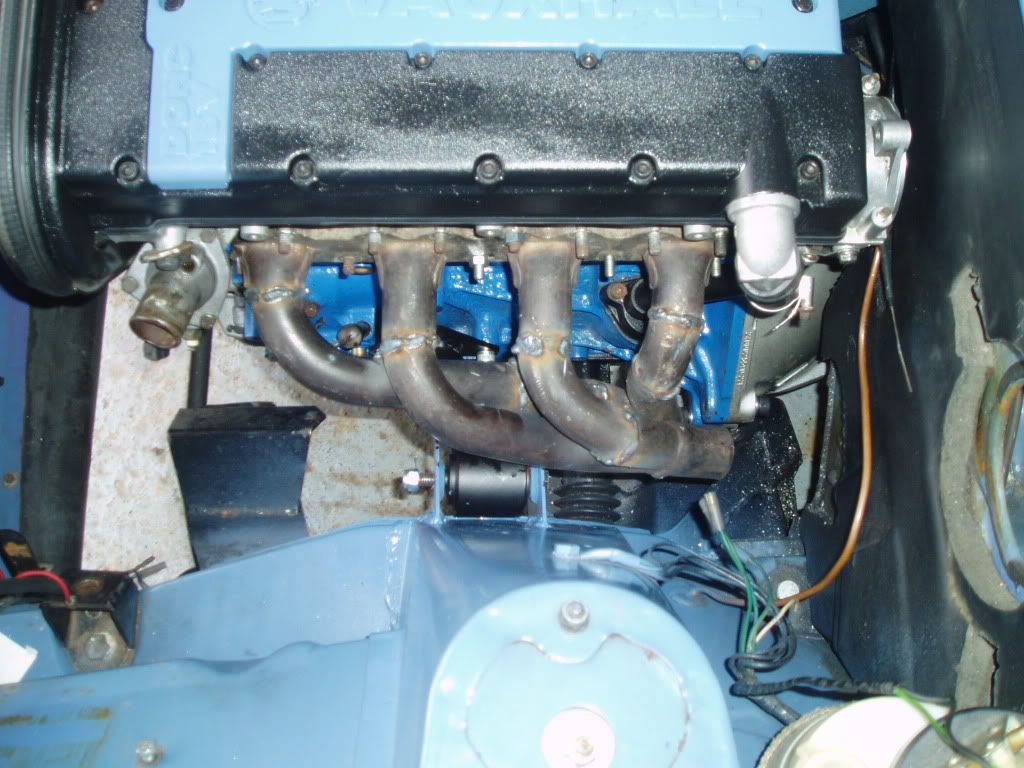

Also chopped a front wheel drive exhaust manifold up to try and make it fit for my rwd application. It wont win any prizes but should do the job until I can get the car to someone who can make a proper one. Hopefully tomorrow I will finish off the exhaust manifold.
Cheers for now

Ian, great project and one I always look out for any progress. Just a point, the exhaust take-offs should be the same linear length. The one from no.1 cylinder is a lot longer than the one from no.4.
iandollysprint
Re: Redtop sprint
#73 Post by iandollysprint »
Thanks for the hint.
Here's me thinking i'd get 300bhp out of it :D :D
It's only to get the car going though. I'll be off to someone who knows there manifolds, any suggestions. I just used it for welding practice 8)
Ian

Finished off the temporary manifold. I plan to fit with flexibles to a chopped down sprint downpipe. This will get me going I hope.

This is the part I struggled with in my conversion, I eventually had an exhaust made for me at great expense and had to cut a lump out of the bulkhead, I am still not happy with it today but think I may have found a way round it.
Looking good though keep up the thread.
