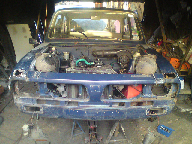

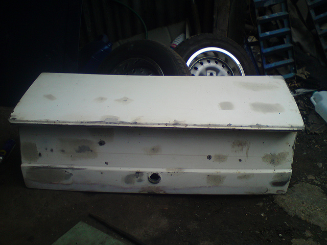

Quite a large update today!!! :D

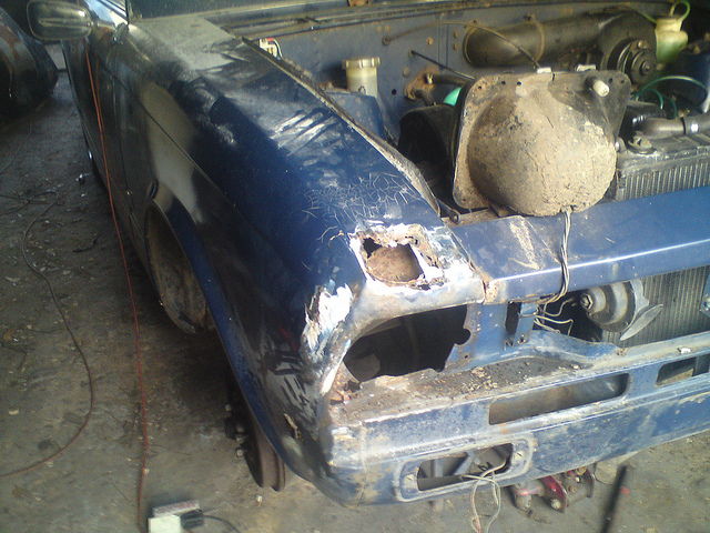

I've started on the body work, I've stripped all the area which need attention. Heres some pics...... :o

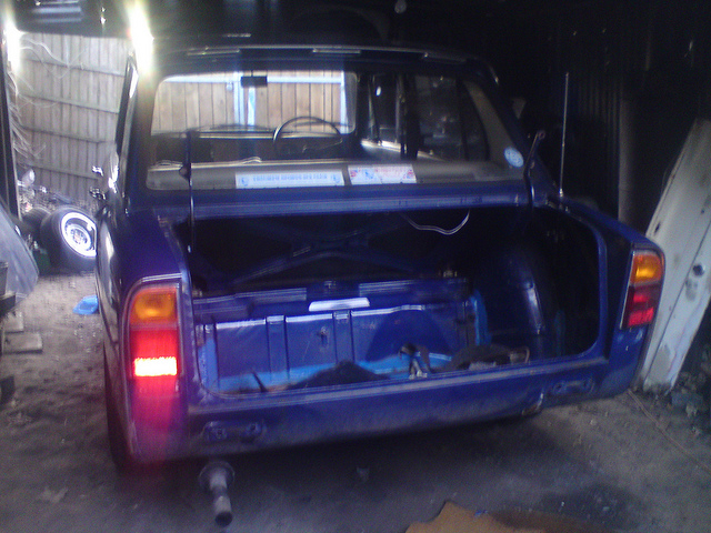

And some more..... :D

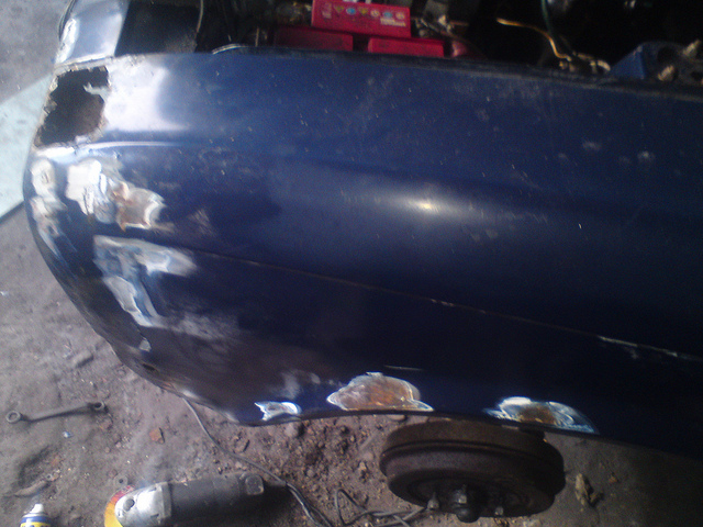

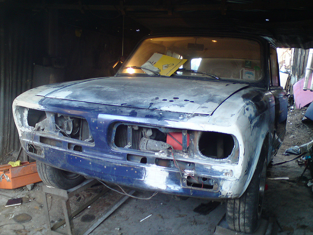

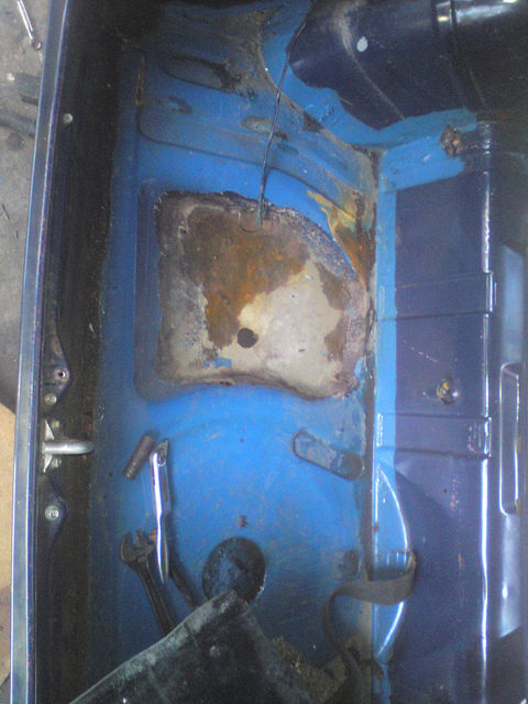

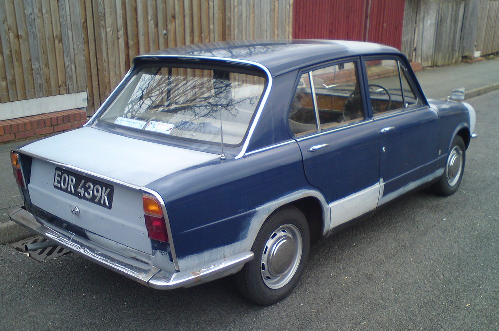

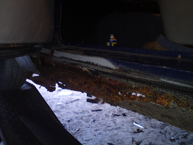

He's an Update,

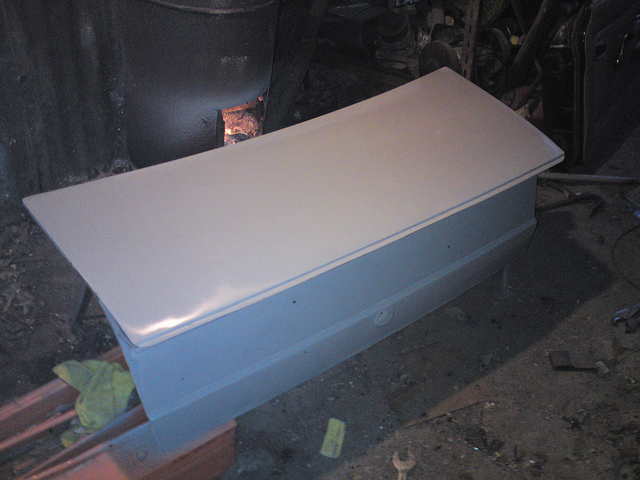

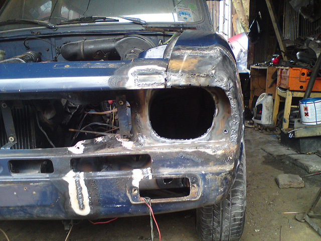

Well so far the mini resto's going pretty well. The front wings have had the old metal cut out, and little patch pieces welded in. They have also then had some light filler applied to smooth over the basic shape of the panel. The sills unfortunetly have gone from bad to worse, picture is the really bad wing, however, its all good as the other ones been repaired. The boots had its first coat of primer, and has come out pretty well. Hopefully the car should be ready for next week. *fingers Crossed*

Yup coming together nicely...
I have to say (though I am sure you know), it's not advisable to keep the car outside with just primer on it like that, primer is by it's nature porous so any moisture will be sucked into the paint and thus into the metal below, if you can put some top coat on (no matter what colour if you are planning a re-spray) then that will seal the paint and stop that nasty moisture attacking.

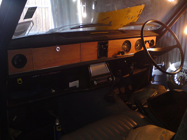

Re: Toledo 1972 Rolling Resto
#70 Post by DoloWIGHTY »
...oh I love that speaker/radio set up, looks ace. Often Toledos look as though something is missing in that area but, that simply looks spot on.

DoloWIGHTY wrote:Yup coming together nicely...
yeah, i thought that mate, Dont worry tomorow, i'll put a top coat on to pretoect it till the respray :)
DoloWIGHTY wrote:...oh I love that speaker/radio set up, looks ace. Often Toledos look as though something is missing in that area but, that simply looks spot on.
It came with the car, and it surprisingly works pretty well, However, it can only pick up BBC radio 4 and Capital Gold, Lol, I dont mind though.
