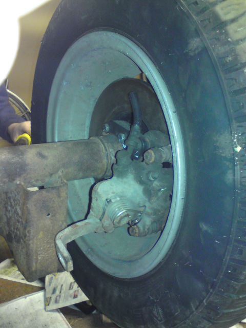

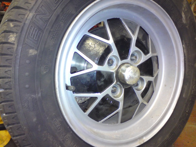

Well, here it is with a wheel on. An angle grinder with a linishing disc is the tool of choice to relieve the caliper. I took the metal down to the depth of the "Lucas" lettering or about 2mm. There's still about 15mm to go.... It would have been a lot easier with different wheels. The big thing to not miss is the inside edge of the fixed caliper carrier. It touches the axle where the wheel bearing shims are. I wish I tried them on before fitting the discs as I would have spotted it. It meant I knackered the threads on the mounting bolts (which are an odd M10 x 1mm pitch). If you have a go yourself, just offer it up and you'll see what I mean.
Still planning on keeping the balance valve, which will be great fun to set up with this arrangement!! As for the weight, if I can sneak her weighing scales into the garage, I'll weigh the differene. To be honest, I reckon it'll be a bit heavier. Only the scales will tell. The decent handbrake should more than compensate for it.

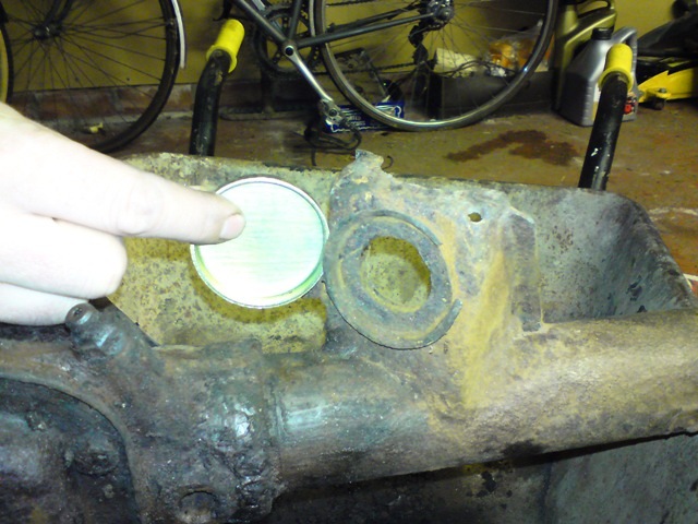

I'm shifting focus now to try and repair the corroded radius arm cups which are crumbling nicely. I hope to graft four 2-1/8" engine core plugs on instead. Getting the rear ones off is easy enough but the forward ones are bloody awkward. I can see the Dremmel taking the ride of its life.

Wiggybum, did you get those core plugs welded into the axle? How did it go?

Errrr, I've cheated a bit. Took the axle to Mike Papworth and he had a second hand axle tube in much better nick. So he's rebuilding that for me instead.
Still got the core plugs if they're of use to anyone else.

Core plugs have already gone I'm afraid. They were 2 1/8" in diameter and readily available from motor factors and even eBay.
