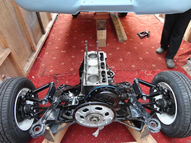

Spent last few days getting engine ready and I think I assembled it correctly with no bits left over - a good sign!
Finished spraying doors, boot and bonnet and they look good, just need a good buff up after leaving to harden for a time.
Gave garage a good clean up - doesn't spraying make a mess!!!!!
Wheels had been refurbished and had new tyres fitted and they made a remarkable difference. Only hand painted but with hub caps on there is little to see anyway.
Pushed body into garage and hoisted up high into roof leaving room for front sub-frame to be slid in on my patented wooden 'A' frame. Bought transmission down from top of garden where they were refurbished in my shed to the garage, about 40 yards and mounted onto sub-frame - God it was heavy even for two of us! Had to make a heavy plate to attach to rear of sub-fame to extend its length by about 75mm to mount the 1500fwd transmission mounting. It did not have a proper mounting in first place, just a bodge (see earlier) so fitted proper mounting and found that 1500fwd sub-frames must be longer than my 1300fwd, so extension plates made and all's well.
Carried assembled engine down from shed - just as bloody heavy, and fitted to transmission. Two problems, opened bottom gasket set (bought at auto-jumble about 12 months ago) only to find no gasket for joint between engine and transmission so had no choice but to use instant gasket and keep every thing crossed. The other problem was the two front screws that go into the front sealing block, a cast alloy 'bridge' that spans the open gap in casting face where end main bearing was machined out. The previous mechanic must have either used too long bolts and/or over tightened them so threads had been stripped. Too late to do anything so will press ahead and get engine running to check for leaks.
Connected new doughnuts and drive-shafts up and pushed the 'A' frame under the car and set about lowering the body onto the front sub-frame. This is awkward as my home-made hoist works by putting spanner on ratchet disconnecting cog-stopper and allowing the spool to unwind using the spanner to prevent it coming down at a fast rate of knots before engaging cog-stopper. Sadly, only enough room for half a turn at a time. (not the best invention, but good enough for once in a blue moon). Anyway to get to it with body in the air was to stand on a garden stool and reach across front to access with spanner. Slowly and surely the body was lowered and my friend took blocks away from under the car one by one, these were just in case of disaster until the rope went slack and I said to my friend that the body was on the sub-frame, he said it was not and that something else was stopping it. I tried to move my foot on the stool, but could not! I had lowered the body onto my foot distorting the front valance (which I had spent hours straightening out!) - surely that must hurt said my friend, but no as I was wearing shoes with steel toe-caps!!! He really helped the situation by taking a photo before allowing me the raise the body off my foot and starting again. All was well when I got my foot out of the way and body nestled nicely on sub-frame. Managed to nearly push out indent where my steel toe-cap had been and should be alright as number plate will hide it! Next step is to finish engine and get it started before anything else, just in case of oil leaks due to no gasket and stripped threads.

- Assembled sub-fame and engine with Wife's legs in background.
- DSC09616.JPG (80.83 KiB) Viewed 5018 times

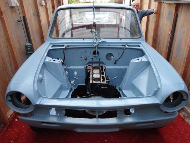

- Ready for touch-down!
- DSC09617.JPG (70.11 KiB) Viewed 5018 times
- Its in she cried!
- DSC09620.JPG (66.43 KiB) Viewed 5018 times
