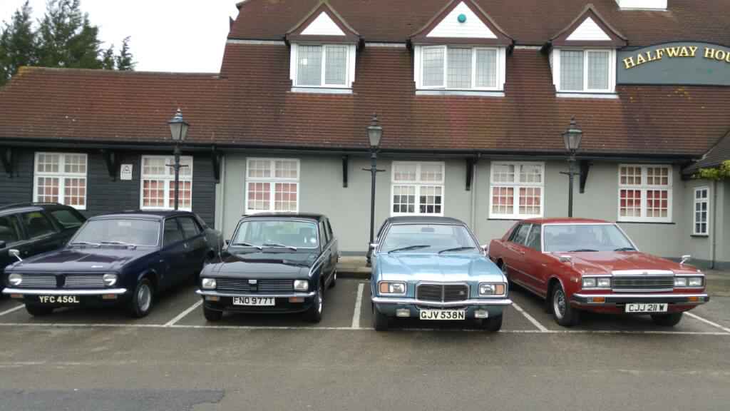

I love the picture, do you have it in colour?
Is that a VX 4/90? If so I'm sure they shared quite a few engine (and maybe brake and hydraulic components) with the 1850.
And a Toyota Crown on the far side?
Re: My first Dolly - 1979 1500 SE
Thank you. The Victor is a rare run out model (like mine) 2300S and the other car is a Datsun Laurie 2.4.
