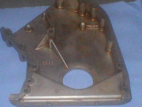

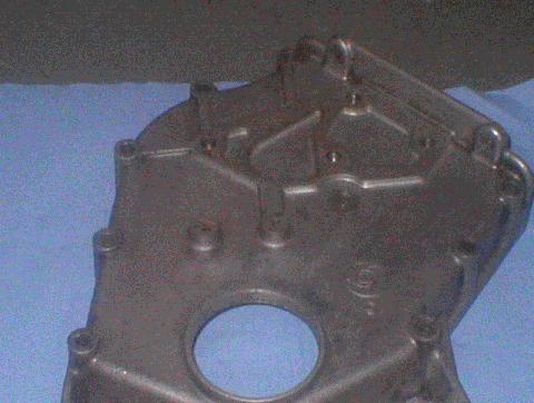

Re: 1850 gremlins
Hi Rich, This is the timing case I have here. Is this 1850 ?
- P9170003a.jpg (26.92 KiB) Viewed 2031 times
- P9170002a.jpg (28.84 KiB) Viewed 2031 times
Re: 1850 gremlins
Hi Tony, that looks like it, will double check in morning as is my day off!
Thanks Rich
