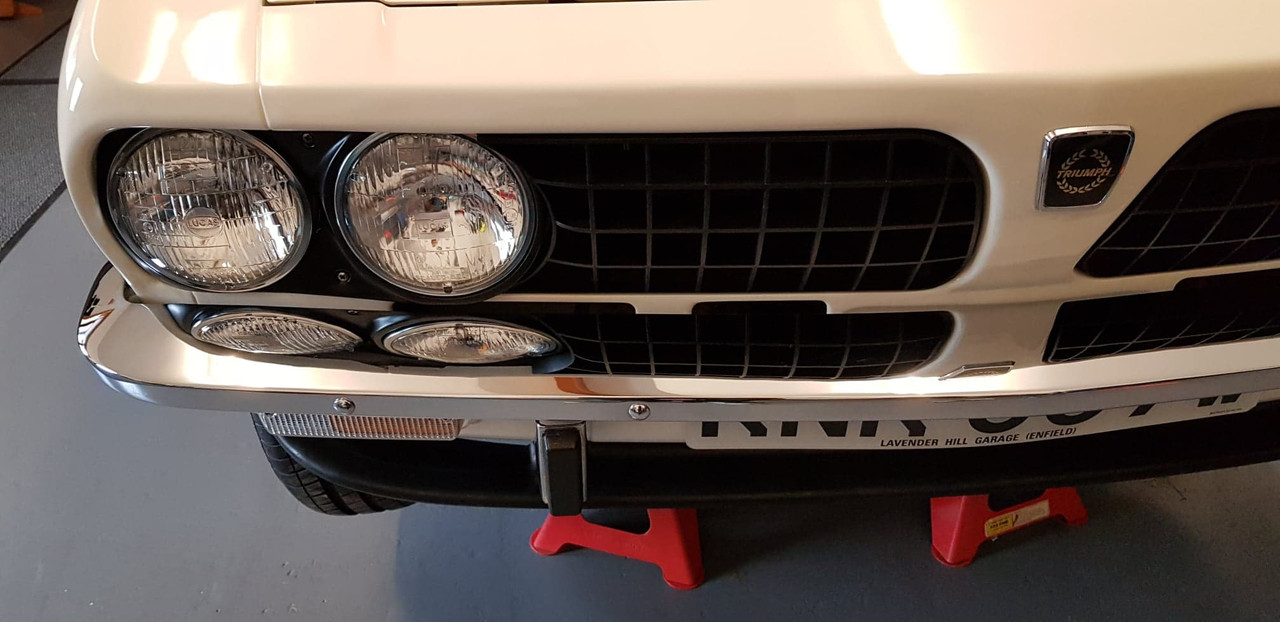

All the lights fitted, NOS indicators and headlamps, all NOS doors seals, weather seals and quarter lights seals fitted too - I was very lucky to find all those bits - mirrors are NOS Wingard ones, that's the make that were fitted to this car as I believe that varied depending on what was available at the time, one of the mirrors came from the US for just £19 on ebay, a right bargain. These parts were just too old to leave on the car - well past their sell by date and not salvageable. Front bumper was away for re-chroming at this stage, spoiler and grilles were freshly painted. I managed to find a couple of sets of mudflaps, they were fitted to the car from new so re-fitted a new set, I do like the Dolly's with mudflaps - I got all the brackets powder coated and same are made new out of stainless - all stainless UNF bolts and nuts fitted. Polished up all the chrome bits before refitting.
Bits not fully fitted to this door as decided to try and sort a factory fault, I'll show photos later. I put on the last TAX disc that Pat paid for, before his passing, it came with all the paperwork.
Testing all the lights, great to see them back on after almost 18 months.
