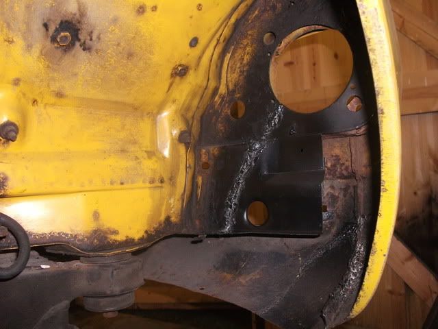

Inner front panel welded in.. I agreed with Derek that it's a shame to cut away good, original metal, so only half the panel was used. That's all the welding done now..I think!

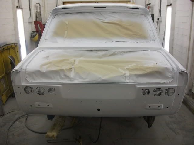

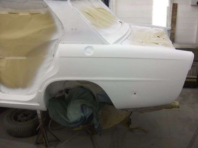

Reg's Sprint received another 2 coats of Primer yesterday having flatted back between each.
One last flatting back and the next pics should look all yellow like.
