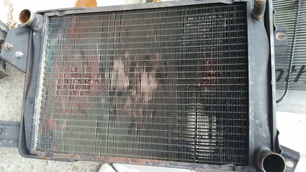

The old radiator should have been changed same time as the water pump,
Managed to make a start on some work this evening,

Looks like an 1850 rad to me, Sprint ones have much denser fins...

Alun, the radiator was changed at the same time as the engine, back in 1990'ish,
its marked Woolaston 901.
Looks like a bin job, unless its worth recycling or recore.
can actually feel the difference.

Don't scrap it. The side tanks can be reused!Mahesh wrote: Looks like a bin job, unless its worth recycling or recore.

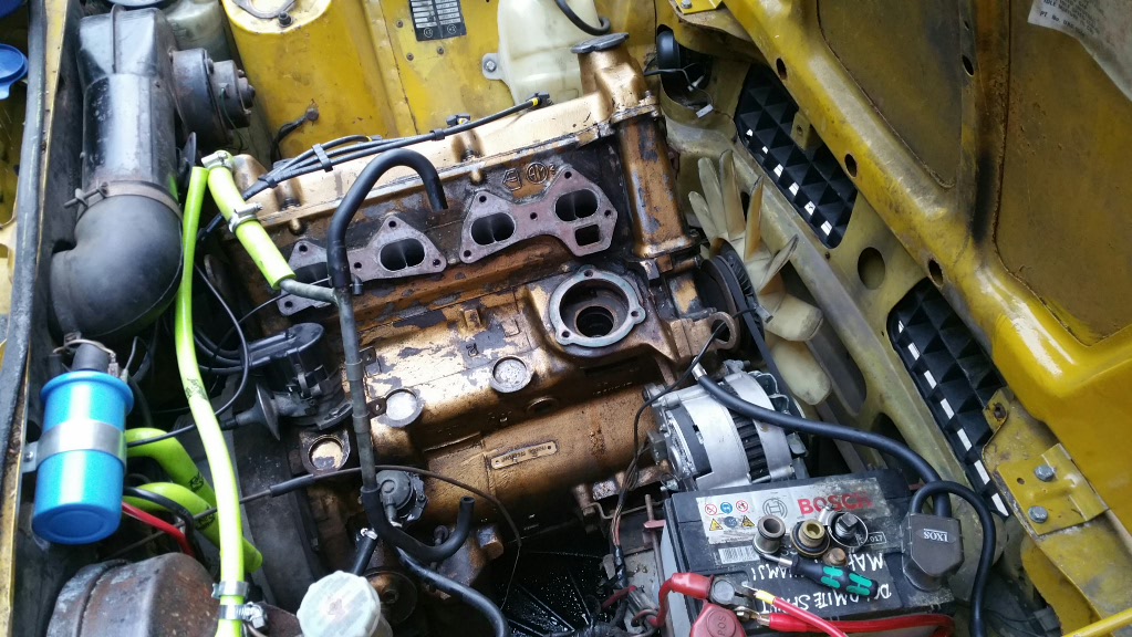

Is that an old pic or have you pulled the manifold and pump again?
Jonners, yep I've pulled out the water pump again, there is a small leak when the engine
is started, admittedly it has stopped lately but a change of O rings won't hurt whilst I change
the radiator, the O rings are slightly kinked.
Another reason is the inlet manifold has an air leak around the carb mounts, its easier to
have a good look on the workbench.
Time permitting, a coat of paint may go on.

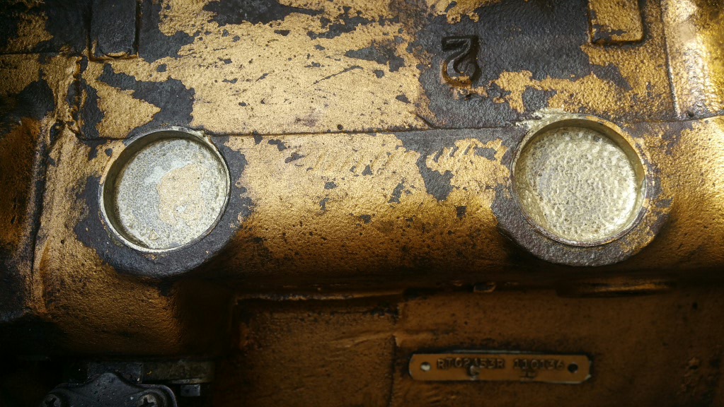

Tried some Hammerite gold on the engine, but it's too pale,
On the plus side, the new radiator is in, not much else yet,
That gold paint is annoying....especially on the alloy head.
I think I'd go for black engine enamel on the block and bare alloy on the head. I painted my block recently but it was black to start with
after I did my pump.
