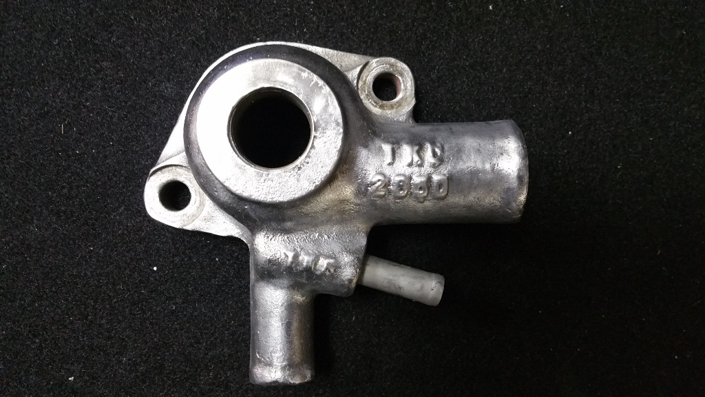

Removed the thermosat cover this morning, and yep the outlet for the expansion tank is blocked.
Upon further investigation the cause is some rust particles conducting an experiment to replicate
the process of sedimentary rock. They must have started decades ago and were very reluctant to
relocate, but after some agressive persuasion, and the promise of more space,
they have moved, to continuie their experiments in London's sewer system, where no doubt they will
be joined by much other detritus and like minded debris.
The cover will go back on tomorrow morning, weighing a few grams less, (every little helps ](*,)

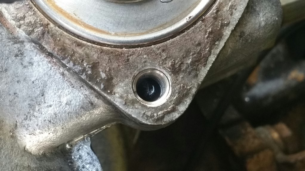

#687 Post by Mahesh »
The kit arrived today, seemed straightforward and for once it was. Opted for M8 kit, and removed the tap every 1.5 turns to vacuum the shavings out, no problems.
2016-08-16 21.03.17.jpg (173.28 KiB) Viewed 1871 times
I did clean up the surface.
Bolted the thermostat cover back, and using Jonners method of coolant refill, topped up the system.
Warmed engine up for about 40 minutes, not a drop came out anywhere :D
Temp gague fractionally goes over half until stat opens, then back to half mark.
I have a good feeling the cooling system is back to the way it should be, a good road test in traffic and open road will tell.

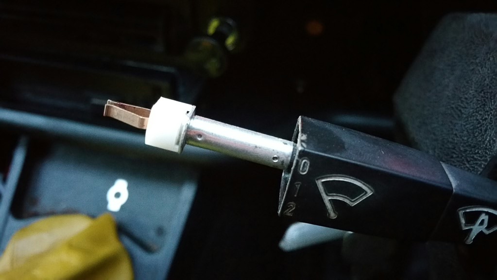

Flyfisherman wrote:
Mahesh wrote:can't seem to dismantle the push in section of the stalk to check voltage, is there a trick ?
The very end of the stalk pulls off - be careful.
Paul
Had a look today as there is no voltage at the screenwash motor,
2016-08-18 20.49.57.jpg (72.87 KiB) Viewed 2470 times
2016-08-18 20.50.14.jpg (130.7 KiB) Viewed 2470 times
There is volage coming through the end pins, so I shorted them only to find there is voltage at the motor, which was not present before
New screenwash motor it is then.
