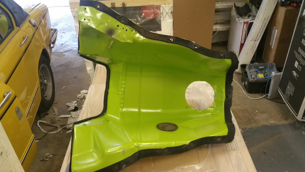

Took the tunnel out, just to make sure it wasn't dirty.
and also to change the useless new Lucas o/drive inhibitor switch.
Mahesh wrote:Took the tunnel out, just to make sure it wasn't dirty.
