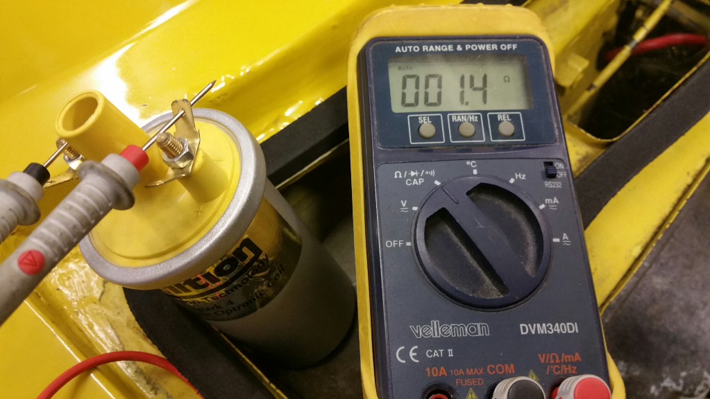

Done a resistance check across the terminals
But as I'm shelling out (eternal Dolly phrase) for a Magnetronic, I ordered a new MS4 coil, which measures 1.4 ohms.

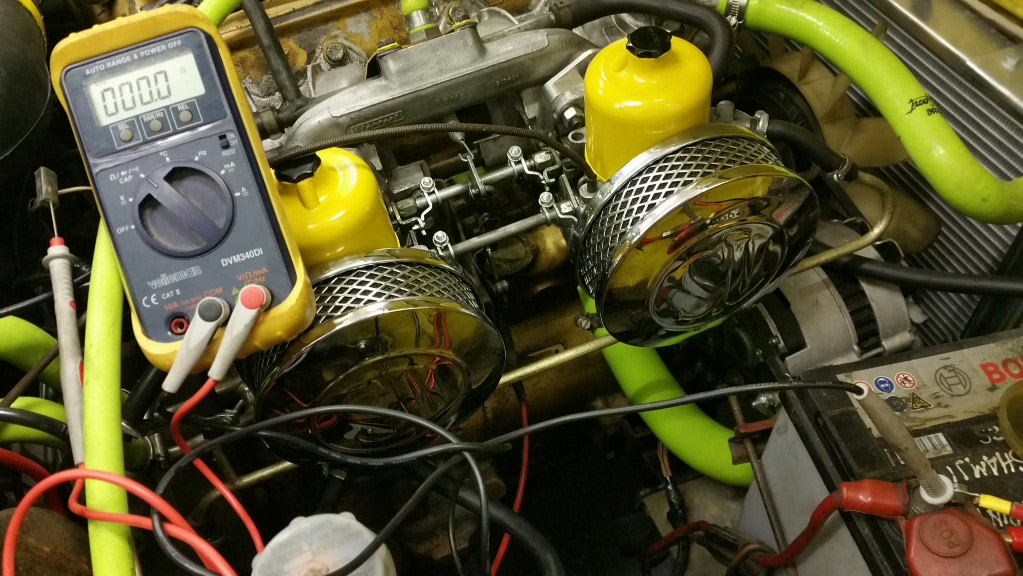

What concerns me more is the existing ballast resistor, at the +VE lead to battery positive terminal I'm getting 0 ohms, at any ign key position.
Or am I measuring in the wrong place ?

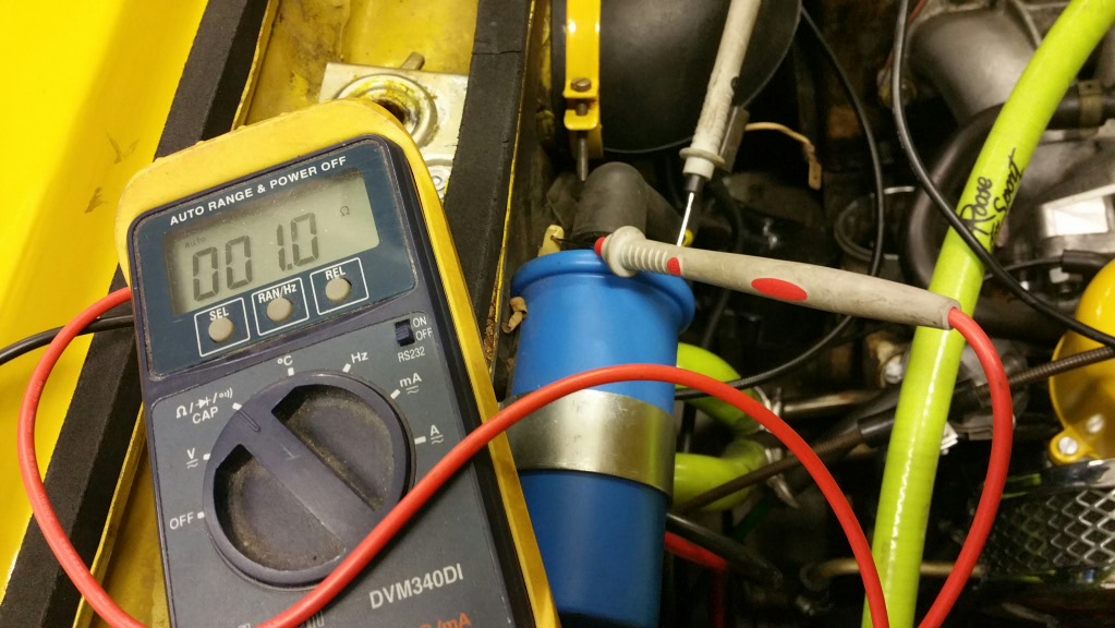

Doing a bit more checking this morning, and I found the MS3 (blue coil) removed from the vehicle
has about 3/4 fill of oil, and resistance changes depending on orientation, between 0.7 ohms to 1.3 ohms ?,
always thought the liquid inside was non conductive.
This may explain why the car was behaving differently uphill, and downhill, possibly, but no evidence of any leak.
The new coil seems to be filled about 95%, but does not change on the meter readings.

If you measure the residual resistance of the DVM leads first you may get a more accurate reading. Just short circuit the test leads together and subtract this reading from the 1.4 ohms you measured first. My DVM leads are typically 0.3 ohms.
The ballast resistor resistance can be measured from the White wire on the fuse box ( becomes live when the IGN is ON) to the White/pink wire on the coil positive when disconnected from the coil itself. This should be about 1.5 ohms
I'm not sure why its measuring 0 ohms at any key position.
That coil measuring different resistances in different orientations is definitely faulty. Into the bin !

My meter reads 0 when the probes are crossed, and my ballast resistor is at 1.7ohms.

If your picture shows the dvm measuring form battery plus to coil plus I'm not sure what you are trying to measure.
Its always safer IMHO to look at volts drop across various points to see what's going on when you have the car battery involved.
But with ignition circuits you have a lot of transients, so voltage measurement may not be meaningful....
If points are open you are looking at open circuits, so volts readings are meaningless. With points closed on a ballast system you want to see
about half battery volts at the coil plus. If you see full or near full battery volts your ballast is doing nothing, so your ballasted coil will fry.
....if you see 9 ish volts you have the wrong coil....a non ballasted coil incorrectly fitted.

Isn't the resistance of the coil supposed to be measured across the terminals with EVERYTHING disconnected? IIRC a 6v (ballasted) coil should read 1.5 Ohms and a 12v (non-ballasted) coil 3 Ohms.
Thanks Dave, Jonners,
I did measure the coils on their own (pictures further up), it was the ballast I was checking, Tony put me on the right track.
