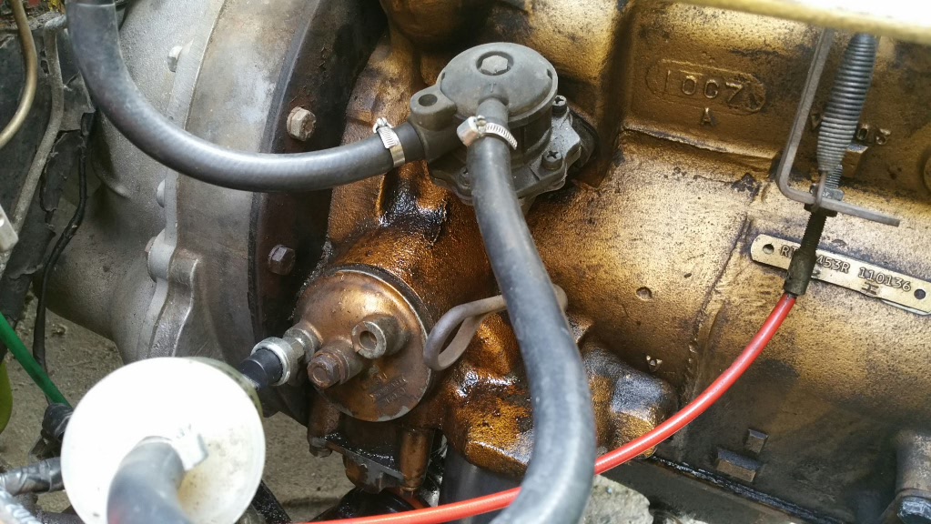

Sprung a leak, well it was there for a while, I just
avoided looking at it,
- 2017-02-21 08.36.08.jpg (199.76 KiB) Viewed 2507 times
Looks and feels like a bit of oil and petrol,
time for a new pump and gasket ?
That's a QH replacement pump which are rebuildable.
The OE AC delco ones arent without a press and some serious gear.
I'd just go for a new gasket first off....

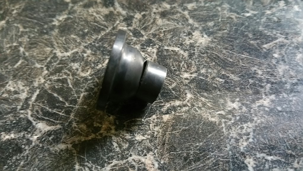

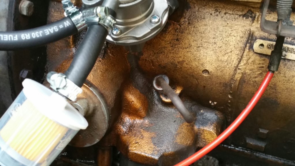

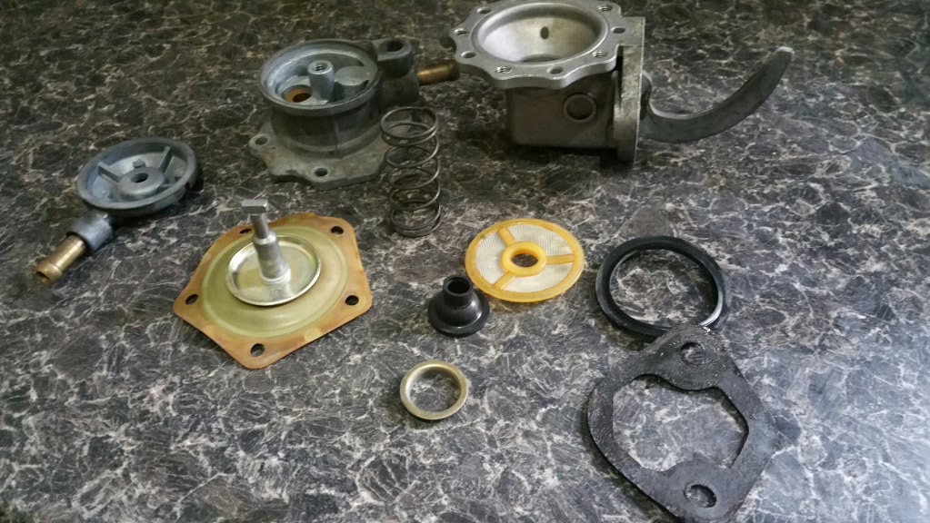

I removed the old pump and the gasket seemed to be intact.
Then dismantled the pump,
The problem seemed to be the rubber bush,
I went for a new pump, however there was still a leak,
both mating surfaces are perfect but the doubt was on
the thin gaskets.
Ordered the one Robsport has online separately to the
pump, (thicker) done the trick, so far.
the thin gaskets.

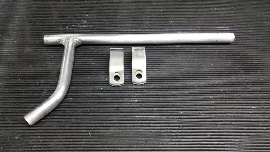

Still on only minor jobs, so I cleaned up the steel breather pipe and clips,
- 2017-03-16 09.17.08.jpg (191.81 KiB) Viewed 2361 times
