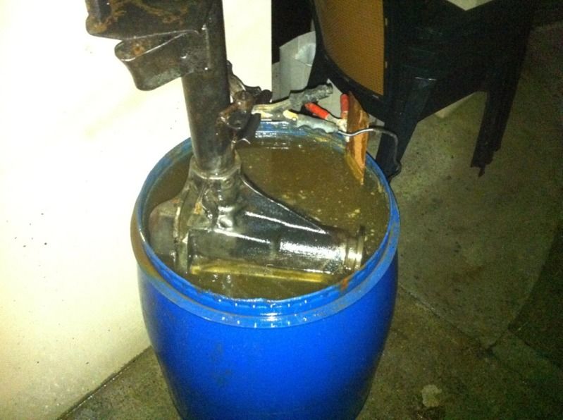

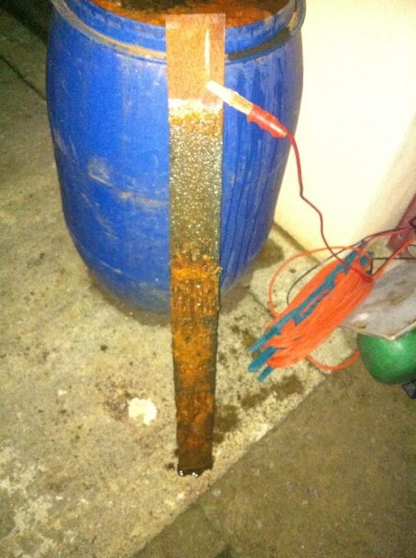

Started cleaning the new sprint axle ready for the dolly this weekend. I de greased it and and then jet washed it. Then my grandpa has been using an electrolysis tank to clean a few parts up for his gates in the garden. What an amazing thing! It's just a big tank with soda water in it. You put whatever metal rusty parts you want in it and another piece of metal in there aswel. Then you attach the positive terminal of a battery charger to the sacrificial piece of steel and the negative to what ever you want to de rust and turn it on! Amazing. Within about 2 hours the water looked like this

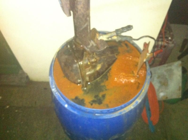

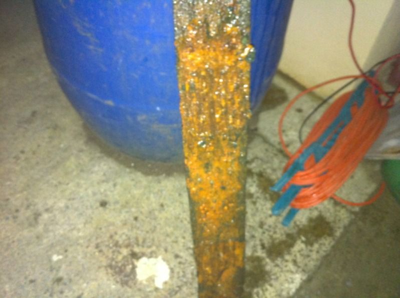

I guess that means its working. After just two days the sacrificial piece looks like this
I turned it tonight and you can see the difference straight away.
Cool! The rust you can see left on it there just washes off:) what a toy. I'm looking for things to de rust now. Unfortunately my car won't fit in the barrel

How is the orange coil connected?
Re: GUH 731W A tale of happiness then woe then more happiness
That's an old strimmer lead that's now the power lead for the charger. No need for extension leads for this one. It's built in! Haha

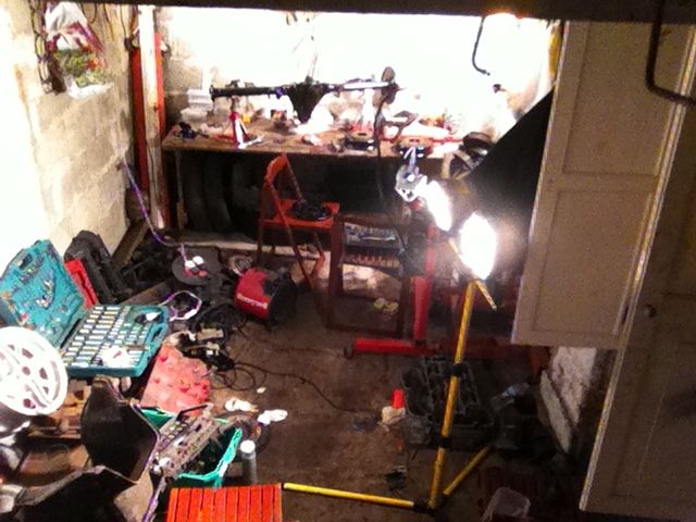

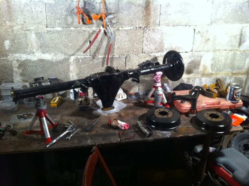

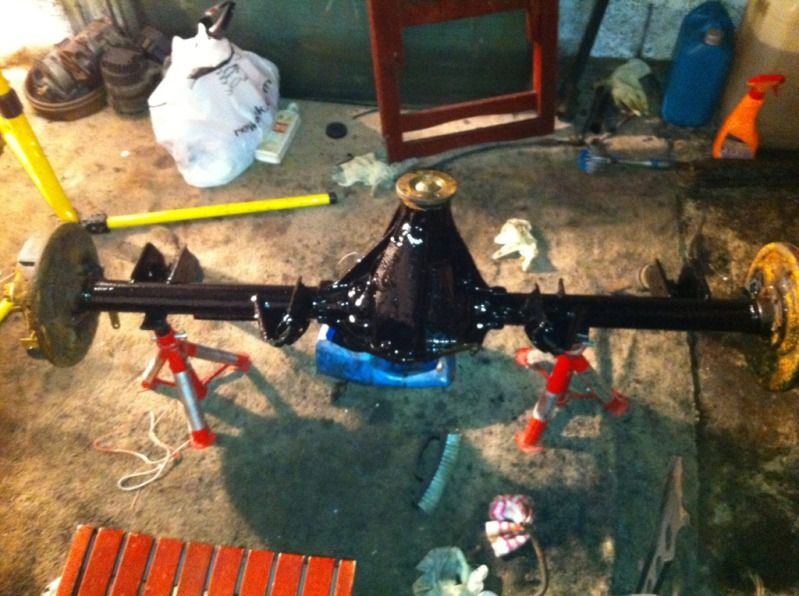

Been doing a bit more today. Set the axle up on the bench and removed the half shafts.
Fitted the new end seals. Ones from the back end of a 1500 gearbox I think they were. Can't remember now as I bought them ages ago. Need to buy one more now as one got damaged during fitting. Bugger. Can anyone confirm the part number for these seals? Thanks.

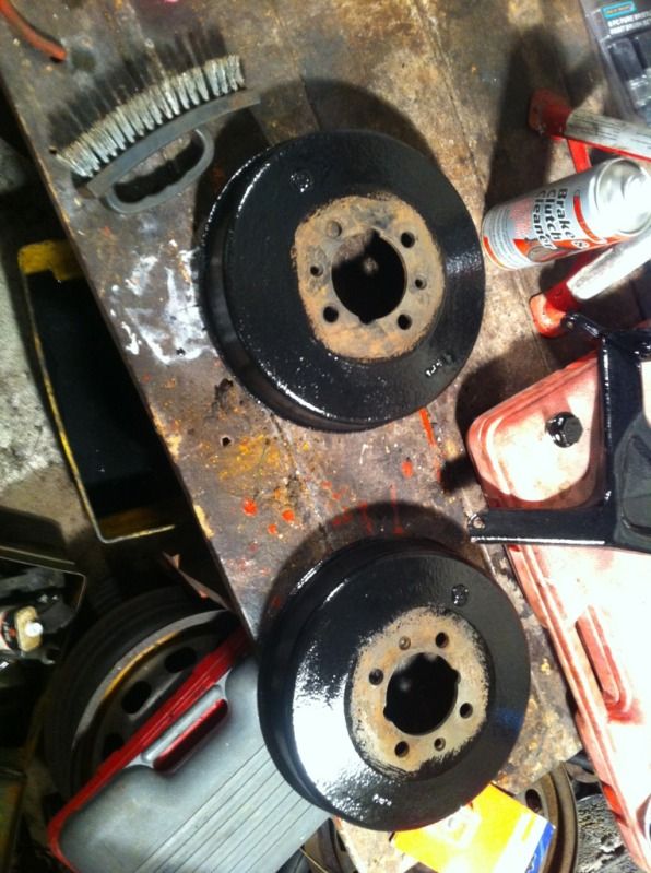

Painted up the drums and backplates ready for new shoes and cylinders.
Also painted the rear anti roll bar but forgot pics of that! Have one of the garage instead
More soon!

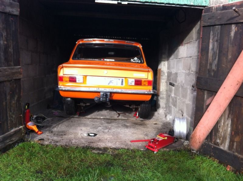

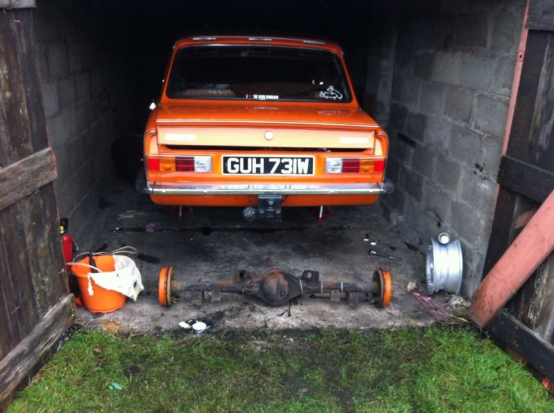

More work today:)
Got the dolly out of the garage and turned it round. Then jacked it up.
A few swear words and hammers later its off!

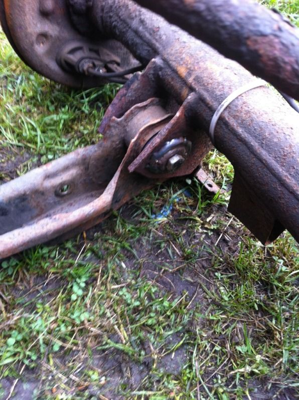

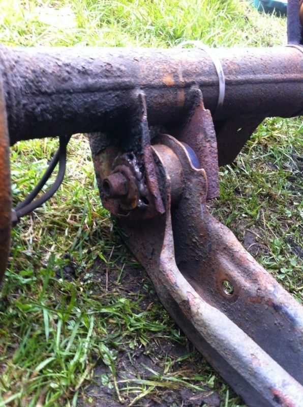

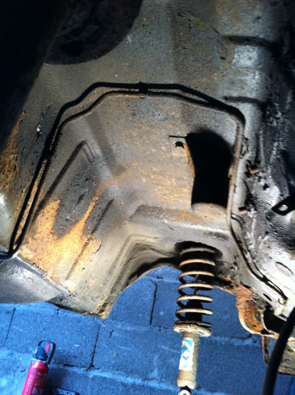

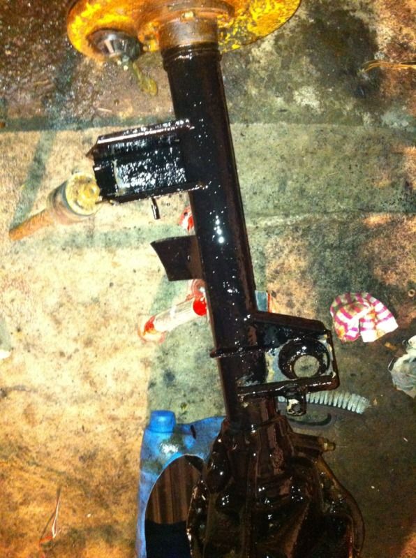

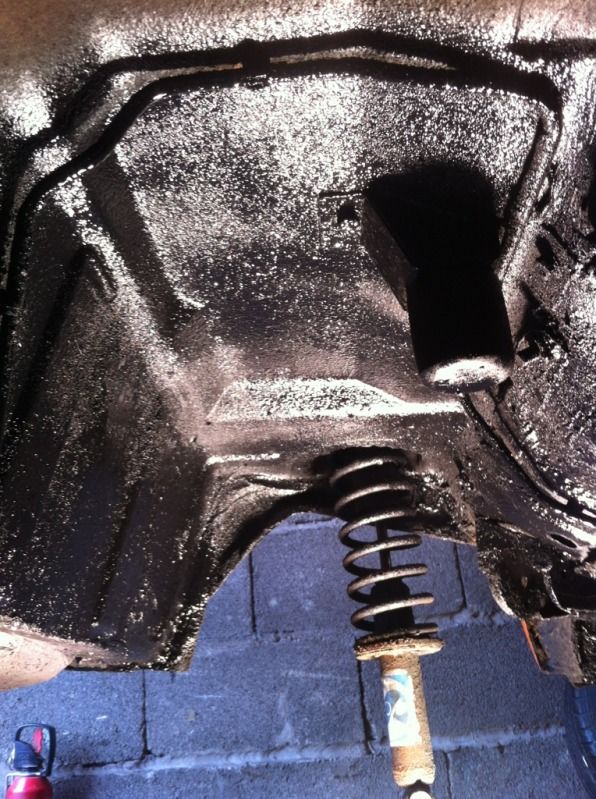

Just before I took it off the road my axle dropped. And this was the cause.
Where the big washer washer is now welded on it snapped! Rusted through. Anyway. I have tr underside a good wire brush and then stonechipped it all.
Before
And after

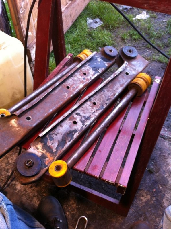

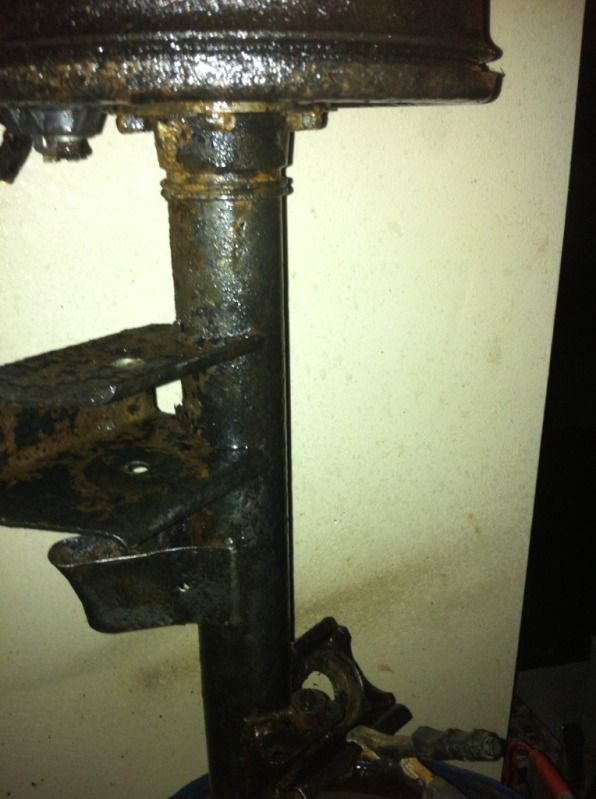

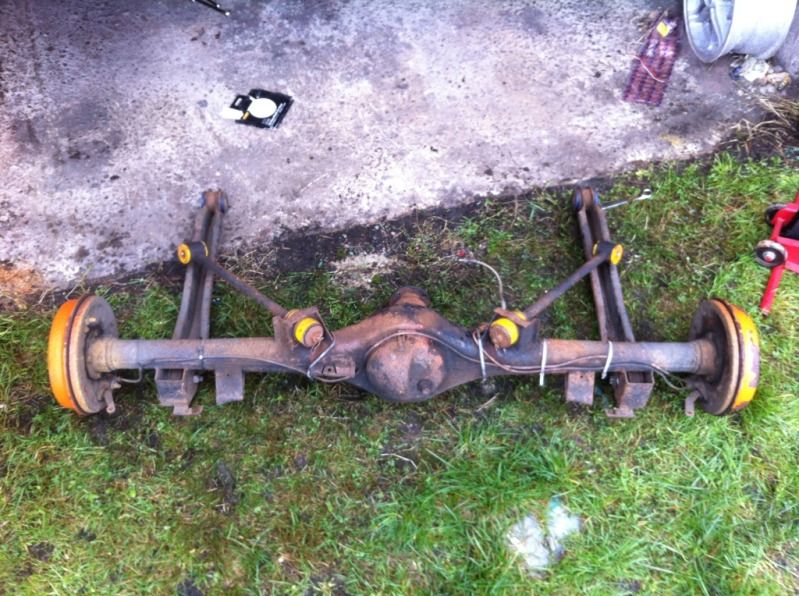

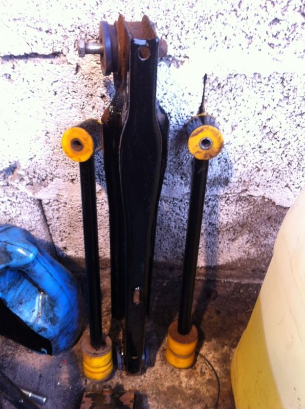

I then stripped all the arms off the old axle and set about cleaning them ready for paint:)
Before.
After knot wheeling.
And then a liberal coat of hammerite black.
And this is how I finished today.
More tomorrow when the paint dries ill finish assembling the axle and get it on.

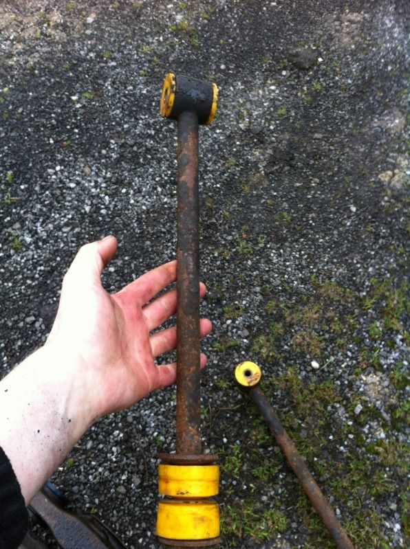

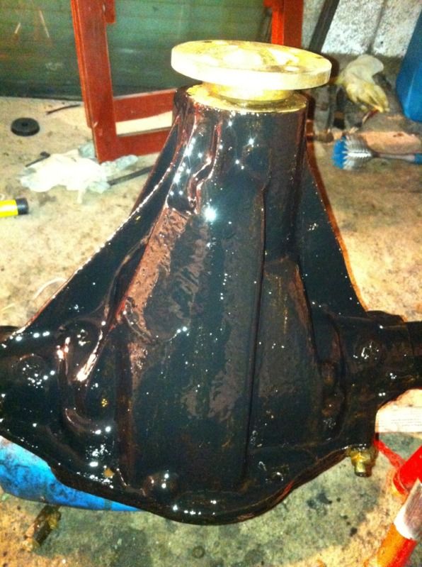

Before.
