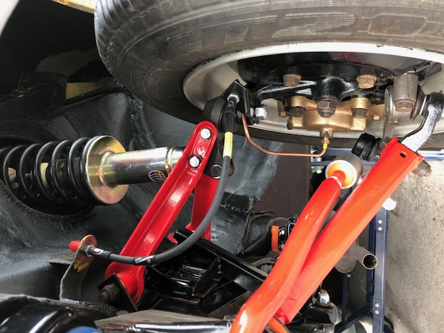

Just moved the moved the callipers to the right position, so I feel less stupid now!
Also you can see the shocks are in too.
John

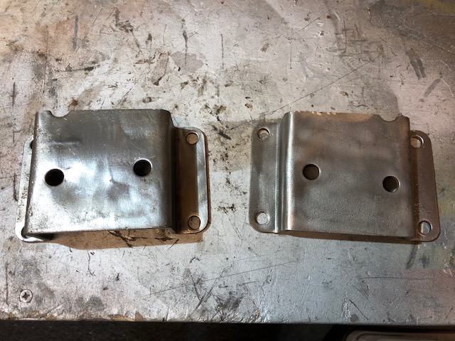

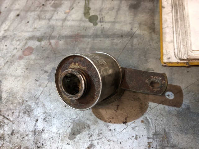

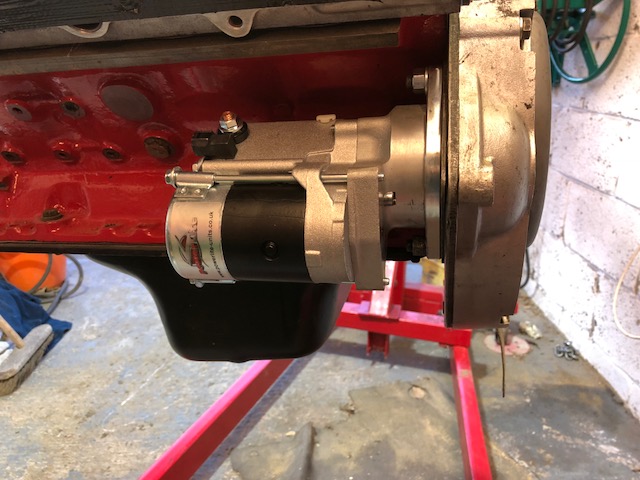

Now starting to get the engine ready, mounting brackets needed some attention so took them back to bare metal. All new mounts ready to go, it was surprising how out of shape the original ones had got. Going to fit the manifold, down pipe and gear box. I've installed the new high torque starter (does anyone know what wiring alterations I have to do) going to fit electronic ignition as easier to do now.

Engine mounting brackets are handed....
Deeper one goes to starter motor side and both have the cutout to the top.
Do you have some decent mountings?
Earth strap goes to one of the alternator side engine mounting bracket bolts too.

Thanks Jonners really helpful, saved me asking !!
Still very confused about the starter wiring only two terminals on my new starter obviously I know where the big one goes but I still have WR & WY wires ??
Sorry if I being a bit dumb!!
John
John

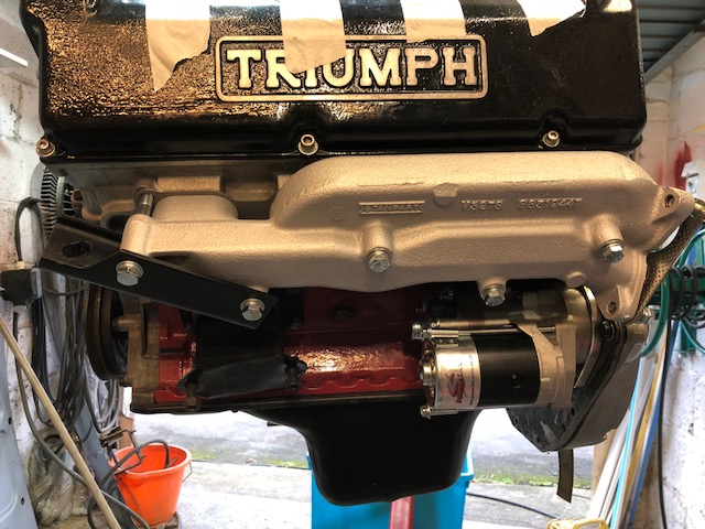

Had a spare hour so worked on the manifold and fitted the electronic ignition
- image.jpeg (92.73 KiB) Viewed 4999 times
- image.jpeg (95.61 KiB) Viewed 4999 times

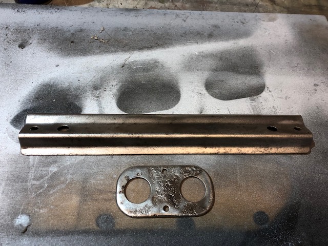

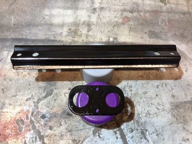

Another day in the garage, went through all the small bits and bobs so more rubbing down and painting to be done. A few more bits bolted together.

- Engine steady arm bracket looked a bit rough so back to bare metal, etch prime and back to black

One the wiring side the red and white is the ignition start wire for the solenoid while cranking and the other is the ballast bypass feed
that comes from a smaller terminal on the old starter.
If you are using electronic ignition with a ballasted (6V coil) you can arrange some other method of feeding the coil plus when cranking.
I would just go for a 12V only coil and discard the OE ballasted ignition feed altogether with a wire from the fuse box, ignition fed fuse, non fused side to coil plus.
