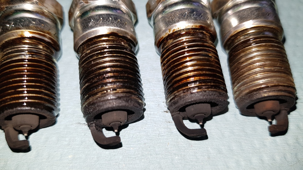

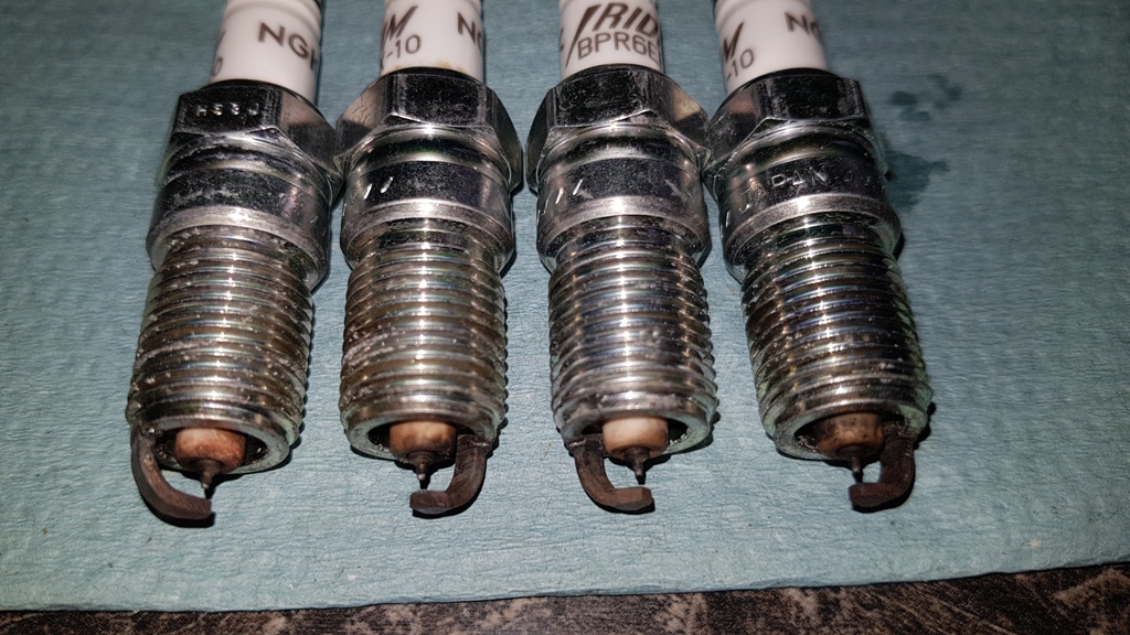

Have not done much due to flu type recurring symptoms.
But since the car was on the rolling road, the idle revs have slowly kept dropping down, probably due to warming up and not driving.
As none of the settings have been adjusted or tinkered with, and the fact there are no more
points, the only items which may differ in any way are the spark plugs.
So took them out this morning, and run them in the ultrasonic cleaner around 5 times, will put back later and see.
I know plugs are cheap, but they are NGK Iridiums at £28 a set, and I have the cleaner already, so why not.

- 20180330_083530.jpg (308.15 KiB) Viewed 13872 times
- 20180330_113111.jpg (314.65 KiB) Viewed 13872 times
Plug cleaning did not help, but putting the old BP6ES helped,
however the problem has been traced back to splitting fuel lines, again !

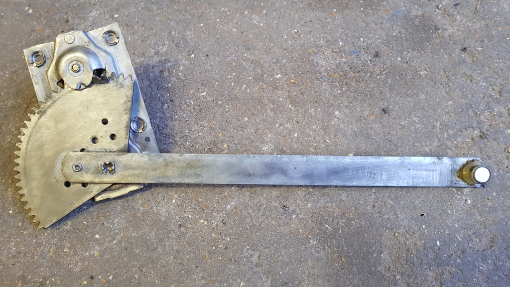

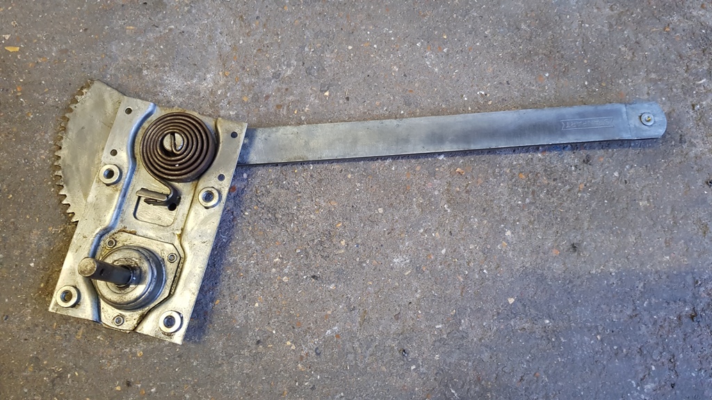

Dolomite window regulator,
- 20180419_200328.jpg (345.4 KiB) Viewed 13773 times
- 20180419_200321.jpg (348.41 KiB) Viewed 13773 times

what are you doing with the window's,are you fitting electric
Indeed, but I want to attach a motor directly to the dolly regulator, the universalnew to this wrote: ↑Fri Apr 20, 2018 2:10 pm what are you doing with the window's,are you fitting electric
kits are a bit plasticky.
The reason for the pics is, I need to see the gear to allow correct ordering of a motor,
but there were no decent pics on the net, (plenty of indecent).
Still none the wiser until I drill the rivets off and remove the crank handle box, unfortunately
the regulator Steve has sent me seems to be in better looking condition than my own, so I
will swap over tomorrow and then remove the box.

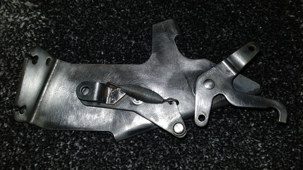

The throttle linkage has always been an eyesore, a cleanup was inevitable.

Oooh shiny, are you going to paint it or just leave as is? Coat of clear lacquer?
Have to paint it, I done clear laquer on the oil filter, and it has not lasted even withyorkshire_spam wrote: ↑Sat Apr 21, 2018 10:30 am Oooh shiny, are you going to paint it or just leave as is? Coat of clear lacquer?
the sump protector plate.
Take a look at a Panther Rio door, they extended the arm rest to cover an external motor over the standard handle spindle, and incorporated the switchgear in it too.
Mahesh, check out triple tango's Sprint thread HERE. He fitted electric windows and the some of the photos show how he fitted the regulators to the doors. I've just fixed all the Photobucket links so you shuld be able to see the photos.
