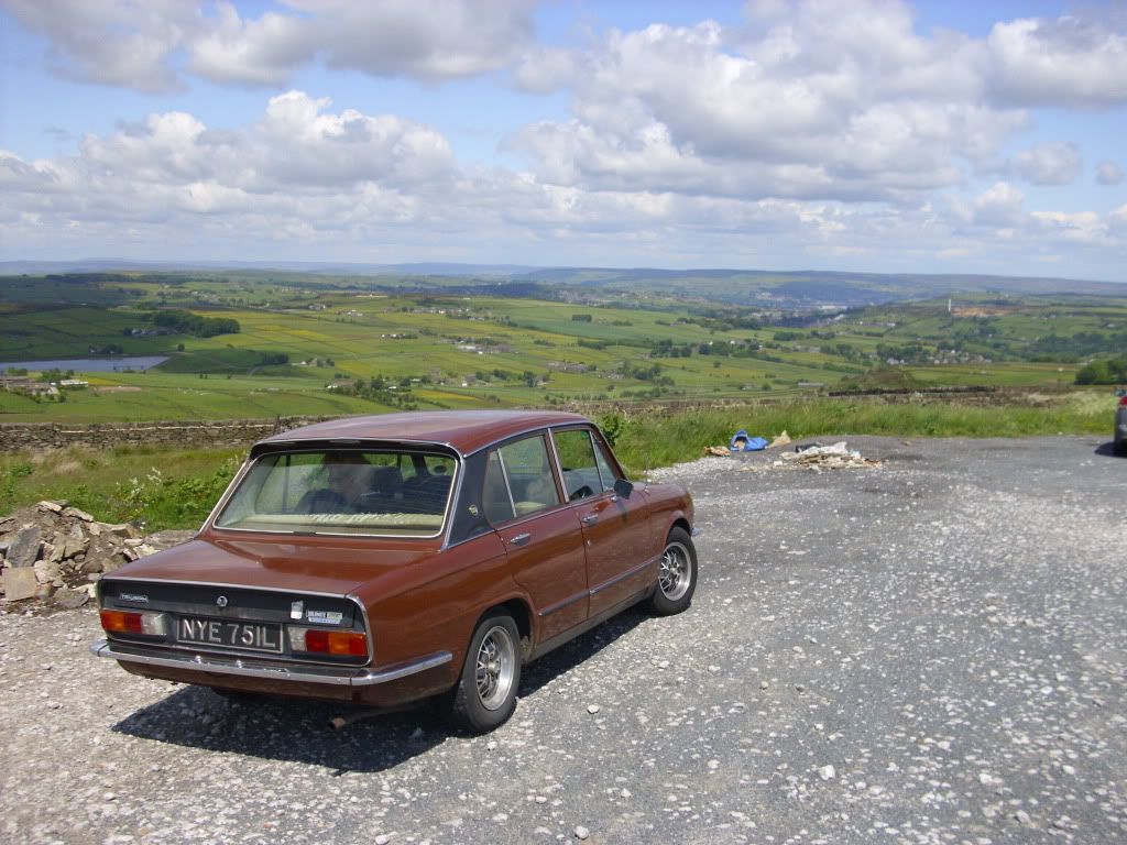

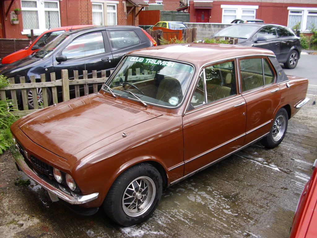

I'm now starting to actually enjoy the car so all I did today was to wash it by hand using the 2 bucket method.
Next after filling up with petrol I went for a spin round the local moors. The pic below is the view towards Haworth coming from Hebden Bridge along the A6033.

What's that Sprint badge doing on the back? :P
Looks lovely 8)

OK, OK, so I put Sprint badges on Brown. As some of you may know I've already lived that dream and Brown is the replacment car. I've always said that the 1850 is the next best thing.
Well spotted Howard.
