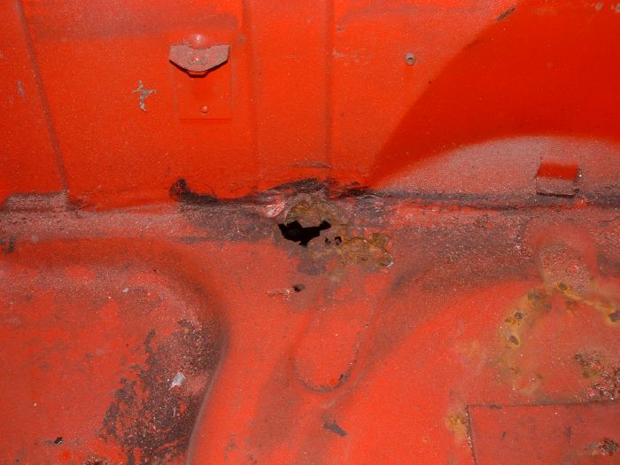

Ken is correct. But the main reason I do it is because you just don't know what's under the paint. You can see a few examples in my previous resto threads. Take the last resto, VHK, the rear panel looked fine but once I started to remove the paint it became obvious there was a lot of filler underneath and indeed it needed a new rear panel. Also look at the PUS resto. The paintwork on the 1500 I used for the reshell looked really good. But when I got to the left rear passenger door, a half inch thick slab of filler was hiding a nasty dent that could easily (and was by my sprayer) have been pushed out.

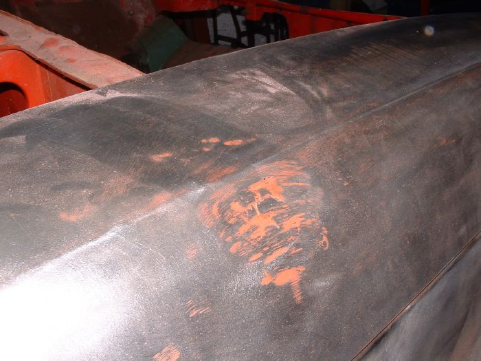

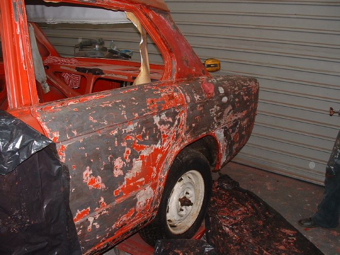

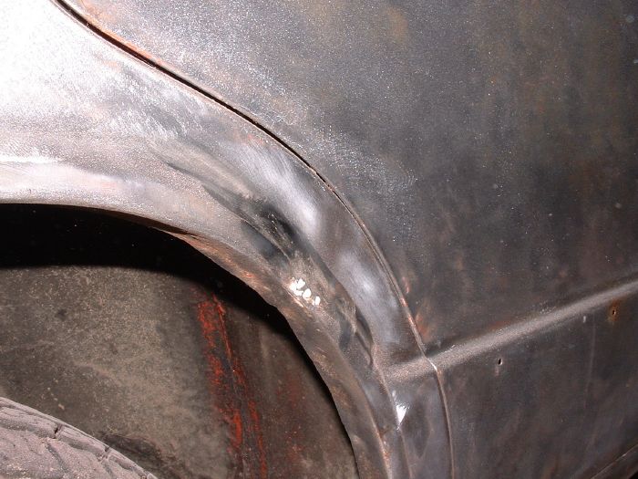

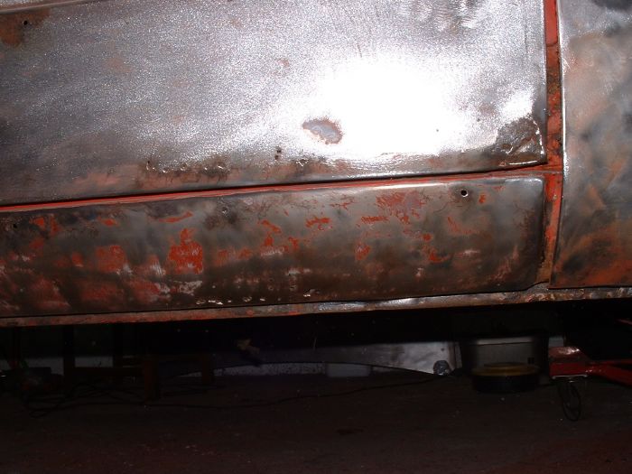

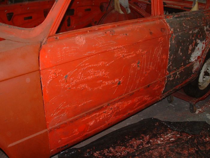

Now I need to insert a caveat here regarding the paint stripper. If you put it on paint which just has a primer under it, it works pretty well and peels off. But, if you have filler of any type under the paint it's still a bit of a pig to remove, ask Mary. You may have to do it two of three times. On the pics below the front door has just had the plastic removed and as you can see, not a lot of the paint has peeled off. The pic of the rear door is the best we could do after one coat of stripper. We applied another coat and got a bit more off but then I moved in with the knotted wire brush to remove the rest.
The main reason I use paint stripper is because it makes a lot less mess, not necessarily because it is quicker. When I stripped JYD I used sanding discs and the dust got everywhere, about an inch deep in places. :lol:

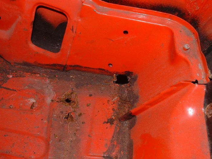

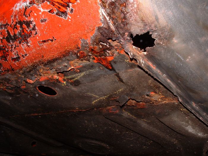

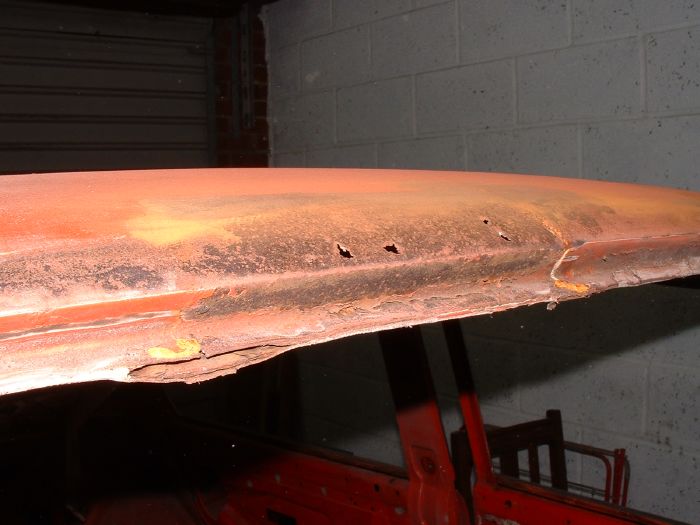

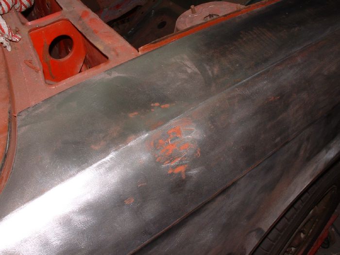

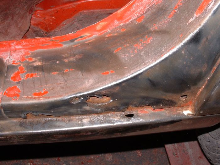

Pics of the bad bits so far...

Looks like you got off lightly. The wisdom of stripping the paint off has been clearly demonstrated.
MalcGE
#93 Post by MalcGE »
Excellent progress there Mart. Shell looks very solid, surprising given the last few years have not been its best, although having said that it has avoided the road muck. A couple of unusual rust spots but all very fixable.
Have you tried scoring the surface of the paint, with say a 60 grit oxide paper, just quickly to break the surface a bit and allow the stripper to get a bit more of a hold before bagging it up

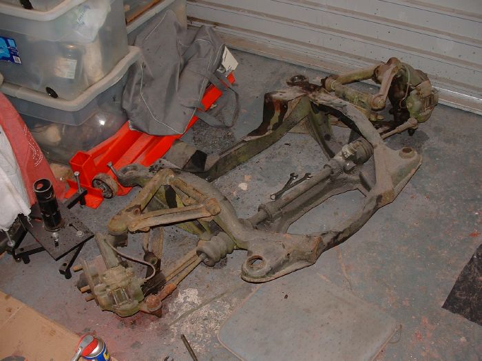

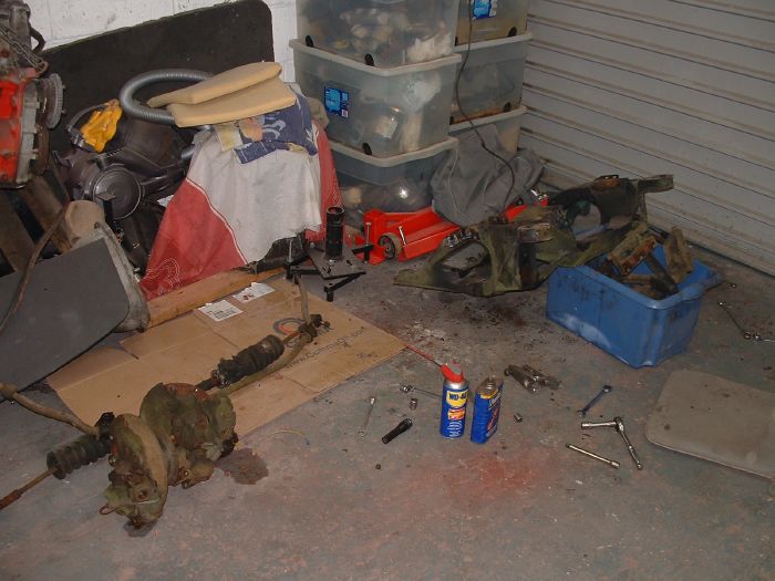

Fed up with body work (and the fact I've blown up my angle grinder) I decided to strip the subframe down to free up some space in the garage. It's looking a bit green where it's been stored outside, I expect. Looking at the rear mounting positions it looks like I need to fill those holes a bit.
It didn't take long to strip it and a bonus was that I managed to undo all the ball joint nuts without them spinning. If you are doing this, loosen all the bolts you can before taking any parts off. Sometimes it helps if the part you are trying to undo is anchored at the other end.
The steering rack joints are very loose so probably a candidate for Alun to get refurbed. Luckily Colin has provided me with what looks to be a refurbed one. :D

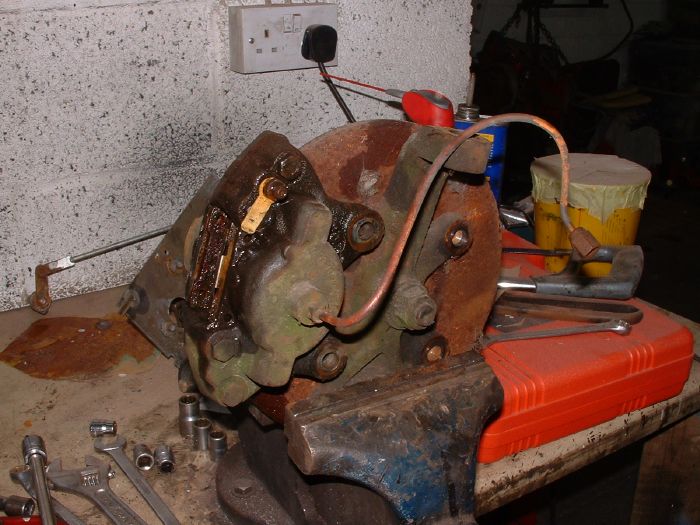

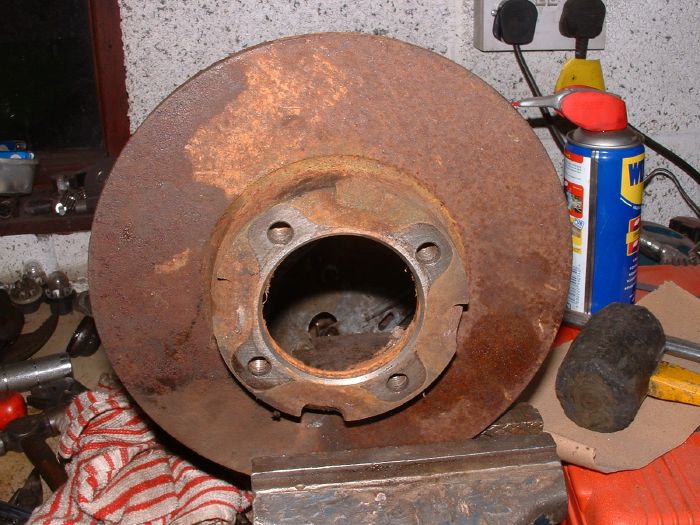

I then felt like doing a bit of bench work and started stripping the front brakes. The pads were well & truly seized to the discs and needed a bit of persuading with a hammer & chisel.
Although the discs have quite heavy surface rust, there doesn't seem to be any wear on them so maybe they are new?
I'm trying to remove the pistons from the calipers but they are stuck solid. I've tried compressed air but that does nothing. I usually manage to tap them out with a screwdriver and small hammer but they seem to be well and truly stuck. Any suggestions?

Mart, try a grease gun to shift the pistons, or bolt a clutch master to the bulkhead and connect to the Caliper, get some hydraulic force behind them. Dump them in a tub of diesel for a couple of weeks beforehand.
Posts: 13575
#98 Post by xvivalve »
...or with refurbed calipers now down to £37 each, just swap them for ones that have been done ;-)
Purplebargeken
#99 Post by Purplebargeken »
^^ wise words mate. Save faffing around.

#100 Post by Norwegian sprint »
Mix water / caustic soda. This is the best paint/rust remover you get. Also work as perfect rubber renewer.
Drop your calipers ( and other part you like to strip down to bare metal) in the water / caustic soda mixture. Leave i over night.
This is what i use in my ultrasonic washer, just for speeding up the process.
Heat will also speed up the process, 60 degree celsius.
IT IS AMAZING :D

Norwegian sprint
#102 Post by Norwegian sprint »
Edin Dundee wrote::) What ratio of water to caustic?
50/50 is what i use.
Before / after pic.
Posts: 8529
#103 Post by Mad Mart »
50/50 is a hell of a lot of caustic. Did this unsieze the pistons? I assume it didn't damage the caliper bores?
Norwegian sprint
#104 Post by Norwegian sprint »
Mad Mart wrote:50/50 is a hell of a lot of caustic. Did this unsieze the pistons? I assume it didn't damage the caliper bores?
Sorry.....50/50 is wrong, that is the mix of my aluminium cleaning bath.
I did use 1 can/bottle of caustic in 10 liter of water.
The solution last almost forever, used mine for 2-3 year now. Only refill water.
The caustic do NOT damage steel. Only remove rust/paint. Only strip back to bare steel.
On my calipers, the piston was stuck. After caustic bath, the piston just glide out using hand power.
Also rubber go back to "fresh as new" softness.
It is really is amazing......i use it as "washing water". Drop dirty bolts and stuff in the bath for 5 minutes, take it out as new.
.......well........it also remove plating.....so back to bare metal. :wink:
Posts: 8529
#105 Post by Mad Mart »
Great, I'll give it a go tomorrow as I'm out of caustic soda.
