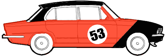

Next item to address is paint, the fronts all primered up from a minor prang I had in the car, this has given me the opportunity to go for a race-style livery, what do you guys think of this? Photo is what I mocked up on PS
The car is slowly being pieces back together, although not with the parts in mind being fitted due to lack of funds, a wedding will do that too you
Once I get the head gasket kit ordered, I'll be trying to piece together a 4-1 header for the updated cam that I want to use, the set ahead fitting the whole front end together, MOT, then I'll be done.
