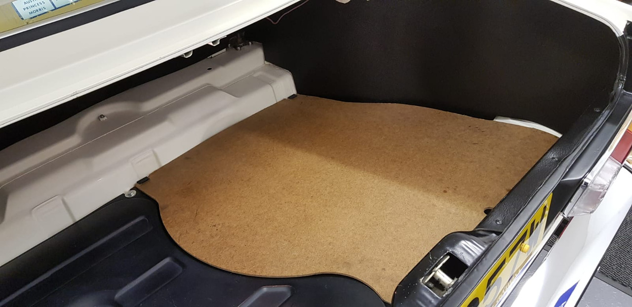

A boot clean and everything back in, there wasn't much to do, I gave it a good polish. The spare wheel has never been used, I had Aldridge Trimming make the new mat, which is in the original material - they made a perfect job.
There is one thing annoying me, when the spare wheel is in it does raise the wooden cover slightly, and I can't work out why, any ideas?

It's because the spare wheel well was designed to accomodate a 4.5" wide wheel exactly! They weren't going to redesign the boot floor and retool to accomodate the 5.5" Sprint alloy wheel, the accountants would have a fit!
I suppose, thinking about it, the clever thing to do would be to have made a Sprint fuel tank that was an extra inch taller, that would give a longer range to the flagship model too! I guess the purse strings wouldn't even stretch that far!
All Sprints are like this!

Thanks Steve, that explains that then.
