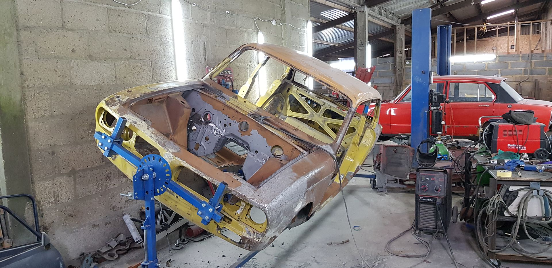

Welding nearly finished.
Maybe another week or so then off to paint :jump4joy:

Great progress Tony. I see another Dolly graces the workshop too.
Do the same team do the painting or does it need to be moved?
