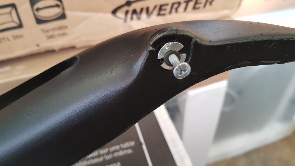

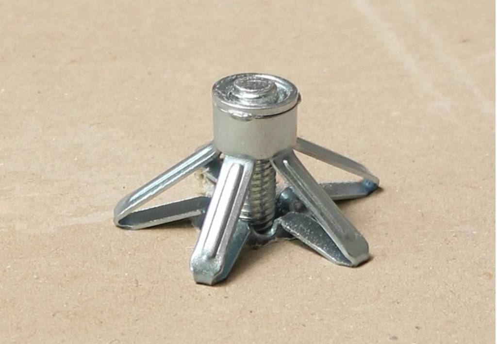

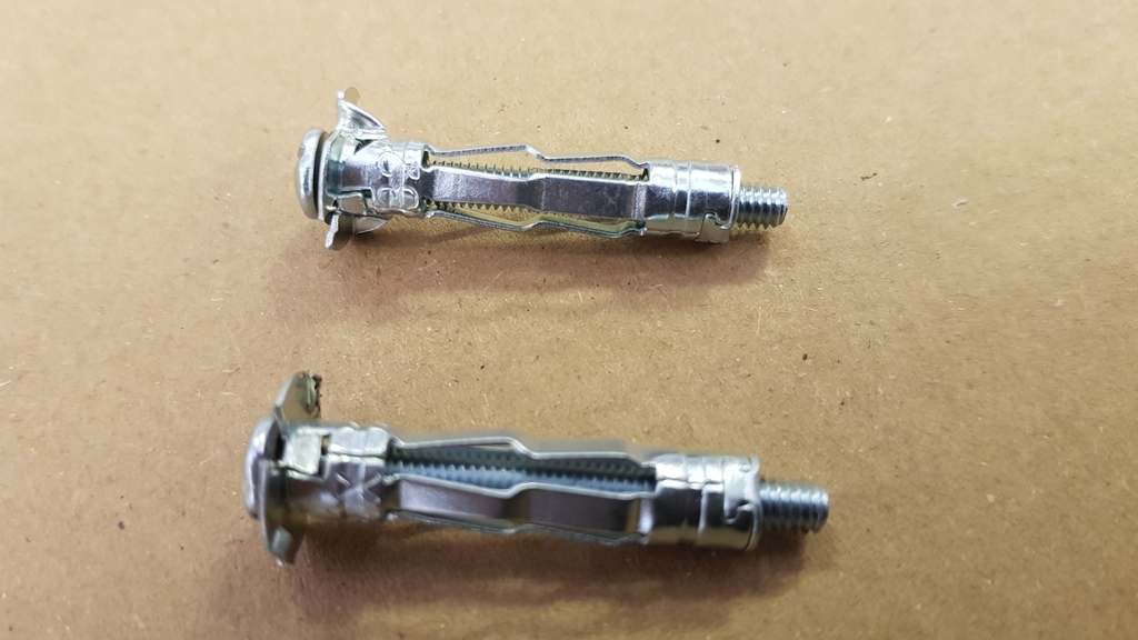

Back to the spoiler,
The end fittings are shot, so I fitted a couple of cavity anchors (M5 x 37) with a setting tool, but bent
back (pliers) the anti-rotation wings first, so as not to puncture in new holes.
Reason for using these instead of adhesives is, the rim of the spoiler is cracking, and is quite flexible,
another reason for not using a flanged rivet nut.
Now the holding strength is spread over a wider area inside,
a bit of grease on the threads and removal should not be too bad.

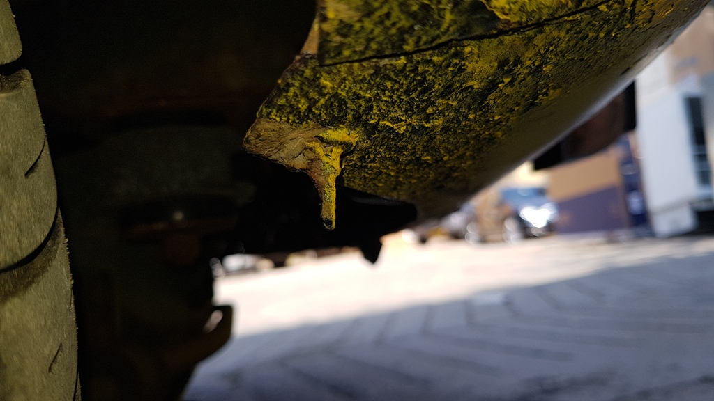

Whoever fixed this last time only succeeded in making a bolt/glue stalactitie.

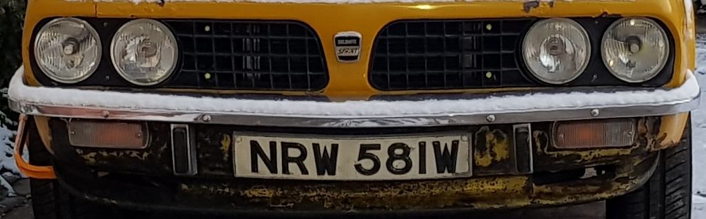

Spoiler and bumper finally back on,
The before shot was done during the snow, it had all got a bit more flakey recently,
it's not perfect, but a lot better than before :lol:
