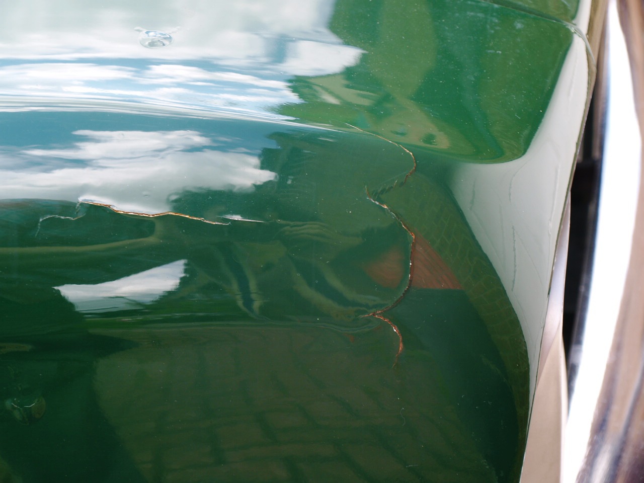

Cheers Stan, here are some pictographs of the motor enjoy the artistic portrayal of the 'rusty crack' on the wing.

No rattling yet, although I could just be pretending she doesn't rattle. Has anyone got any advice for the rust on the wing, I'm planning on just sanding it all down treating the rust before patching it up and priming and painting. But any advice or tips would be warmly recieved.

Nobleox_Toledo wrote:No rattling yet, although I could just be pretending she doesn't rattle. Has anyone got any advice for the rust on the wing, I'm planning on just sanding it all down treating the rust before patching it up and priming and painting. But any advice or tips would be warmly recieved.

Sorry to say that crack on the front wing looks like a big slug of filler lifting itself out of an historic dent.
Dig it out, de rust beneath with jenolite and refil is the sensible answer, or I could do you a nice new grp wing for £90
