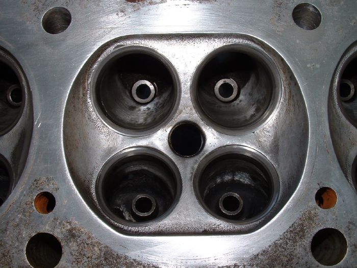

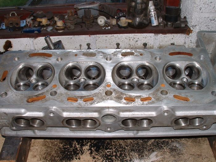

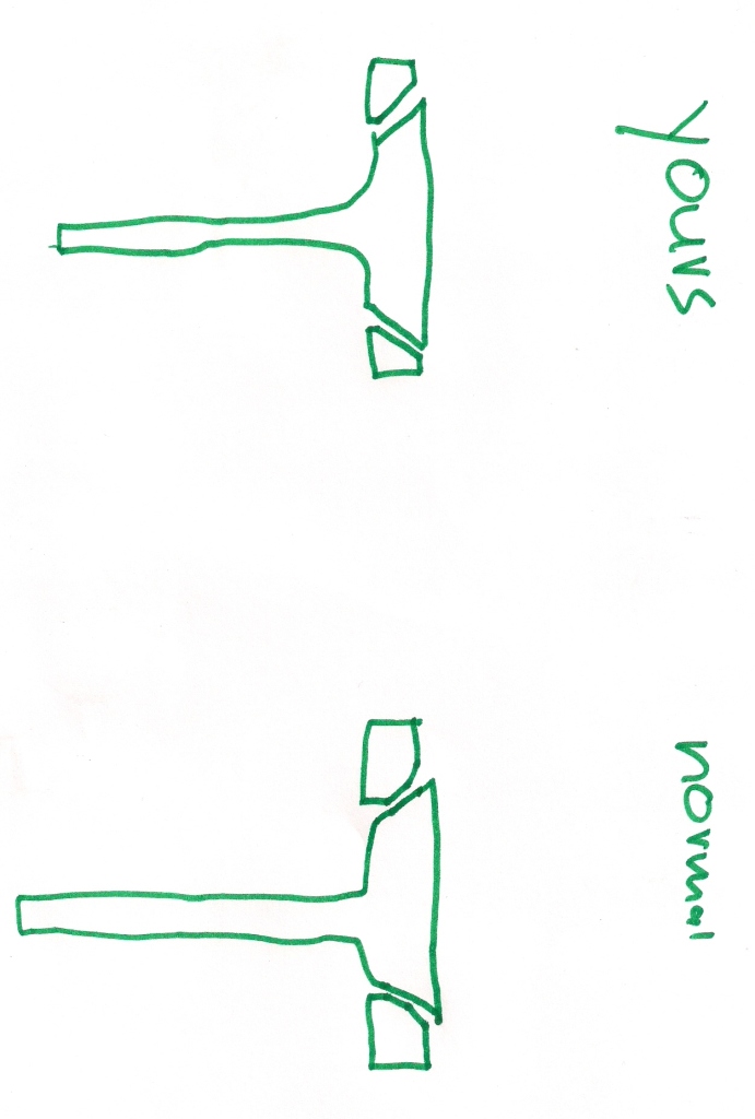

#32 Post by soe8m »
Are you sure about the valveseats? They look they have way too much valve contact.

soe8m wrote:Are you sure about the valveseats? They look they have way too much valve contact.
Can you explain further Jeroen?

DF
Re: Track Sprint Resto
#36 Post by DF »
Im sure he means the seats haven't been trimmed back for better flow
They do seem quite large for a performance engine,
Some people get 3 angle valve seats cut and u usually end up with
About 1mm valve to seat contact slightly more on the exhaust as it helps cooling of the
Valve, inlets are cooled by the fuel
Hope this is what he means

I see. I do go a bit mad with lapping the valves in.

#39 Post by soe8m »
Hello Mart,
Double springs are not needed for a sprint, not even with a high lift cam. Std springs do fine and do less stress the lobes and the chain.
Darren did explain what i did mean. For my new LPG project i did some calculations what the most ideal seat/valve contact was because the LPG has a higher temp combustion and the valves have to have more contact area because of the cooling.
For LPG my sprint has 2mm contact for the exhaust and 1,5mm for the inlet. Too less will burn the valve but does have a good sealing. Too much will cool very good but the pressure per square mm is less so will seal less, contaminate more and will burn also the valve. This is in your case and i think it will not last very long.
For a normal petrol sprint the inlet has to be 1mm and the exhaust 1,5mm. This is the most ideal. You only will get this by 3 angle cutting. You have one steep angle behind the valve and a low angle in the combustion chamber side. By controlled machining you can machine these two angles till you have reached the desired contact angle. The other thing is you will also have a better flow. But this is not why you have to choose for 3 angle cutting. The main reason is there's no other way to create a desired contact area.

#40 Post by Mad Mart »
Thanks Darren, I decided not to use the new springs or my uprated ones.
Thanks Jeroen, I knew about the 3 angled valve seats. Bodgerben gave me all the info I needed a while back. But it looks like I've gone too far with my valve lapping. I have some new seats and valve guides so I may take the head to my local machine shop to get it sorted.

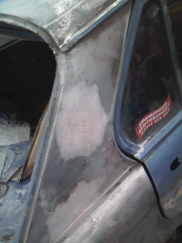

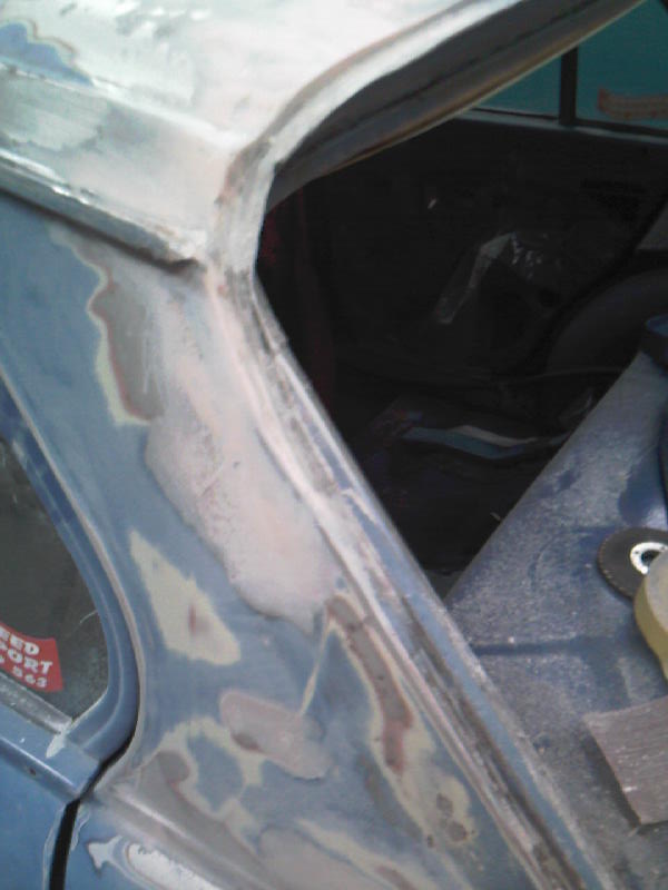

On the way back I popped into the body shop to drop some trim off to Jon. Took a couple of pics with my mobly whilst I was there.

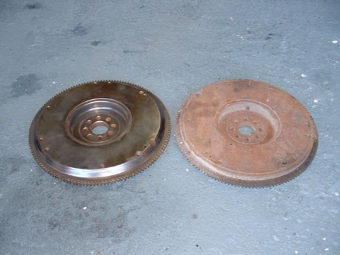

I spent a bit of time this morning cleaning up the block & running a tap down some of the threads. I also cleaned up the lightened flywheel I bought from Alun a couple of years ago. It came up quite nice. :D It's not been lightened too much. Std flywheel weighs 9.6 kgs whereas my lightened one weighs 7.8 kgs.
You can see on the front that just a large chamfer has been removed around the edge...
...and on the rear a large scallop has been removed from the middle...
Looking at the old flywheel on the right I noticed that there is no wear on the front face where the friction plate bites, so I wonder if it's a new one or has been faced off?
I need to remove the pins that locate the clutch plate from another flywheel to transfer to the lightened one, I tried a bit of heat & some pliers but I just started to damage the pin. Anyone removed these before?
DF
#43 Post by DF »
Heat wd40 and some mole grips
That's what worked for me
Or pilot hole behind And knock them out .???

#44 Post by Mad Mart »
No luck with that Darren.
I picked my head up from the machine shop yesterday. Looks very nice. :lol:
Thanks for pointing it out Jeroen else I would have just put it back together as was.

On your head i see some skimming possibilities for more compressio ratio and more power. The seats look ok. :D
